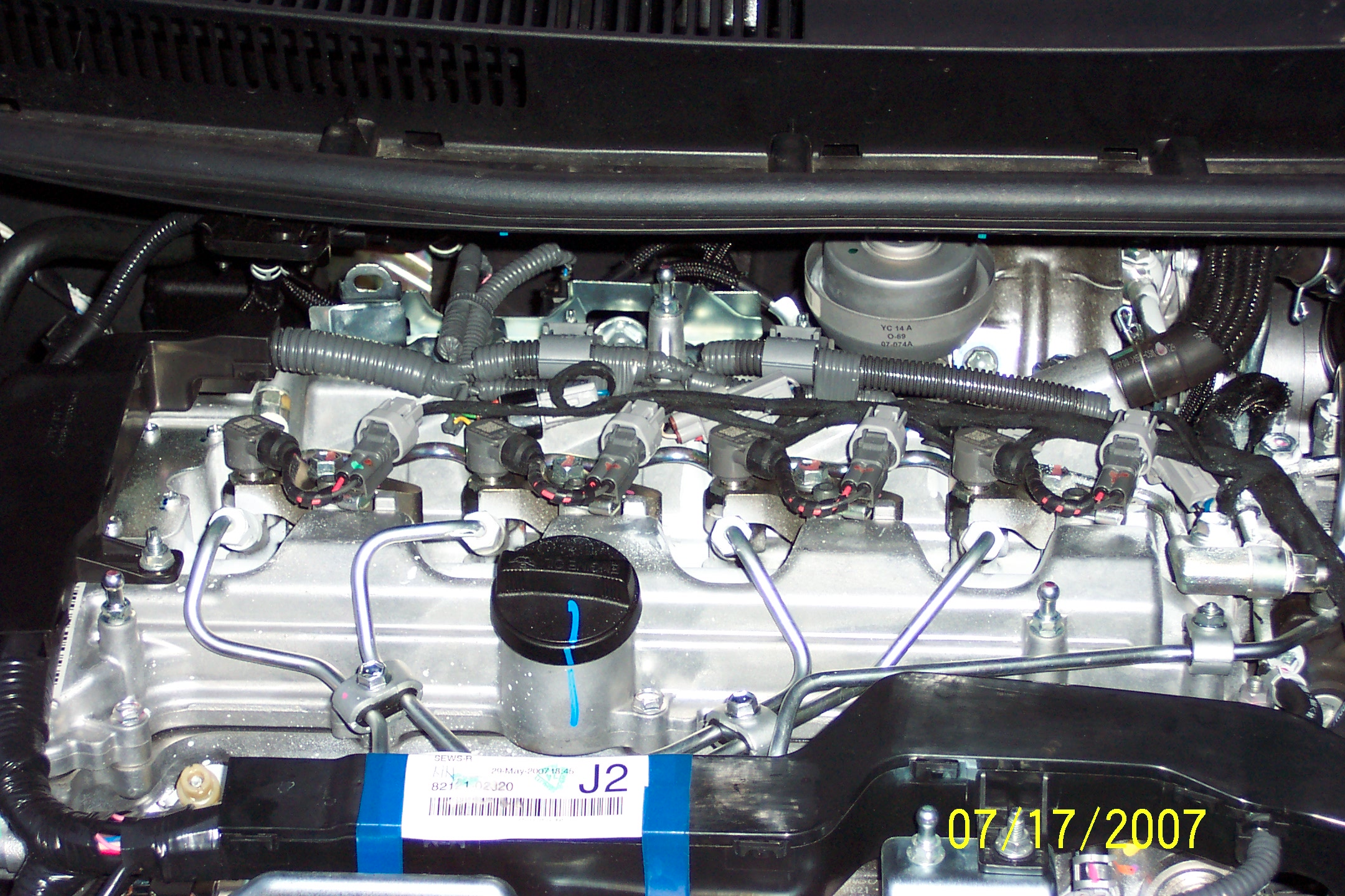

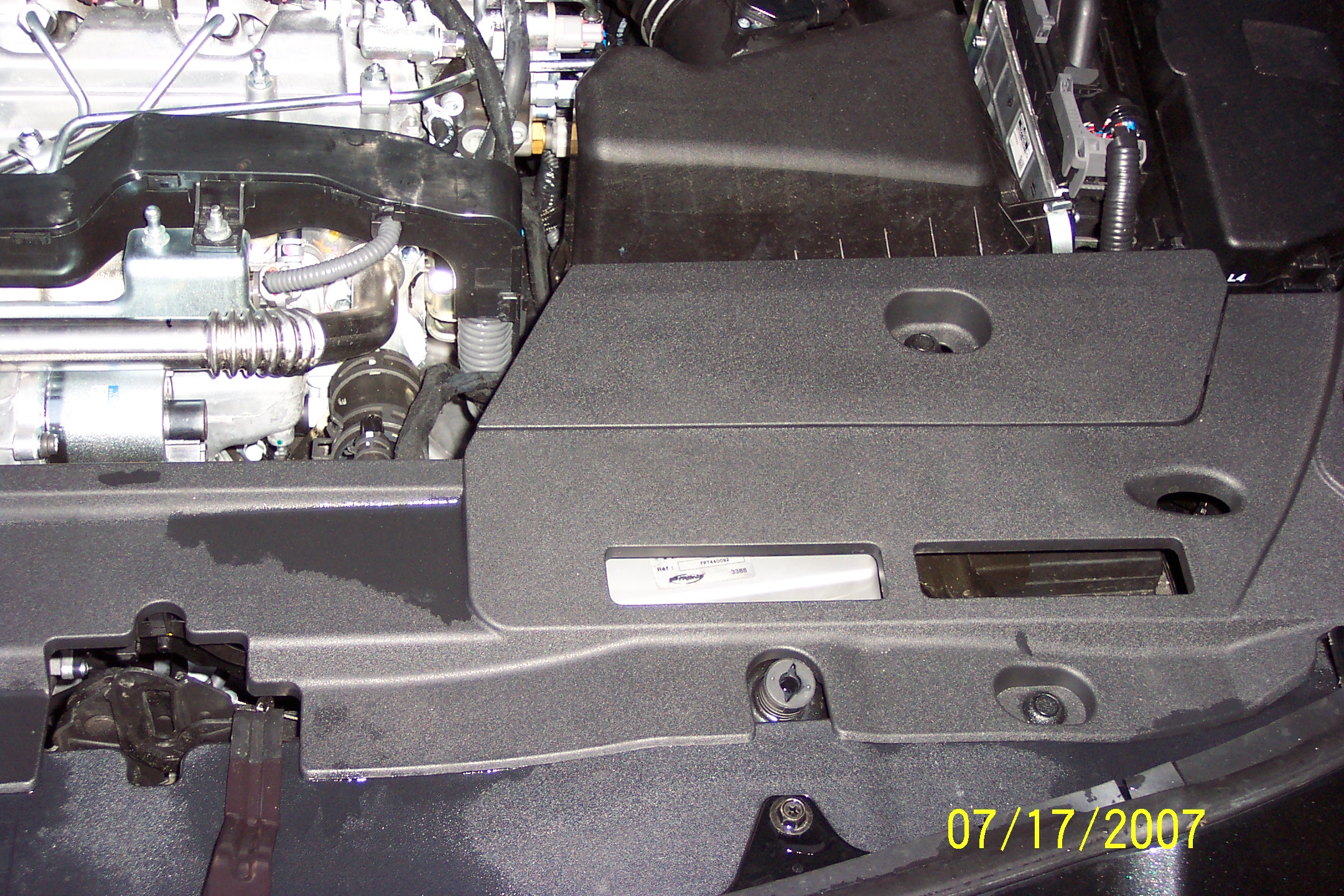

Some pictures of they mounted Ptronic powerbox.
You will see that is added between the orginal wiring of the injectors & i mounetd the powerbox on the Battery.
You will see that is added between the orginal wiring of the injectors & i mounetd the powerbox on the battery.
Could you clarify the pictures a bit ? Not sure where to look for the box really :)
Was also wondering if there is *any* risk of damage to the engine by chipping it ?
No prob mate.
Sorry for late reaction, but just back from vacation.
The first picture shows that you ONLY have to replug they injector connectors into they powerbox cable.
The second picture shows you a glimp of the powerbox mounted on top of the Battery. Most part of the powerbox is hidden under the Battery coverplate.
