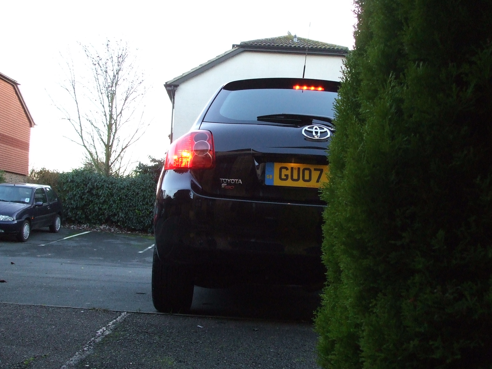

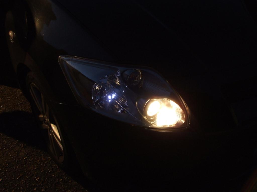

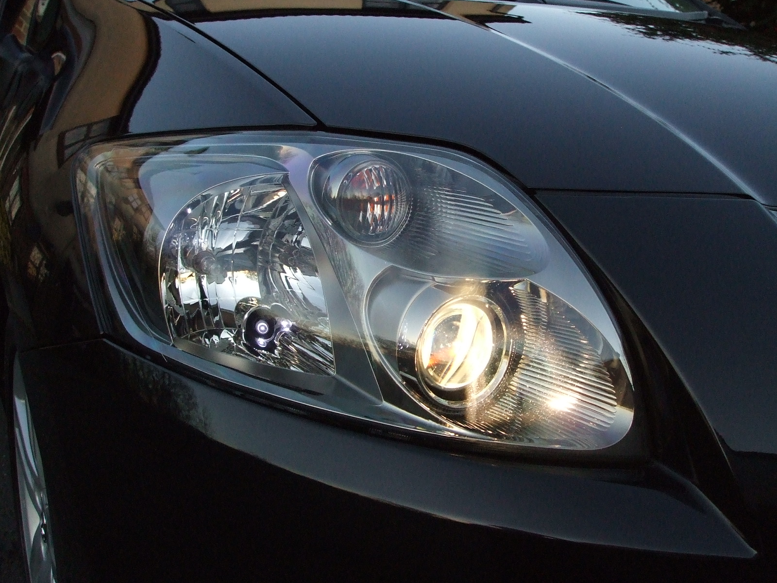

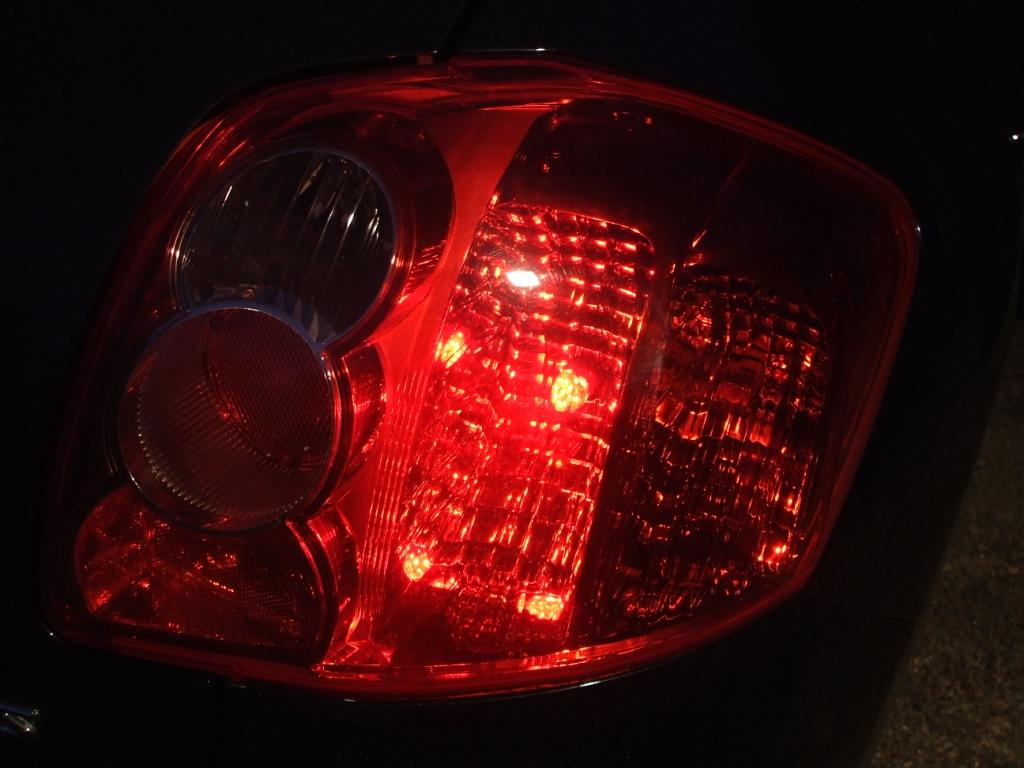

Front cluster with ultra white LED. Now i have to upgrade the main dip beam, as the mixture of normal yellow with this white/blue looks a little odd i think. Any good suggestions for a white looking halogen? I don't fancy going the xenon conversion

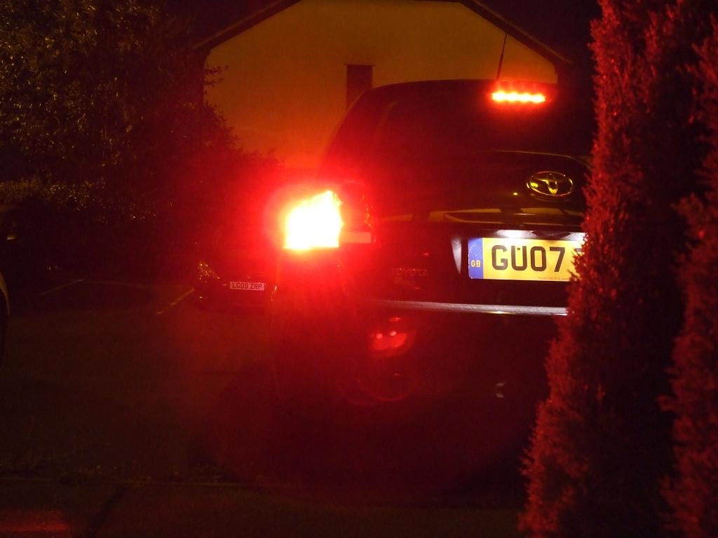

This one is with both tail and brake lights on... ITs slightly long exposure and looks VERY bright on the picture... And it is very bright in real life too. Maybe a little too bright?

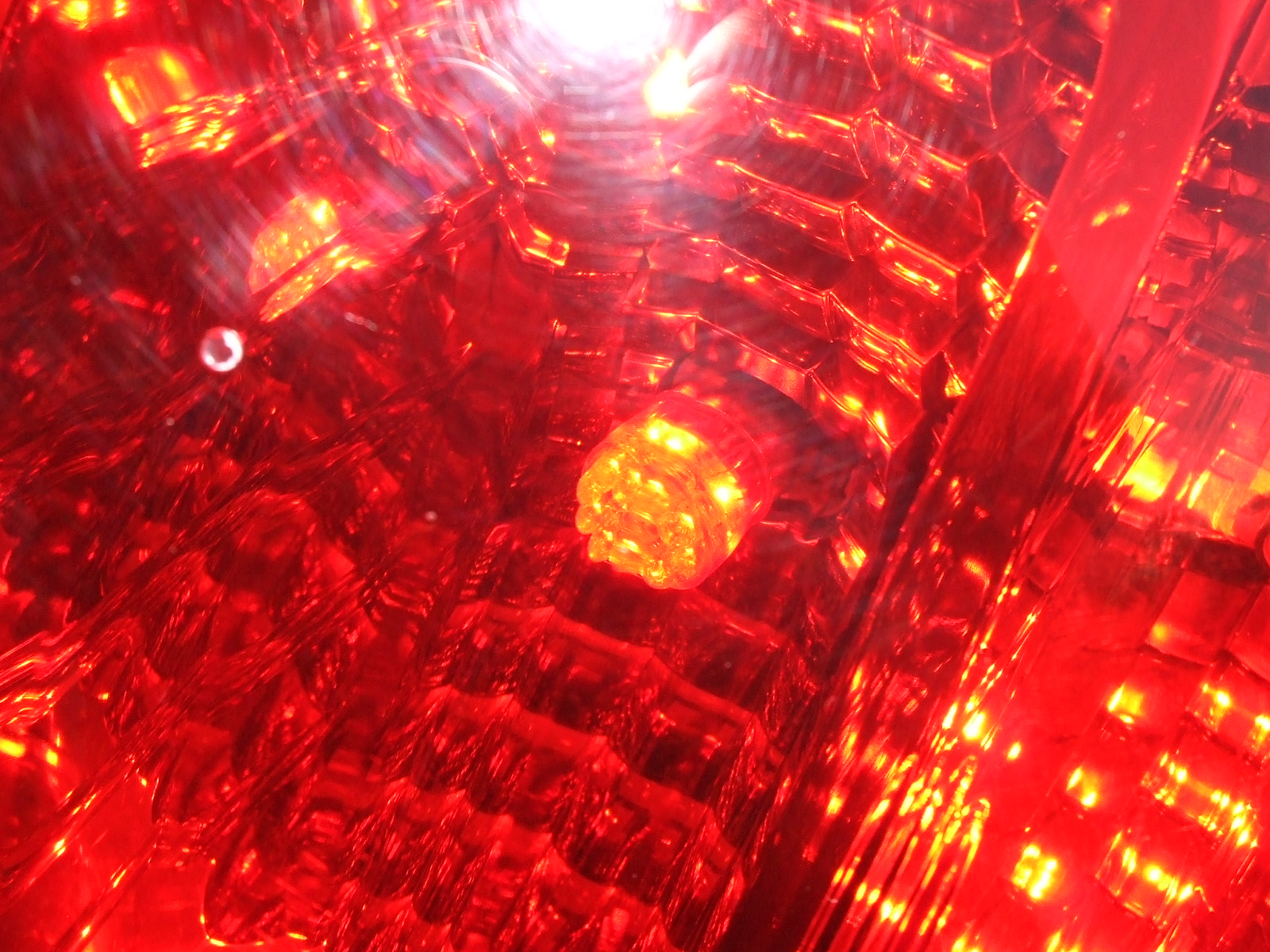

This is a close up if just the tail light on... Definitely brighter than normal filament.

Hmm... Maybe you can put put LED into one side and stock bulb into the other side of the brake lights and take a picture to see the difference more clearly? Because in the second picture, brake light seems very, very bright. So bright that it might be bad for the drivers behind you at night. I'm not sure though, from the picture it looks like a gigantic rear fog light. :mellow:
However tail light seems pretty good. :)
Yeah, it does look bad on the picture because i did a night shot which is a long-ish exposure on the lens of the camera. The light looks saturated and flooded, but in real life there are just 2 VERY prominent red dots where the LEDs are. But yes it may still be too bright for the car behind me, so i am going to ask a mate to follow me tomorrow and give an honest opinion...
I think when i change the indicators to LED and the dip beam to white halogen, i will be happy. :thumbsup:

Tail light (Not brake light) - Installed a pair of 9xLED (type 207) bulb
Stop light (Brake light) - Installed a pair of Ultra II SMD LED red (type T10/501) bulb which is very very bright.
Front side light - Installed a pair of wide angle white xenon colour LED (type 501) bulb
Basically my back clusters involving red colour lights are all LED and my front side light is LED. My dip light is using a pair of Osram Night Breaker which makes a hugh difference.
I didn't go with LED for indicator in the end because it requires a resistor kit and didn't fancy doing this as its just hassle, it is necessary because it draws so little current that the car thinks the indicator doesnt work and blinks quickly to let you know there is a fault. Thats where the resistor kit comes in. But if you are interested it is this kind that you need:
TYPE 207 (for real cluster)

Hi Alex,
What i ended up doing is the following:
I am glad i did it because it stands out and it just looks cool :)
That's cool man, nice mod! I saw the pics you posted before, but do you have or can you make some new ones, especially some photos taken during daylight, I think they will give better idea than the night shots about how the lights look like...
Also the front side light would be nice to see!
Best regards, Alex
Alex,
Sort of day time and am not too sure that it is different to the ones previously. Anyway hope this shows what you want to see.
Best regards, Alex
