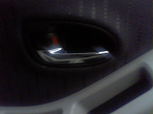

The equivalent of your lock button in mine is the red lock rocker built into the handle. See pic (I photo'd the passenger side because the light was better but it's the same on the driver's side):
This does NOT lock all my doors, only locks the door it is built into.

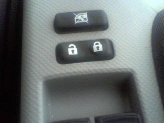

Like you say, if I press the switch with the padlock icon on it then everything locks:
So, if the dealer was describing my car then what he's saying would be correct.
Can't say for sure on a 54 reg but sounds like there's a possibility he's telling it like it is.

it will not lock any other door apart from that door, thats y theres a master lock switch next to the window switches. that catch lock only has a metal wire going to the doors main lock to keep it locked other people caqn still get out of other doors.
