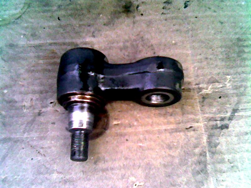

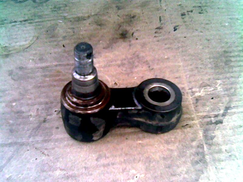

I started getting this scraping sound on the front left wheel everytime the road was uneven. Took it to my mechanic and he identified the problem as the attached part being worn/dry. He greased it and put it back as a temporary measure but told me I need to replace it. Problem is I don't know what the part is or it's reference number.

I'm not sure, but it looks like the front suspension camber control arm as found on Celica's with superstrut suspension.
figure of 8 . you really need to change it with camber control arm 1 , otherwise the knock will return in a week or 2 , and you have to pay the labour charge again .
fig 8 is about £100 nowadays , camber control arm 1 is £306 .
oil or grease will make it worse or may even cause the ball joint to pop out - bad error by that mechanic. IMHO.
chances are its the small ball joint on the end of camber arm 1 where it meets the steering control joint near the hub making the noises.

schematic is in my head , never seen a gen 7 use this part , but its a figure of 8 link arm .

I did some research and found that it's also known as the "Lower Camber Control Link". According to wikipedia, there was a JDM gen 7 model available with super strut suspension as Hawke56 mentioned before.

if this is so the same part will be on the gen 6 . figure of 8 link arm.
