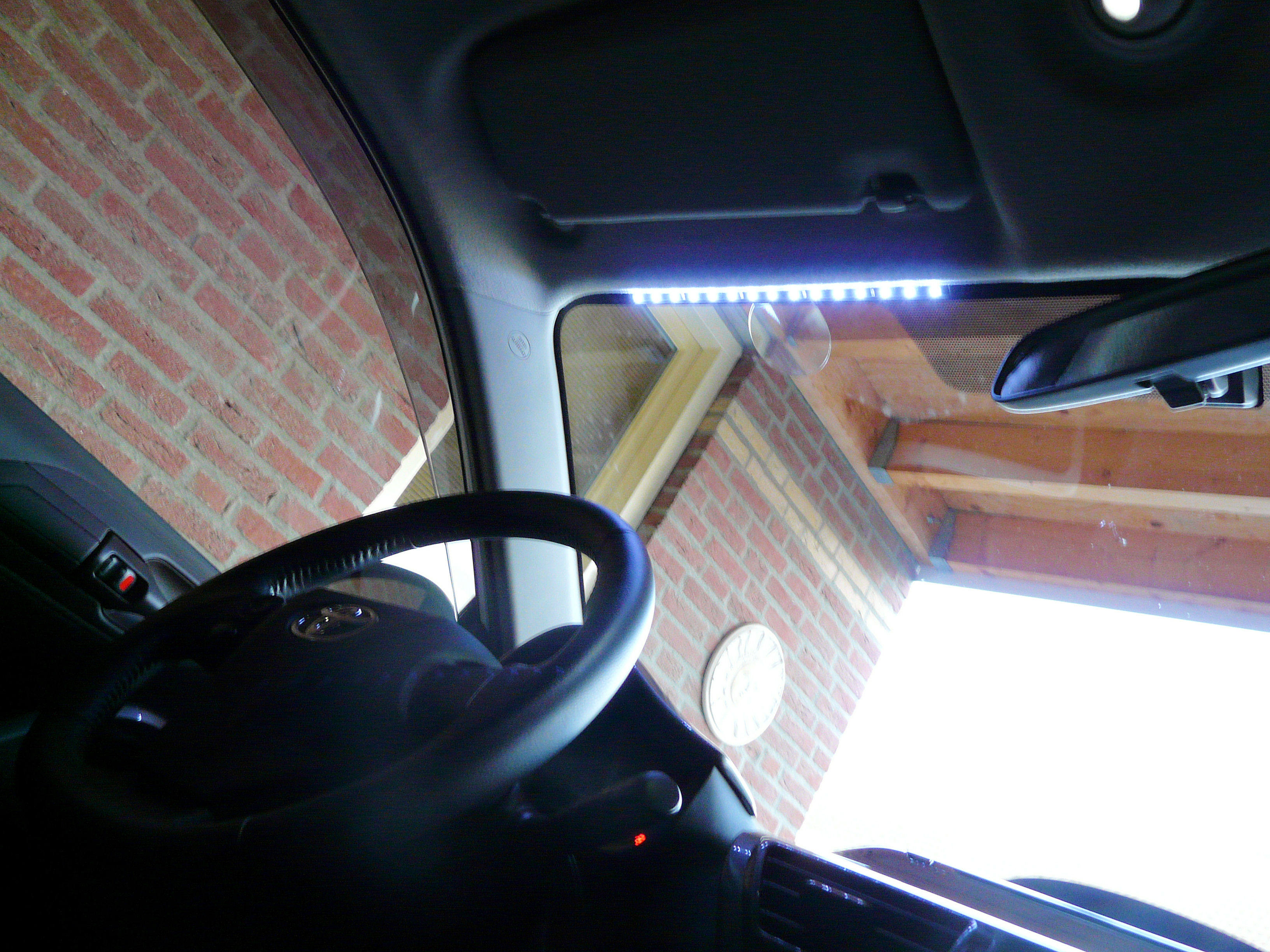

a closer look

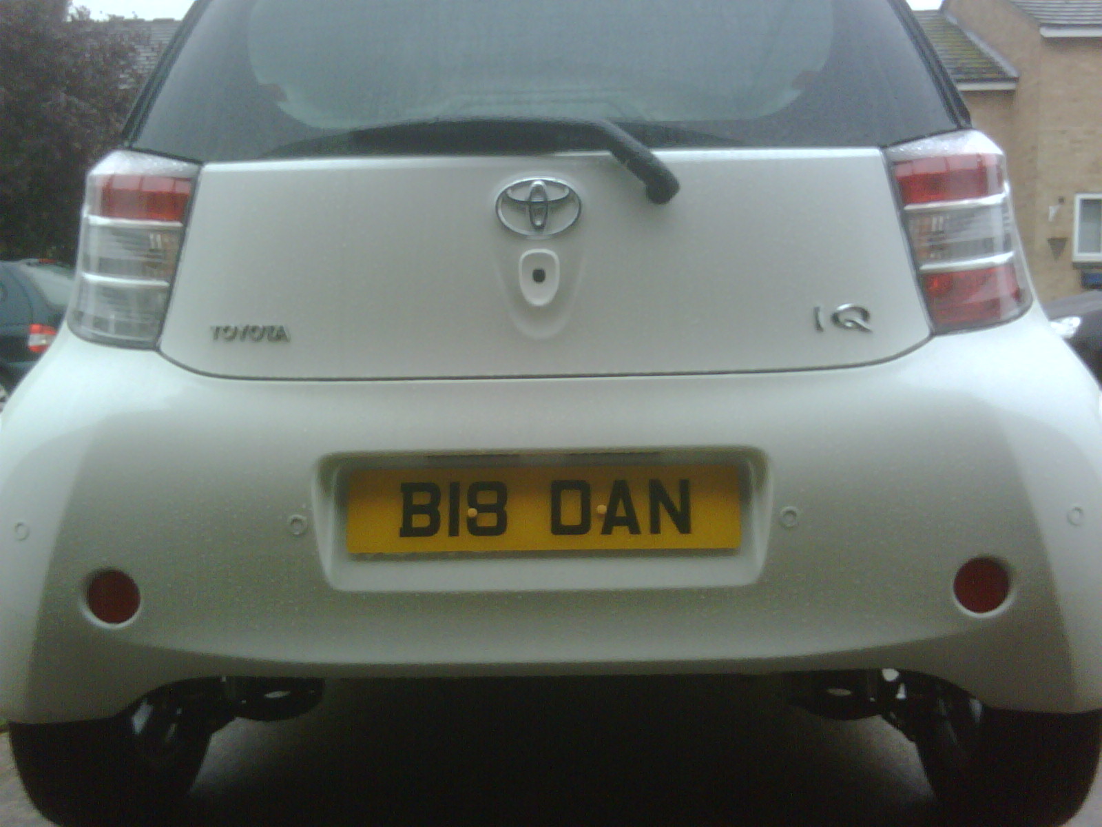

liking your iQ, some really nice touches on there. Plates were only £450, a really good price i thought?

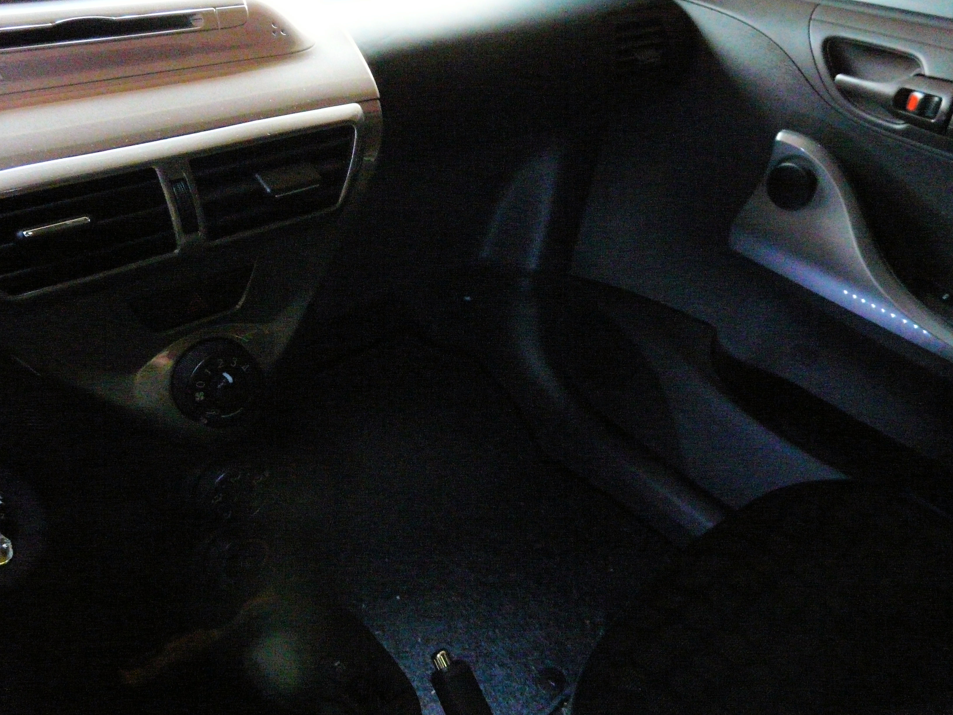

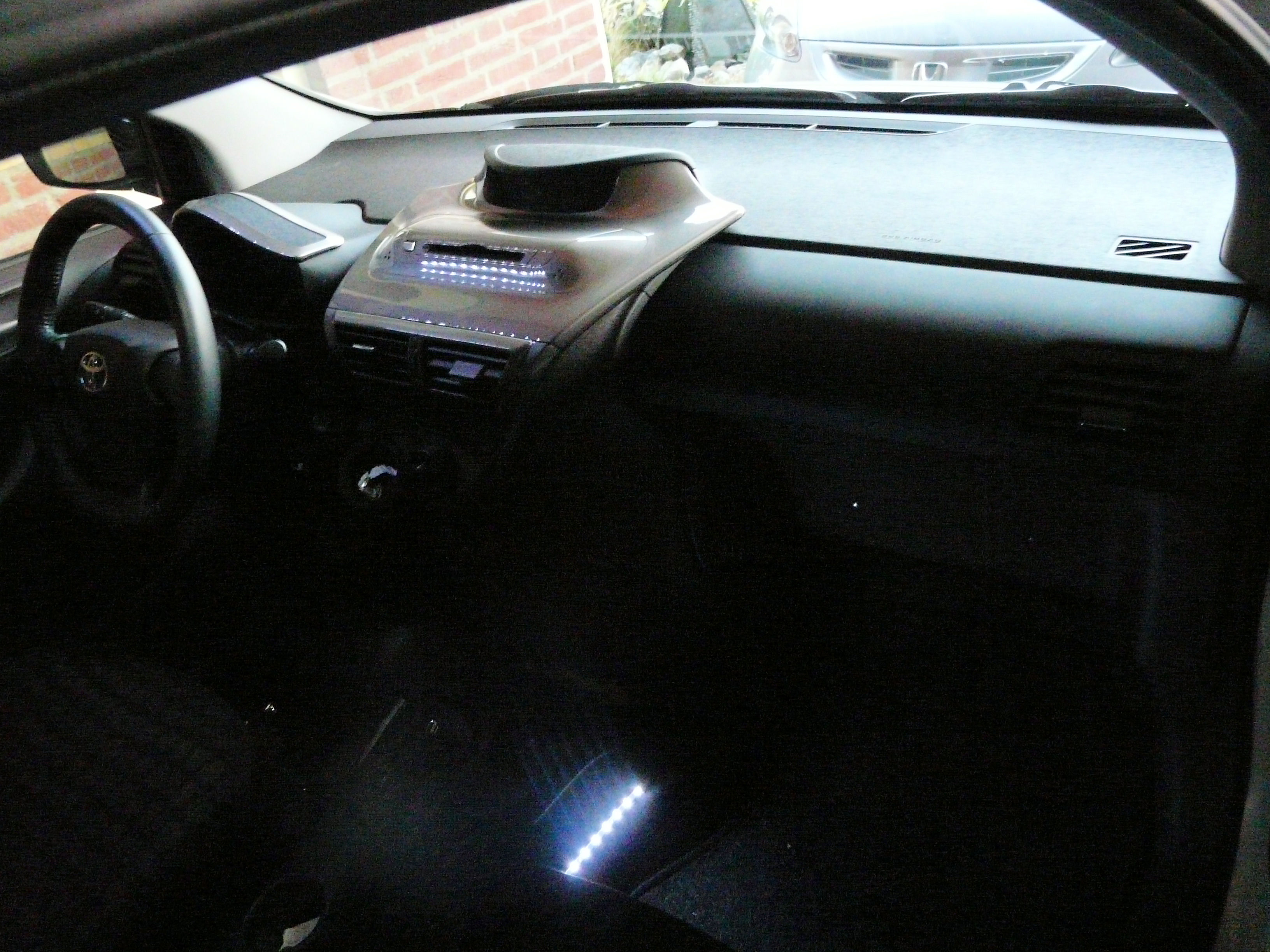

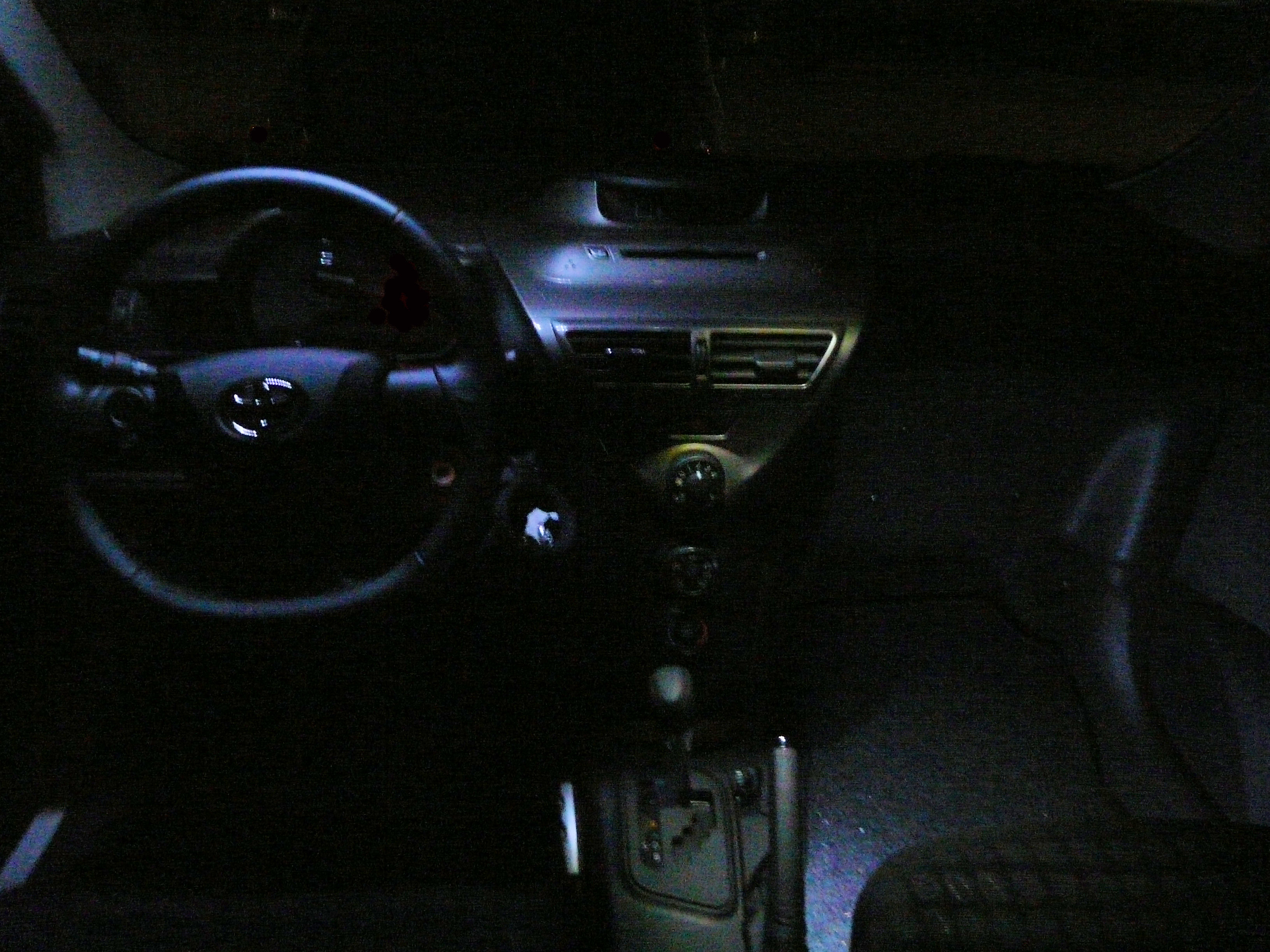

My ambient led-light driverside and footlight passenger side. Lights turn on by opening car with the key or by opening a door. Driver doesn't look into the leds but dashboard lights up so sweet!

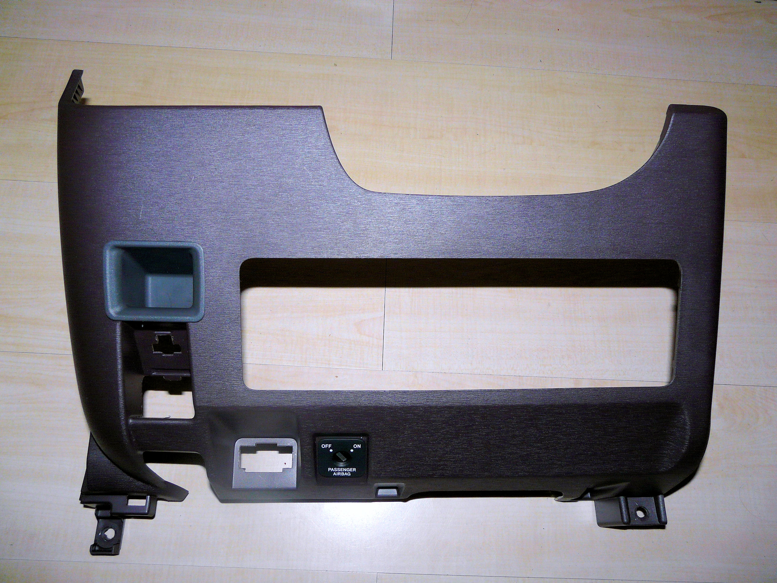

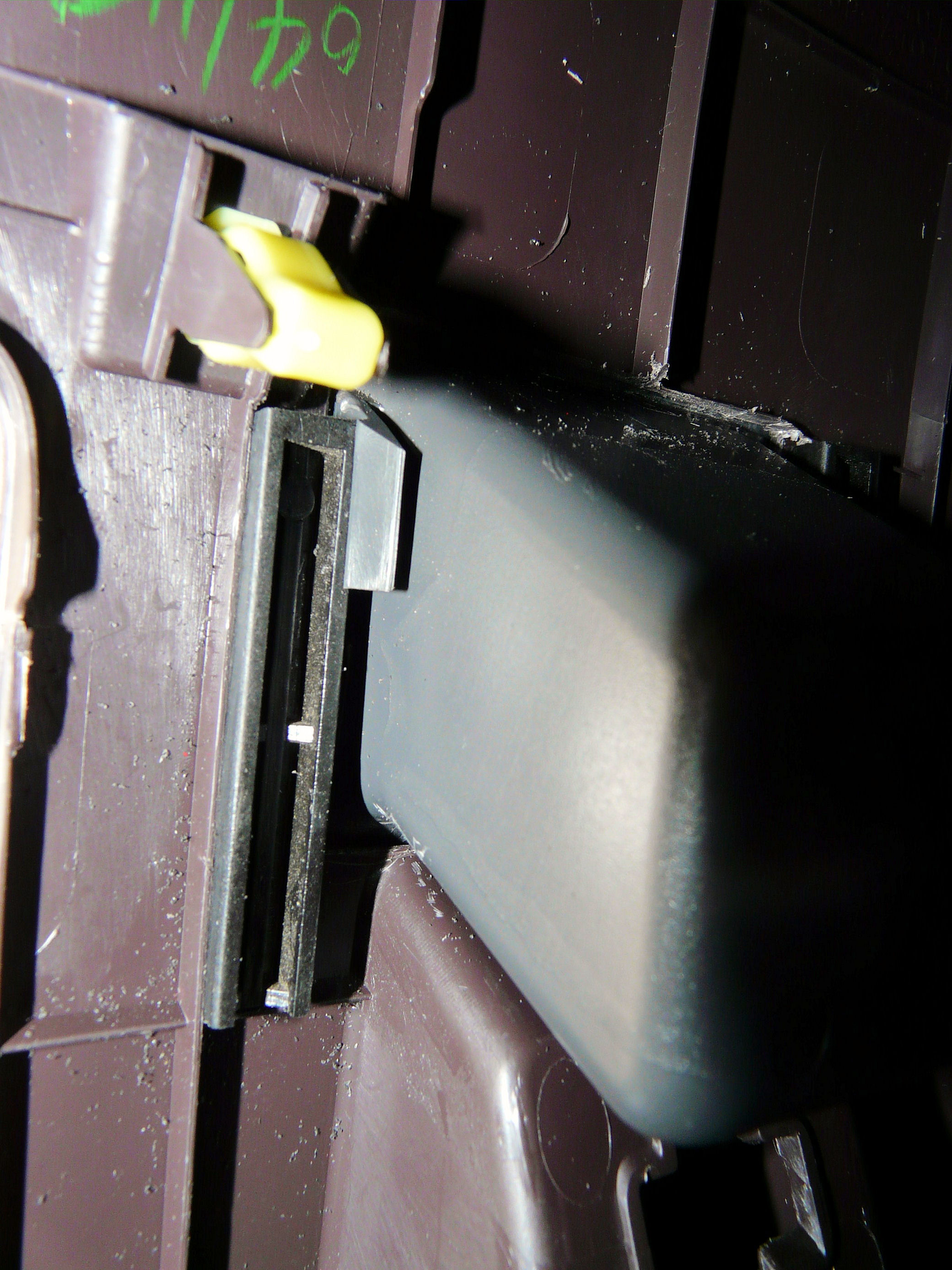

And a little extra storage compartment. It's build in the panel next to the knee-airbag.
The backside (home made reinforcement bars)

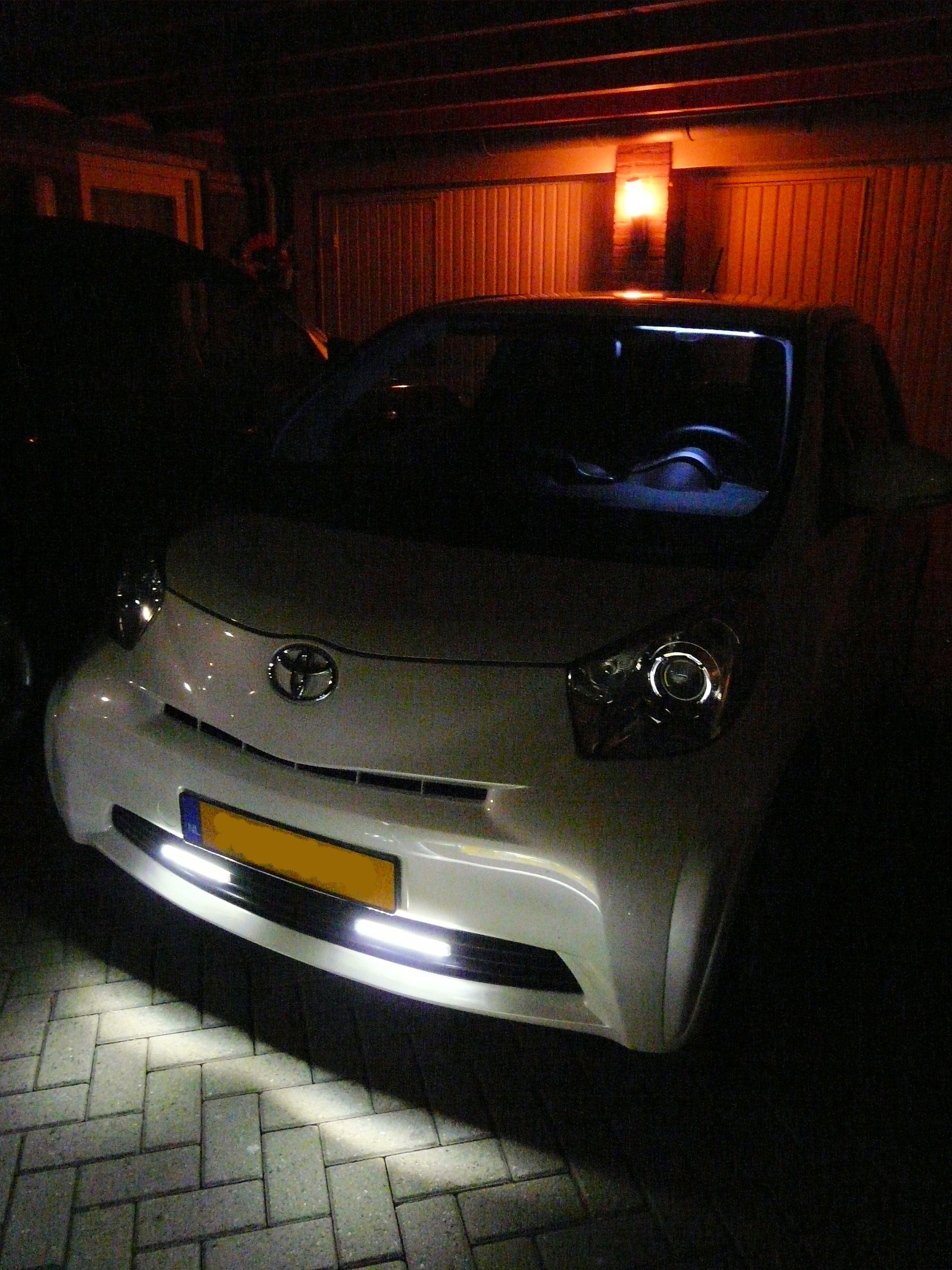

Leds by night.
Let led rule !!!!!!!!!!!

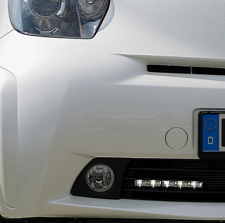

Nice picture La-La, are that the lights from Hella?
Ruud
@Ruud

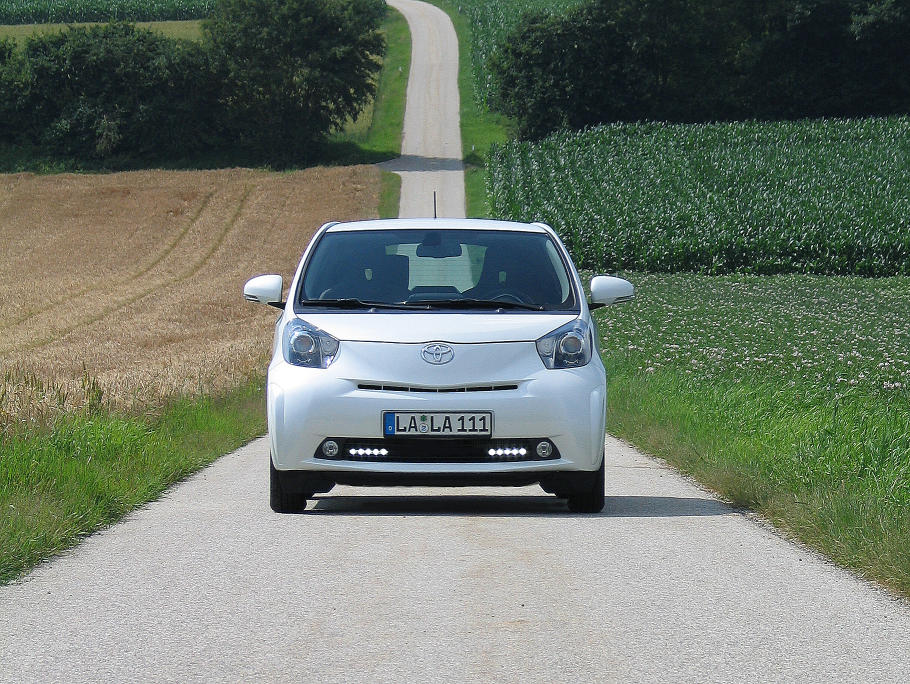

My Daytime running light in LED-technology is made/distributed by in.pro. (www.in-pro.de).
The part-number is 43729 (Tagfahrleuchten-Set LED univ.) ECE certified and approved. Important for Germany: no TÜV certification required.
Installation dimensions (mm) H23 x W205 x D 60 (squared)
The unit: 2 bars with 5 LED each and the cable set.
Greetings from the south of Germany
