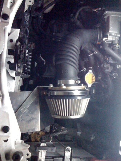

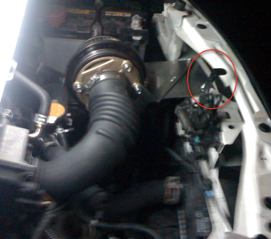

pictures as requested
It looks quite neat. Seems alot of money for what you get though.
I made a replacement airbox for the Aygo out of pre-pregnated carbon cloth, formed over a mould and baked in a vacumm bag in a oven. It worked really well and looked cool. I plan to do something similar with my IQ. There are some pics in the Aygo forum of the other one.
I have made a mould for some mirror covers. When I get time I will make some carbon covers. I am also trying to get hold of a s/h bonnet, so that I can mould a carbon copy with a air scoop in for the new airbox design.
only problem is if u look at the heat deflector its deflecting all the cold air away from the cone and there is no cold air from anywher...sigh im gonna have to do something...
I can see what you mean about the air feed. I take it you are planning to add some sort of ducting to direct air at the filter. But that is not always a good thing.
Blitz would have done a fair amount of development probably including dyno/ road testing. Most people assume like yourself ( no offense meant )that if you duct air directly into or onto the filter you get better airflow, which increases performance.
However if you get the wrong kind of air ie: turbulant air from a ducted source, it can have a negative effect. If like the Blitz design, you place the filter in an area of stiller dense air ( which is oxygen rich ), you get better a air/fuel mix which will give a better burn.
I discovered this when I designed my carbon airbox convertion for the Aygo. Rather than ductin air from the front grill, I placed the inlet behind the leading edge of the bonnet where it meet the top of the front bumper. This air is much more dense, but less turbulant. It was a massive improvement over my previous attempt that used a direct feed.
Does the filter have an internal ram pipe/ rolled bellmouth. If it does a direct feed may help. But if not leave it as it is.

the k&n induction tends to hang a lot lower than the blitz one i think after looking at no-_data's pictures that its as low as the original airbox..
