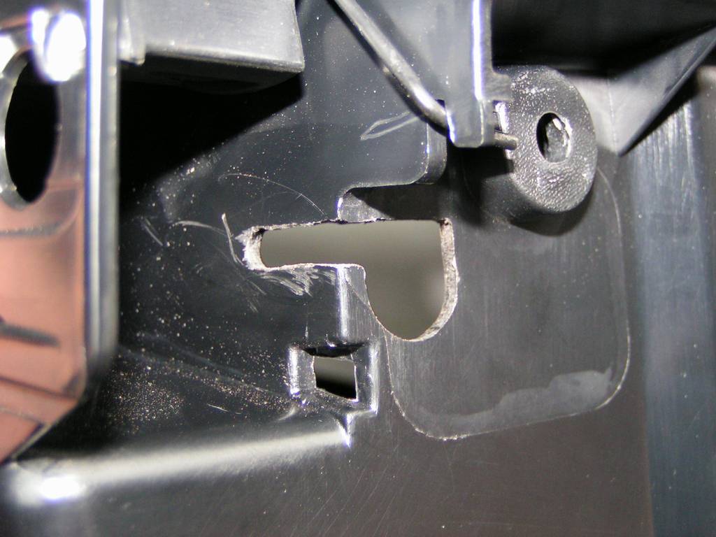

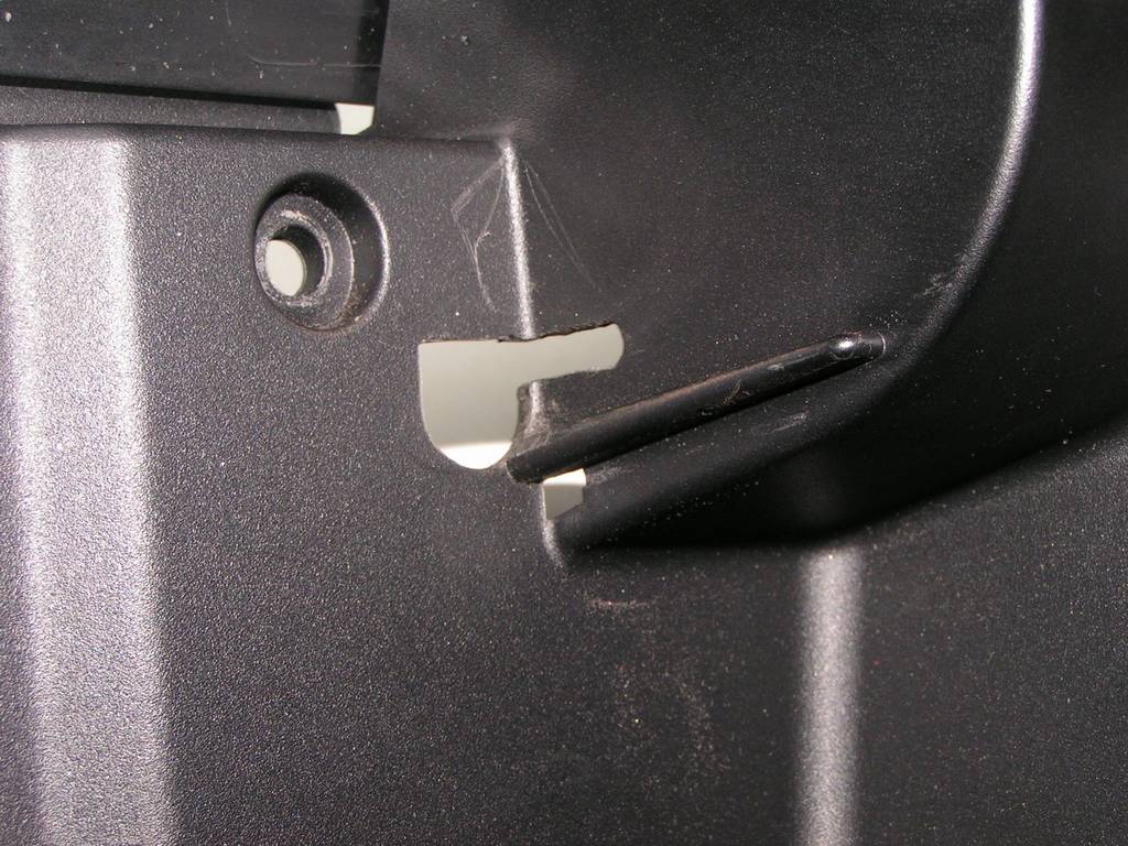

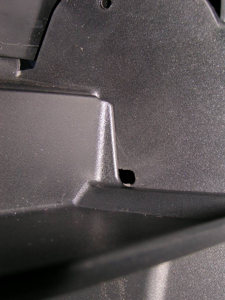

I went for the xcarlink box and the hardest part of fitting was pulling out the upper glovebox for cutting access for the cable. The 1st hole was drilled tight in the corner of the removable shelf which was then pulled out to cut a hidden slot and a big hole for the plug. The shelf goes back in at an angle so the cable can be fitted and the shelf carefully shoved back in making a hole at the end of the slot. I didnt have any grommits which would have made a better job. I did the same for fitting an aux cable above the ipod cable but didnt take a photo, its the same process but just 10mm higher up!
Simon
