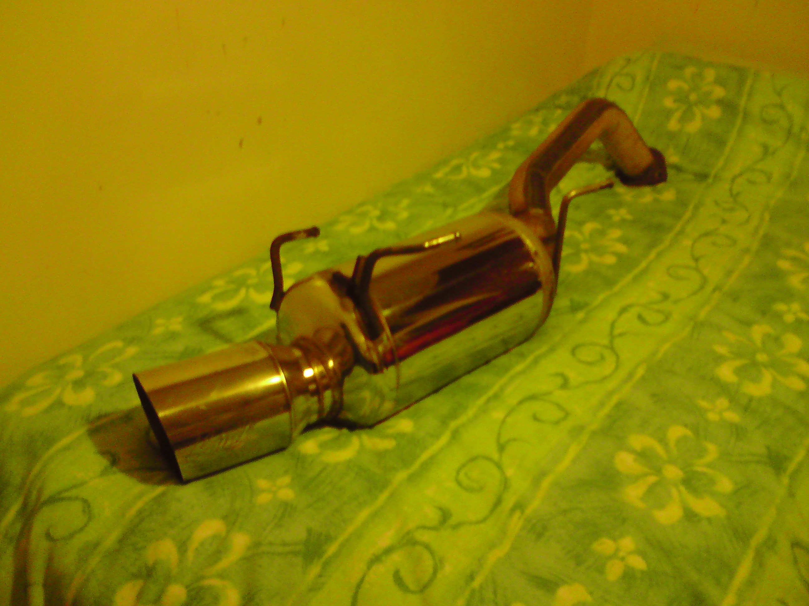

the car came with a rear section after market exhast the weld lines had better days but a specialist has doen a great job on it for 40 quid :P a slow start due to that but im goin to start getin bits in :P
Nice one get some pictures up when you start installing stuff.
right this is goin to be an on going build but i think i have got the ball rolling plus a sold my calibra so a few quid for parts :P
the car when i bought it came with a standerd rear section in the boot and a after market one in need of welding and was done by a specilast very good job too so now the bumper has been repaired and looking mint will update soon
