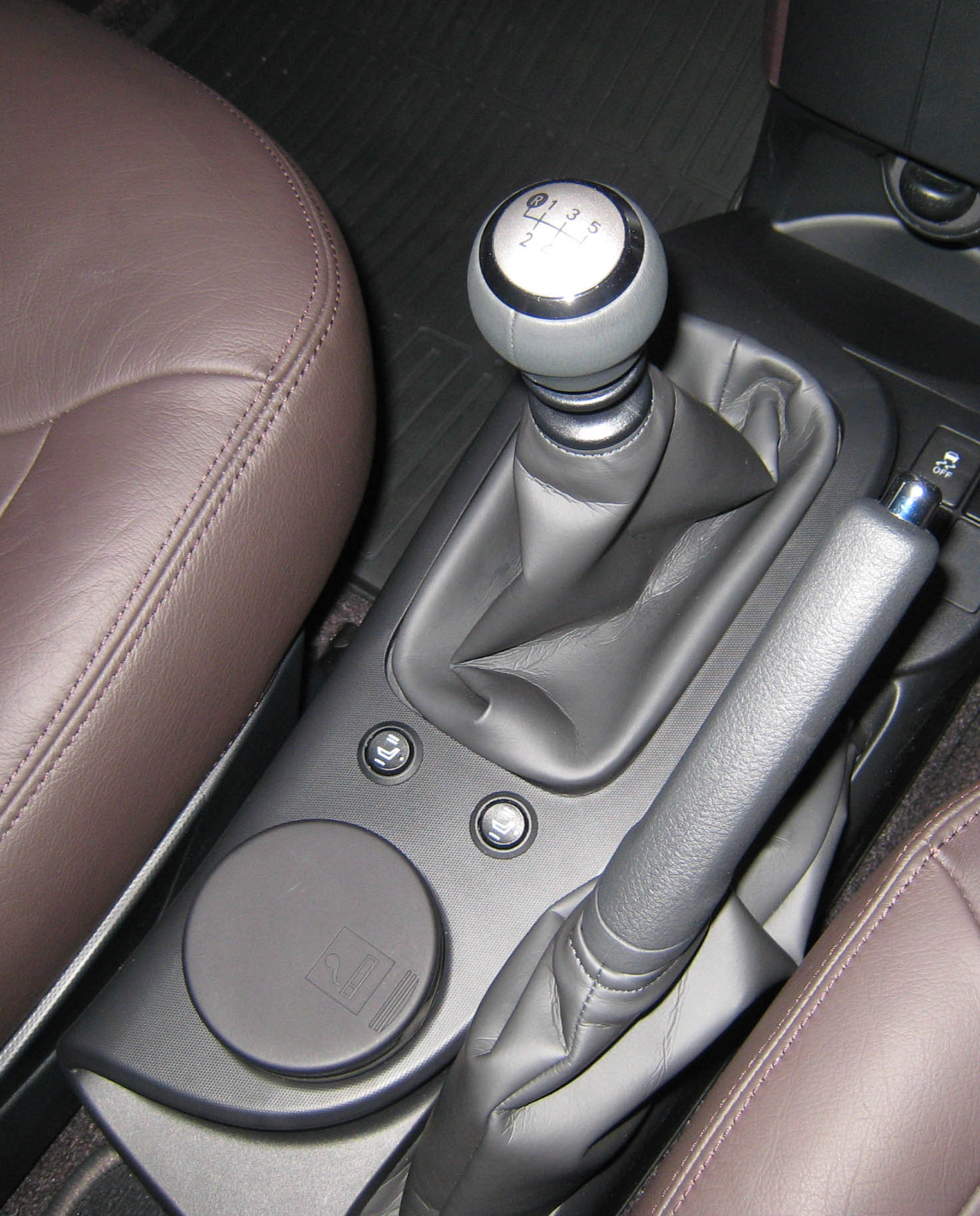

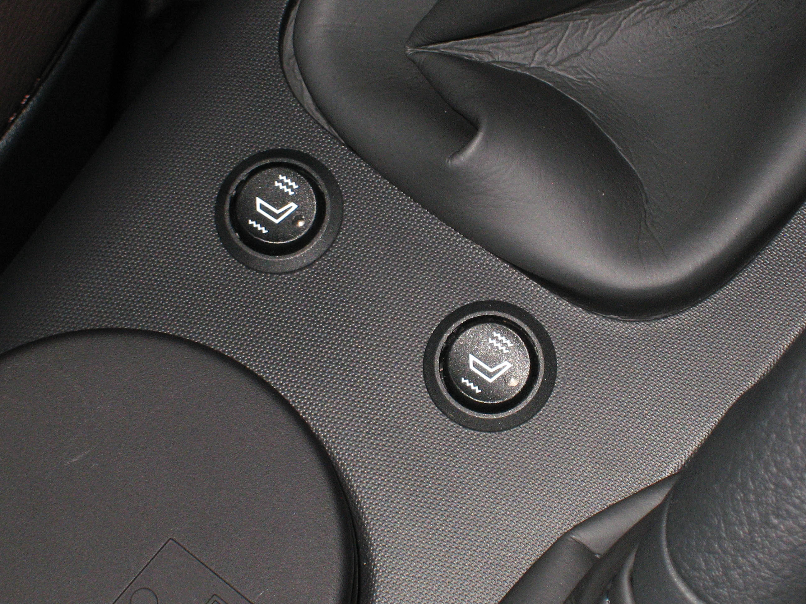

My iQ3 now has nice heated seats (2 settings) to keep my backside warm this winter ;) - very impressed with the whole job etc. The firm also does an amazing choice of far better quality leather coverings for the iQ - wish I'd know that first - most colours, different stitching etc!
The firm is Duncan Smith Automotive Ltd based in Stowmarket Suffolk (they do seem to work all over the place though!) Duncan Smith Automotive
Here are a couple of shots of the switches - if you don't have start/stop they fit the switches in the two blanks near the aux input!
Cheers
