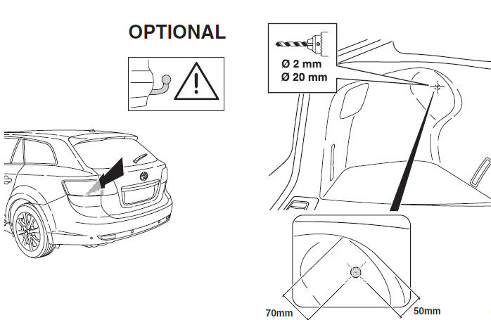

It should be ~ where the arrow points at in the attachment.
Can't be too far off, because the button's wire must reach the loom's z6 connector.
Thanks m8, i did find it on the left hand side under the rear after i lifted the hard floor for the spare wheel (toggle switch) now i have put the switch on i find it louder than before so i now going to mess with the toggle to see and listen if it can be turned down, going to let it stop raining first though.
