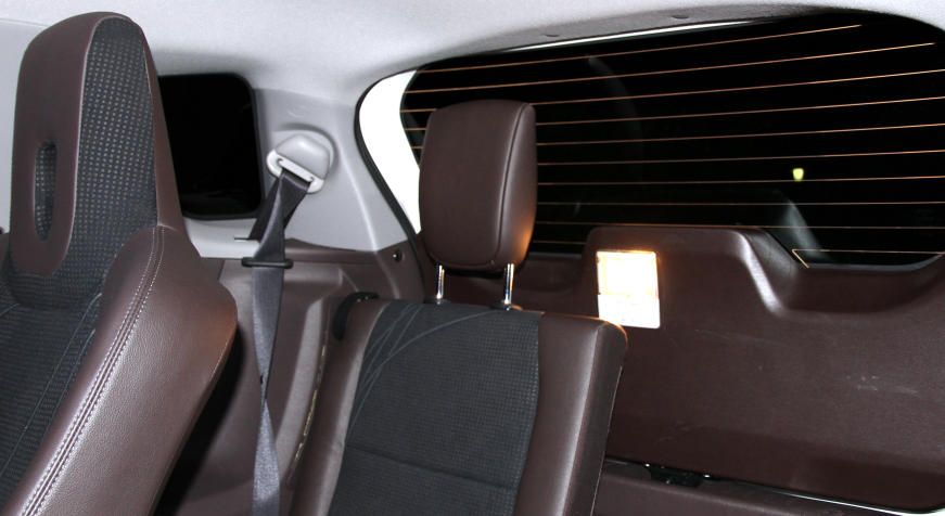

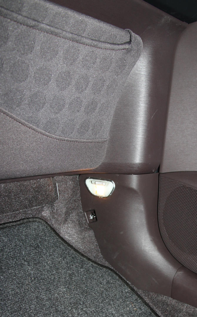

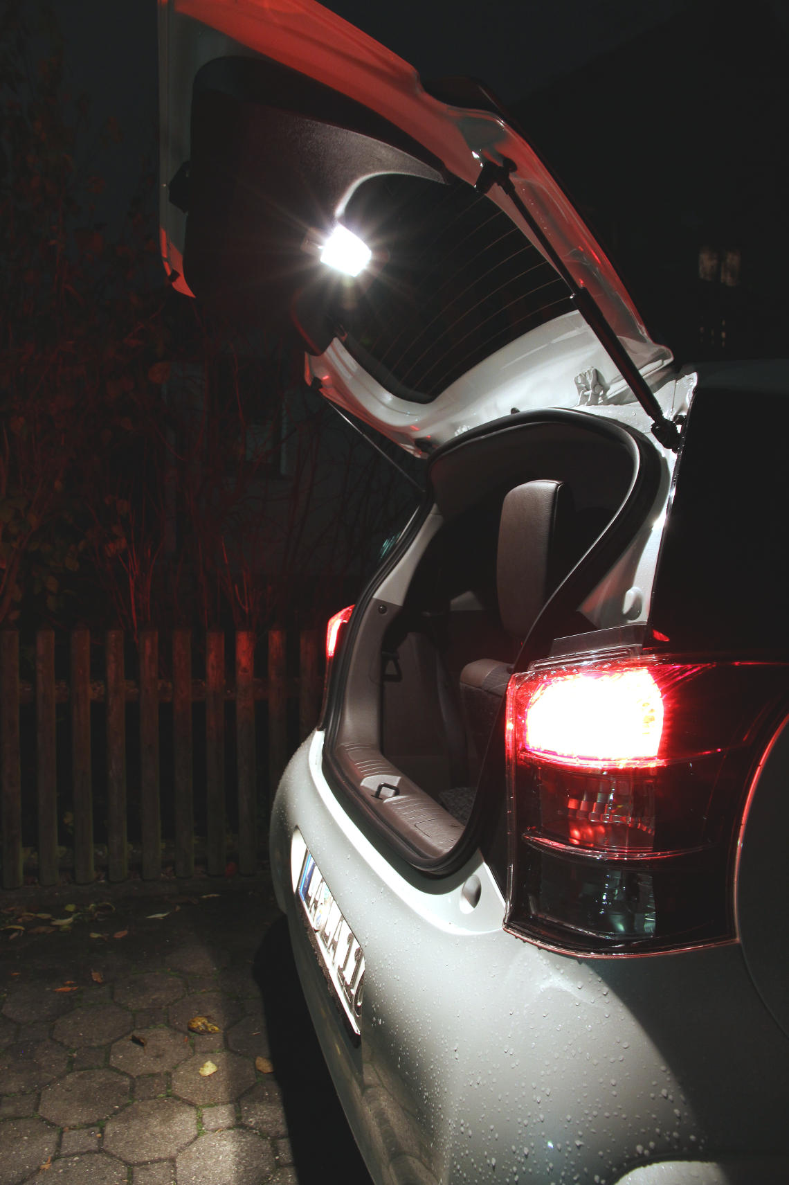

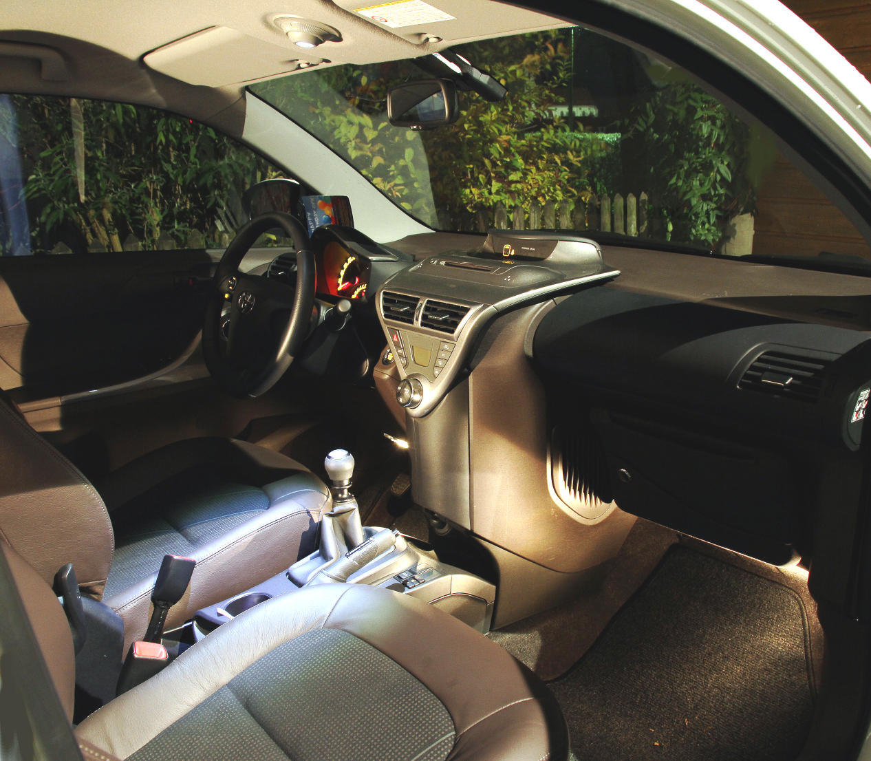

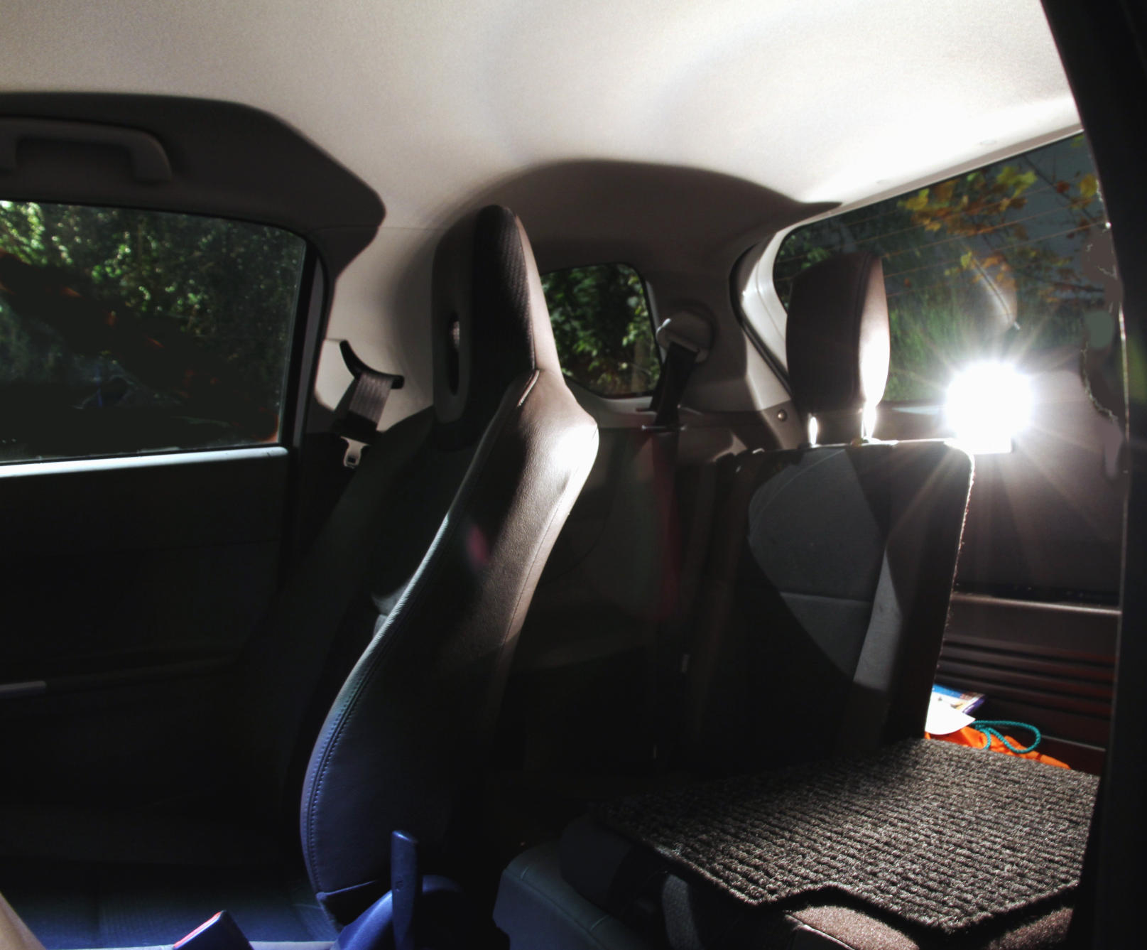

I went to car dealer with very, very old not working cars / parts (don't know the engl. word) and got three interior lamps from an old Audi A4.
Two from the rear side (onle left/right) both working with "old" 5W bulbs and another from the the rear door (estate/wagon) 10 Watt.
The rear door unit is now in the iQ in the rear door and the smaller types are in the footroom areas:
post-78587-1258049243_thumb.jpgpost-78587-1258049268_thumb.jpg[attachmen
t=5804:iQ_int_light3.jpg]post-78587-1258049302_thumb.jpgpost-78587-1258049321_thumb.jpgpost-78587-1258049342_thumb.jpg
Pics 1-3 w/o flash
Let the light go on!

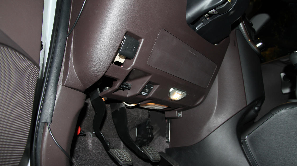

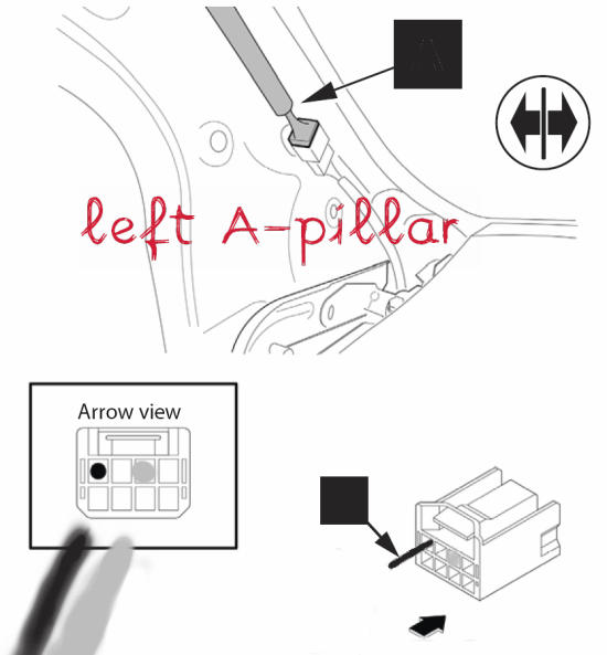

Here is the "place" to connect your additional light.
A 2 wire-line from every "new/real" light to this "place". :eek:

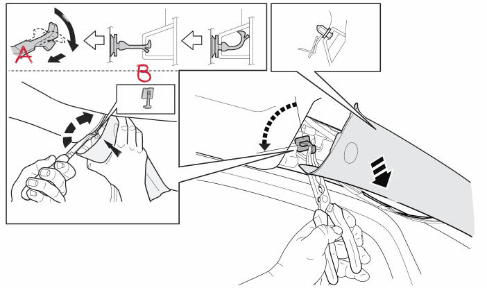

Turn the yellow plasticpart 90° to remove the A-pillar-cover with a click.
Note: my car is LHD (left hand drive).

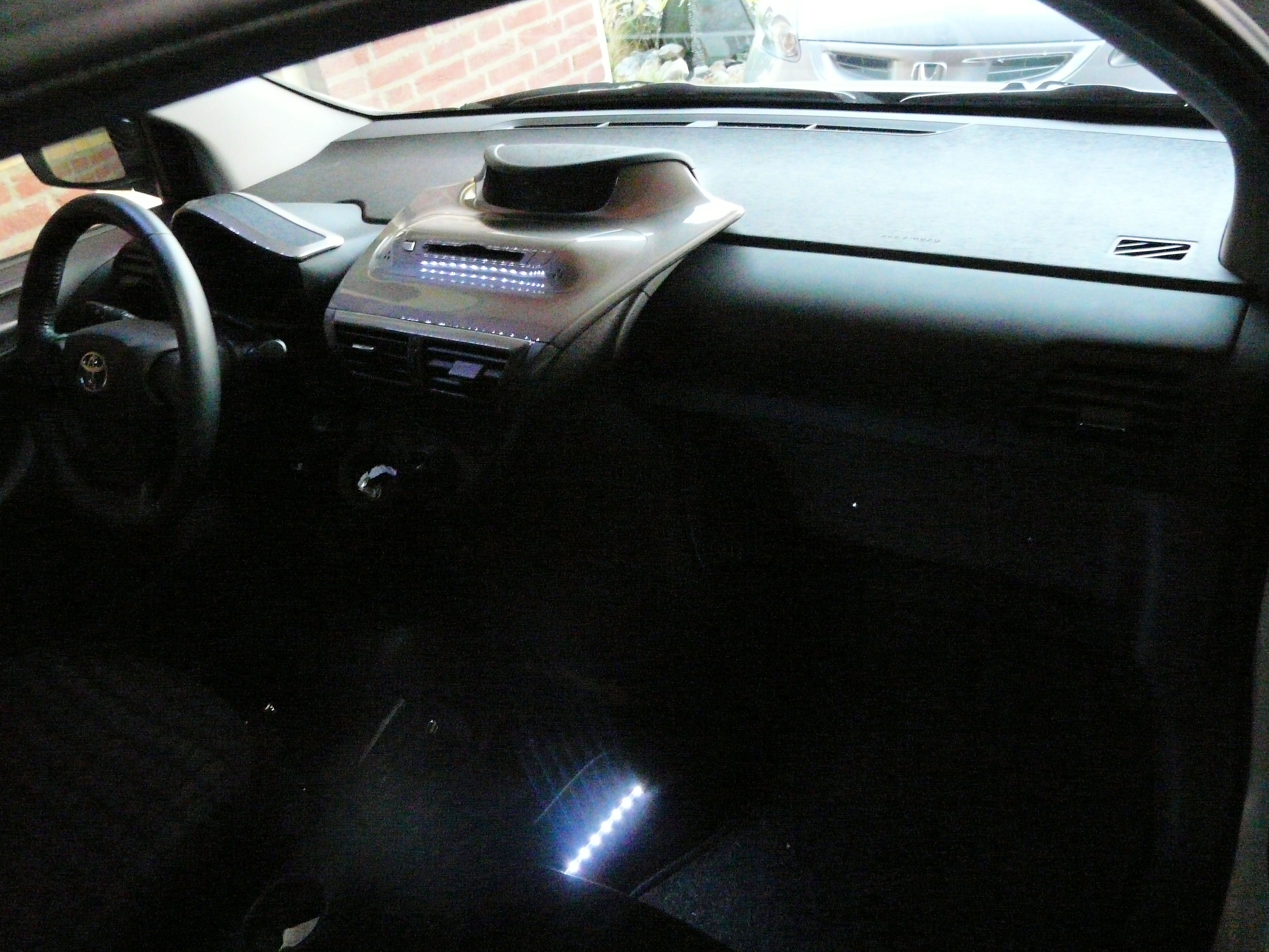

I like your leds, but there are not enough lumen to light the interior.
You're right LaLa. My leds are not enough lumen, but i'm not ready yet. Next upgrade is going te be 2 extra ledstrips that can be manualy turned off and on with the fisheye switch.
I became a "led-addict". :rolleyes:

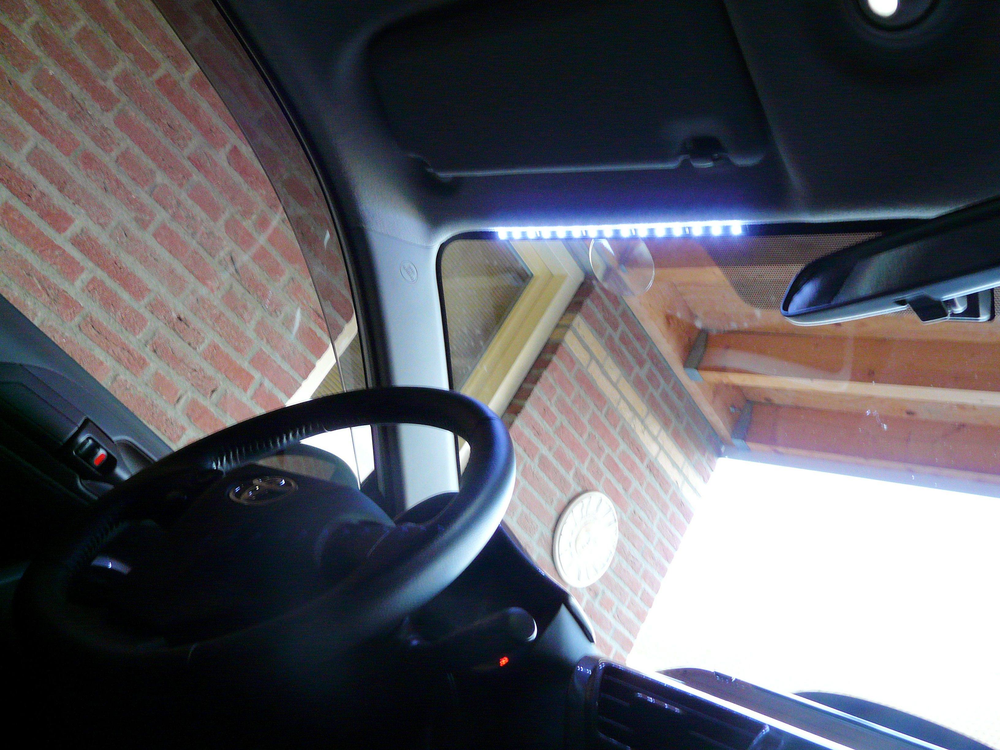

Concerning interior lights, I put in Flexible LED Strip Car Lights, it works a treat and it's cheap(under dashboard) ! I also put up under the doors and it works only when doors are opened.

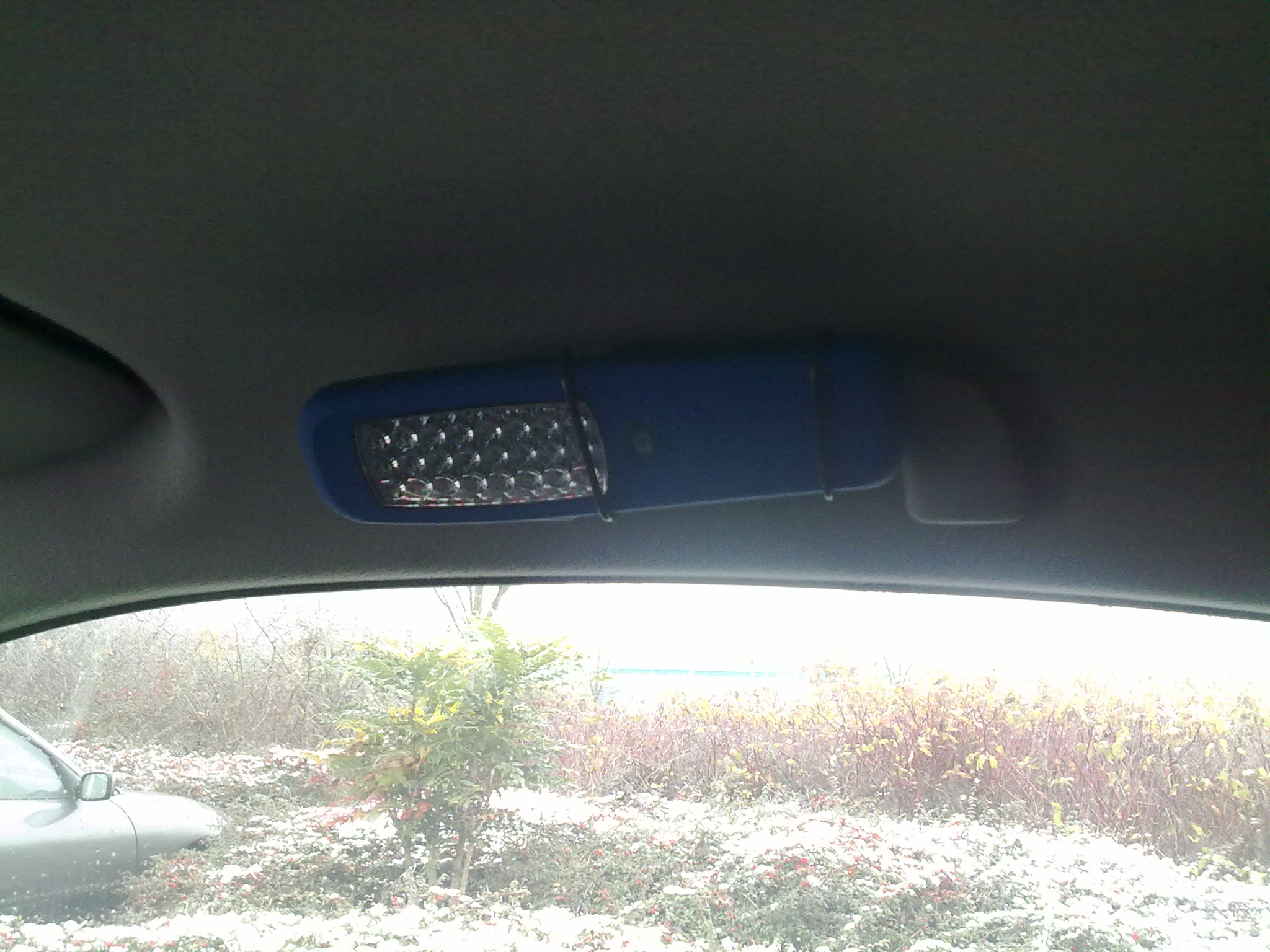

my own low tech solution. 2 'o' rings and a strip of velcro
post-98863-033214300 1291129187_thumb.jp
its a bit dark in the picture, cant see it much, can you do a lighter picture please.
It appears to be a small torch device strapped to the interior pull handle above the doors.
Hi
Thats exactly what it is, 24 led, square shaped torch , slipped into a couple of rubber 'o' rings held onto the handle with a velcro strip. the velcro also holds the handle to the roof. Cheap I must admit, but does the job spot on, throws enough light over the front seat area. Added benefit is you dont have to find anywhere to stow your emergency torch.
