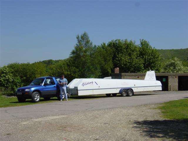

A friend on mine took this 3 door 4.1 combination to Germany with no problems, the trailer's about 10 - 11 Meters long.
I don't think we should speak about the weight :-) post-16780-1259529943_thumb.jpg
Ravs tow these long trailers no problem, my current 5 door 4.2 is more stable with a 8 meter long load than a Grand Jeep Cherokee.
