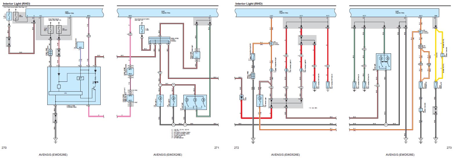

Hi Mate here is a diagram of the interior light wiring. post-74463-1259756653_thumb.jpg it may help you or the mechanic. :thumbsup: By the way the door switches just act as an earth when the door is opened.
Regards Pete.
Regards Pete.
thanks mate i'll pass the diagram on
