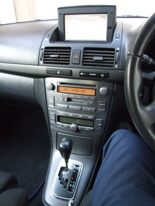

Hello folks,
Sorry for not being on the forum for the while,
Does anybody know how to check light for automatic selector panel for gear status?
I can not see anything when I’m changing gear due to no light there, I can only see it on the dashboard. Is there any separate fuse for this particular light or not?
Is this bulb is easily accessible under this panel?
Gear stick selector panel
Many Thanks

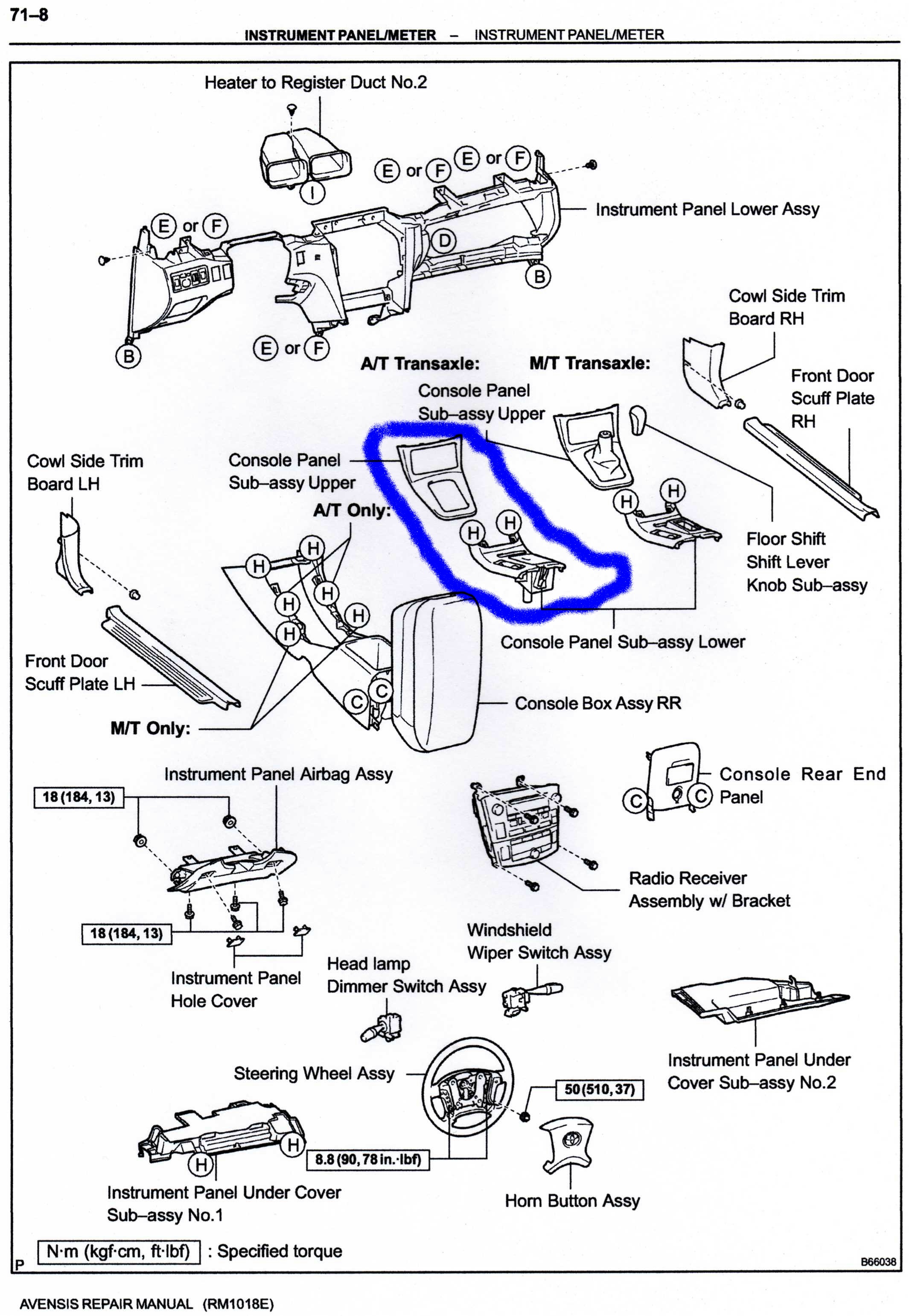

I believe, looking at the manual exploded diagram, that this panel is held in by clips and can be removed by levering carefully, with a flat screwdriver (preferably wrapped in tape).
