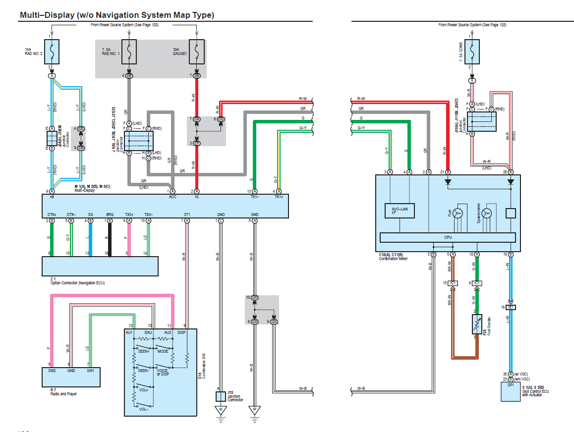

Hello Sarakiniontis, if you or a friend can understand this english electrical diagram it will help you to find the fault post-74463-1262199222_thumb.png
I hope this will help you, all the best for 2010 to you and your family, regards Pete. :thumbsup:

I asked the local toyota service , and told me , that maybe the fault is at the \cpu !!!! :huh:
Because the car is under guarantee <6 years , they will replace the CPU !!! It costs about 1030 Euros (free for me under guarantee)..
I checked all the fuses , and all it's oK..( no fuse is bad), so i will wait to replace the CPU!!
