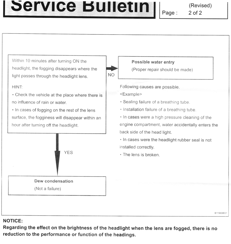

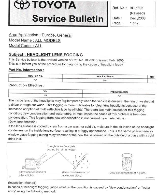

Lights:
Mentioned the misting etc and was given the attached docs and asked to keep an eye on it!
This was the advice given by my dealer in the Uk regarding the misting.
