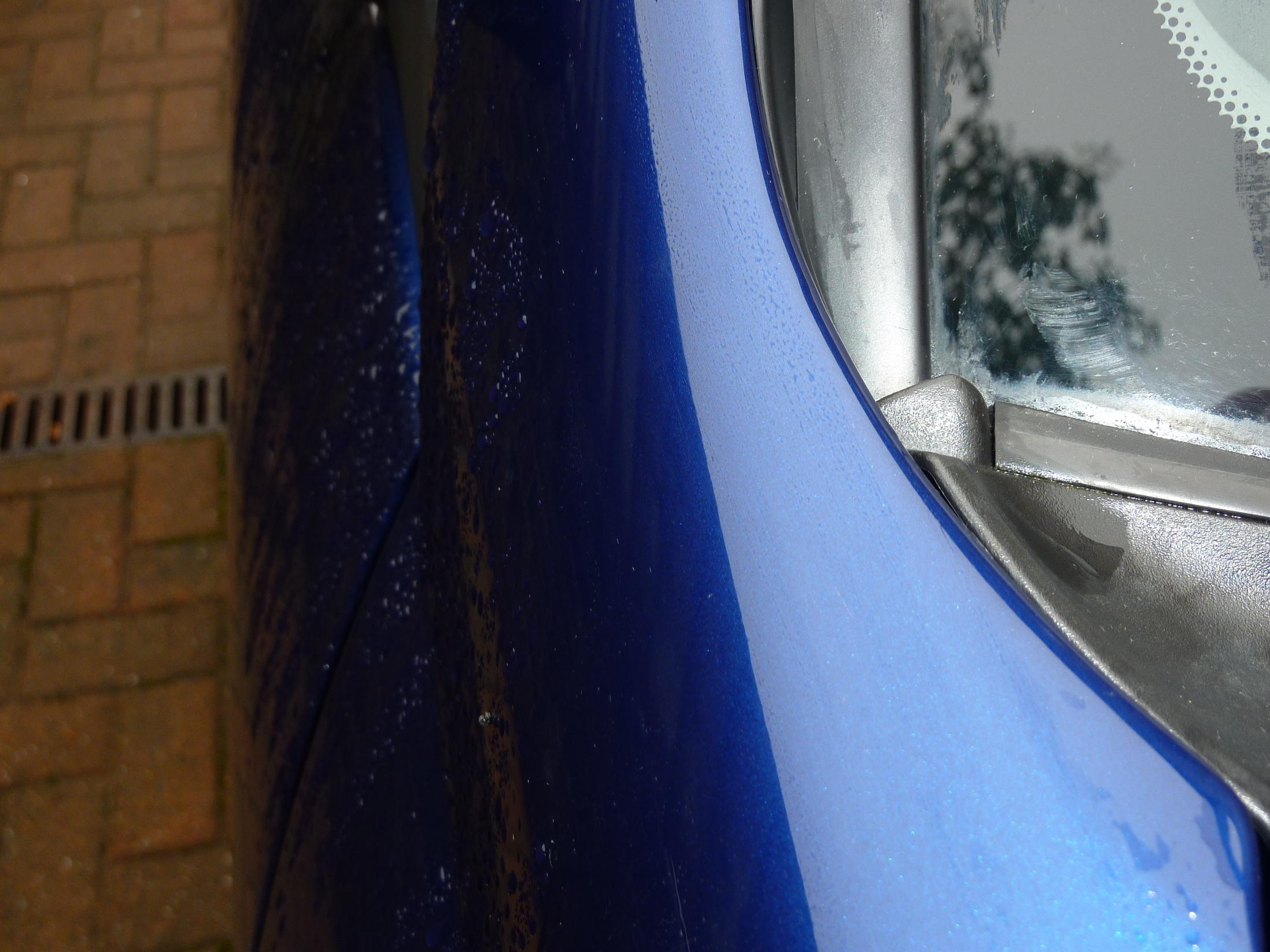

Hi all Ravka owners, Just a quicky!!!
Does this windscreen trim look like its in the correct position, is it surposed to be on the outside like in the photo, or should it be tucked under the top of the wing.
That's bizarre. Looked at mine yesterday and it seemed to have dropped down. Lifted it up until it was touching the fixed bit - don't know exactly where it sits.
Its the same? The windscreen has been replaced, as it had an chip, so i`m not sure if those AUTOGLASS muppets have put everything back how it was?
I personaly can`t remember how they were. also 1 of those plastic clips that holds the cowel on is missing, so they lost one of those too. The passenger wiper did`nt look straight either.
The trim in the photo just seems loose, like it should be tucked under the wing? How does that trim come off Anchorman? Any PDf`s LOL!!!!
Rubber seal sits up against the wing and the bottom corner section goes under the plastic trim along bulkhead.
So like in the picture?

Hi i work for a windscreen co. (not Autoglass) the main side trim clips into a plastic groove which is stuck to pillar , the bottom peice i push under wing
because it looks neater, we cary spare scuttle panel clips they are they the same on a lot of cars, i always check wiper opperation & adjust if neccesary, the trim on 4.2 is more
fidly than on 4.3, but shuold always spend time to make it look right. I would be carefull poking around with screwdriver etc. if you catch edge of glass
it could develope into a crack.
I to thought it would look neater tucked under the wing, but was not sure if it should go there, :unsure: Do they come like that from the factory?
They now seem to be getting loose the way they are now, wind catching them etc.

As per your pic, just twist it so the rubbers against the wing
They won`t twist, they are bent out that way, I`d have to take it off and bend it back, so it seats on the wing, but think I`ll tuck it up behind it.

To me they look like they should fit under the wing, Iwill try it that way and see if it fits.
Looks like this
A picture says a thousand words - thanks for taking the trouble.
Excellento!!!!!!!!!!!! :yahoo:
So they must be tucked up under the inside of the wing. Does look better that way too.
