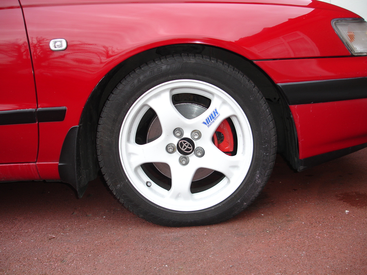

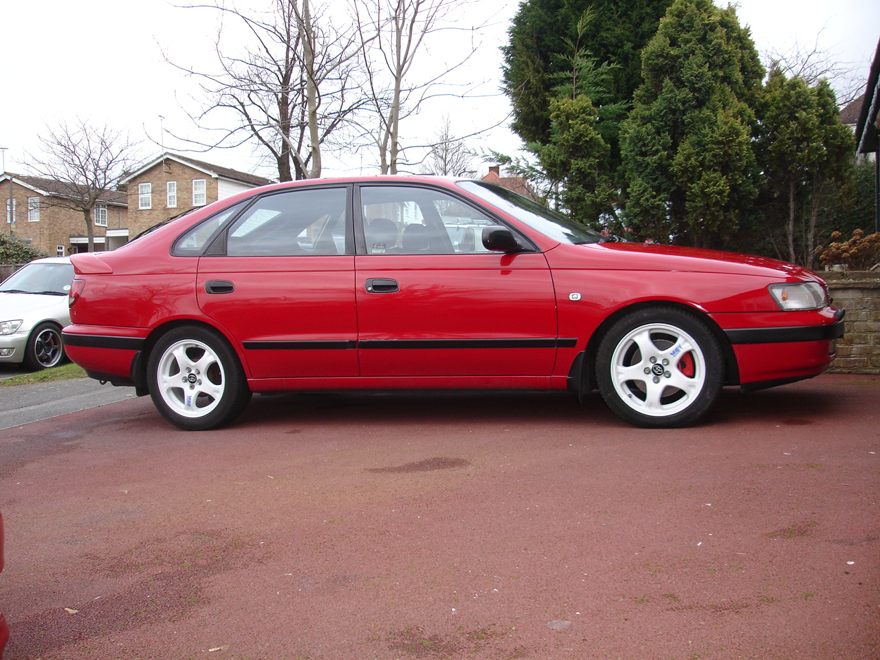

The car
Front wheel with Subaru alloy painted white with Volk racing stickers and 205/50's.
You will also see that the discs are biger than std Carina discs.
Brakes fitted are from Celica ST202, direct bolt on.
