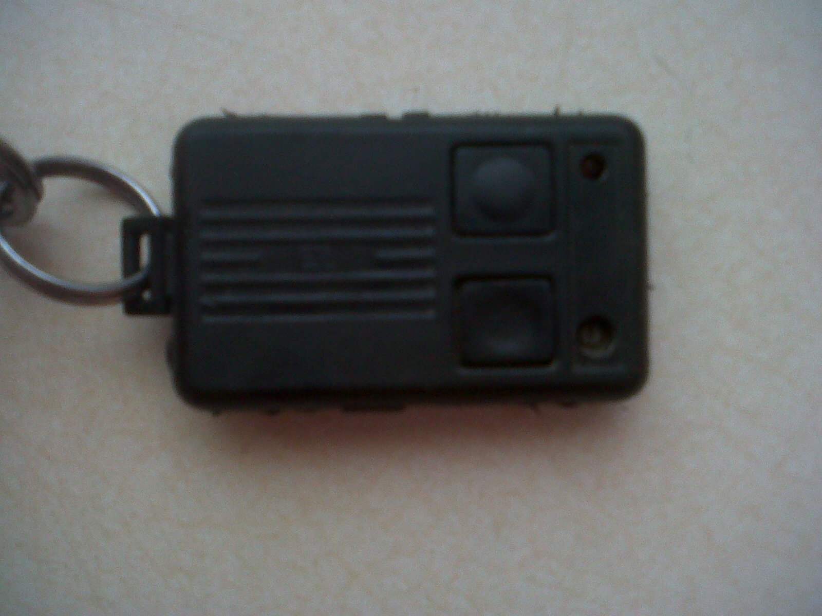

If this doesn't work, what's the next step?? I have no idea what make the alarm/immobiliser system is and there is nothing written on it to give any indications, the key fob is black, about the size of a matchbox with 2 square black buttons next to each other! Is there any way to re-sync the fob with the car??

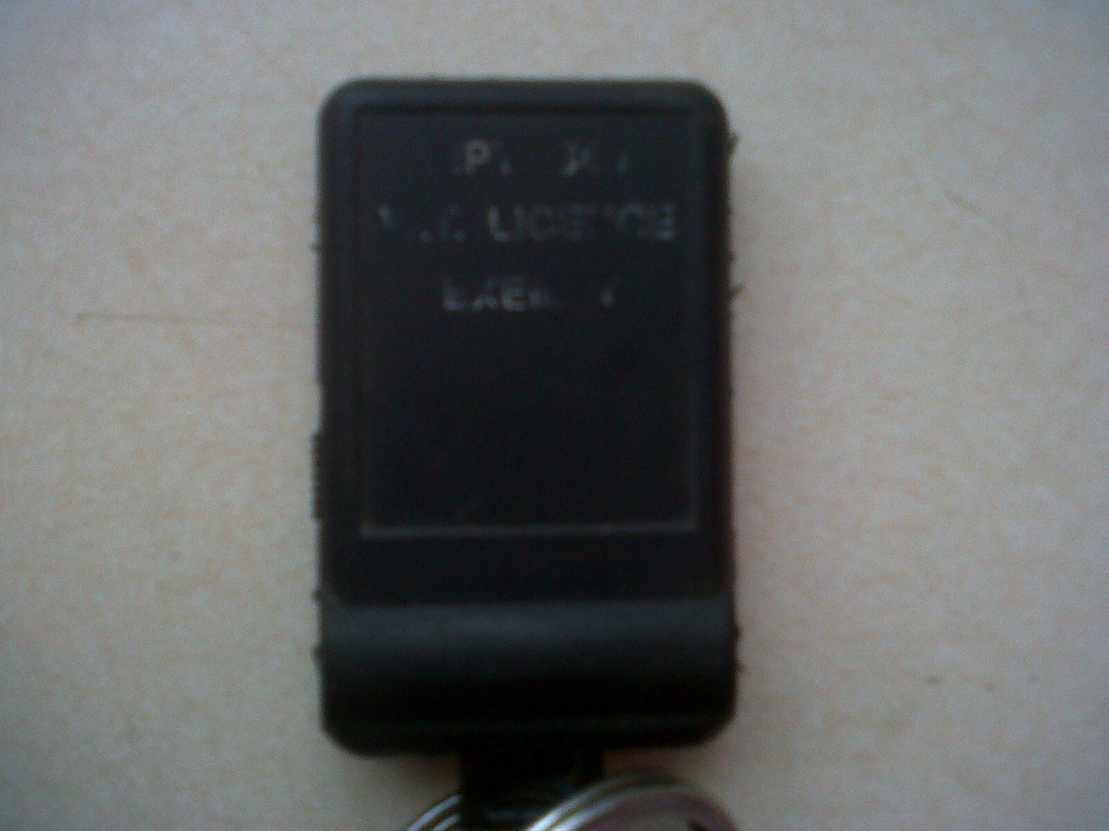

Hi, no both the buttons are black, photo attached (hopefully!!)

On a 4.2 you hold both buttons until the indicators flash back at you. Its worth a try.
