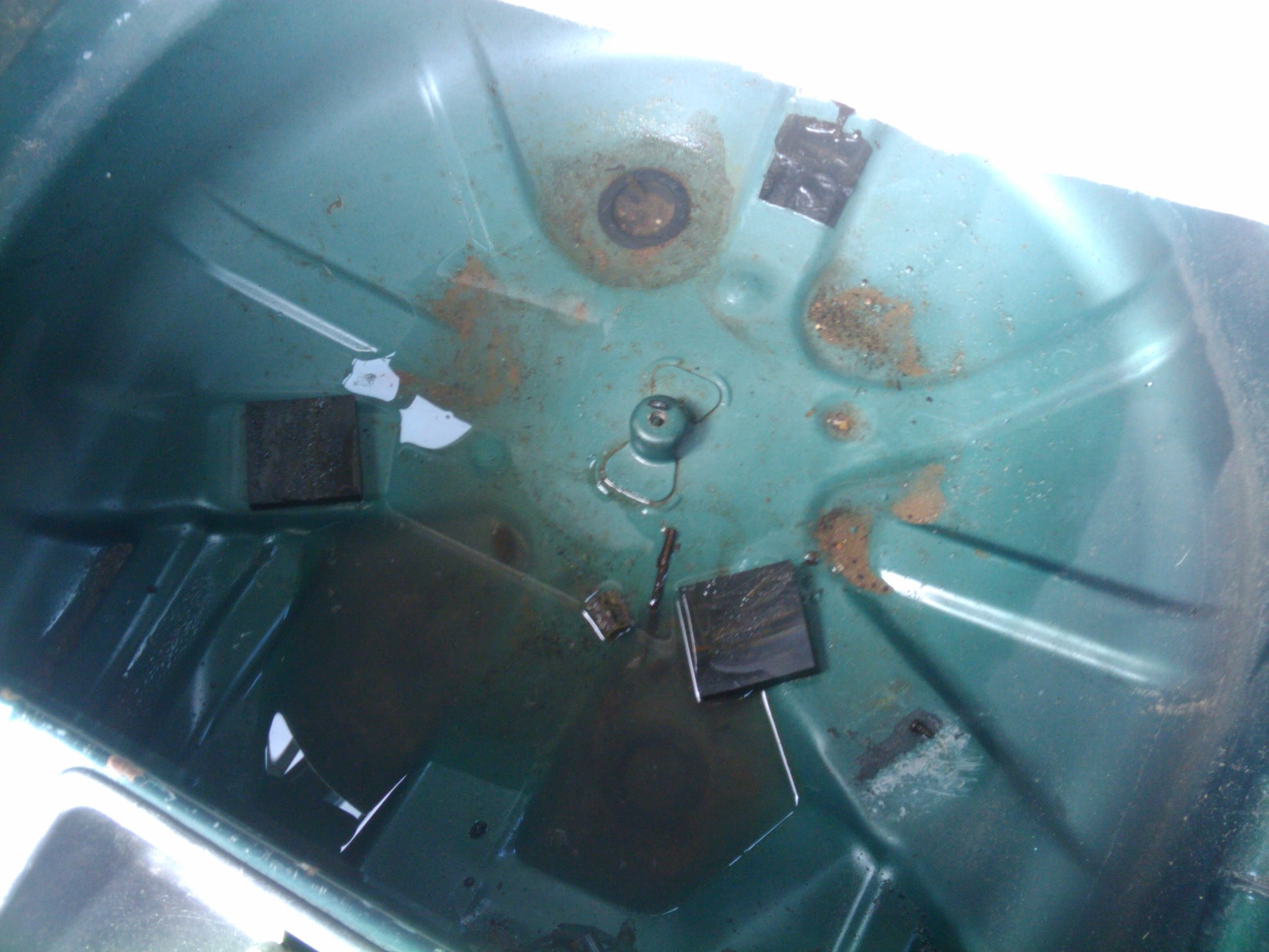

Okay, so i've dried out the small lake that was in the hold where the spare wheel is kept in an attempt to stop the issue. The rubber seals appear to be undamaged so im going to leave the sealant for now, but if it persists then I think this may be the best course of action.
Photo attached is the water build up. Quite alot without my noticing no? :S
Another place to check for water ingress is at the rear light clusters, check the seals (rubbery foam gasket) for deformation.
