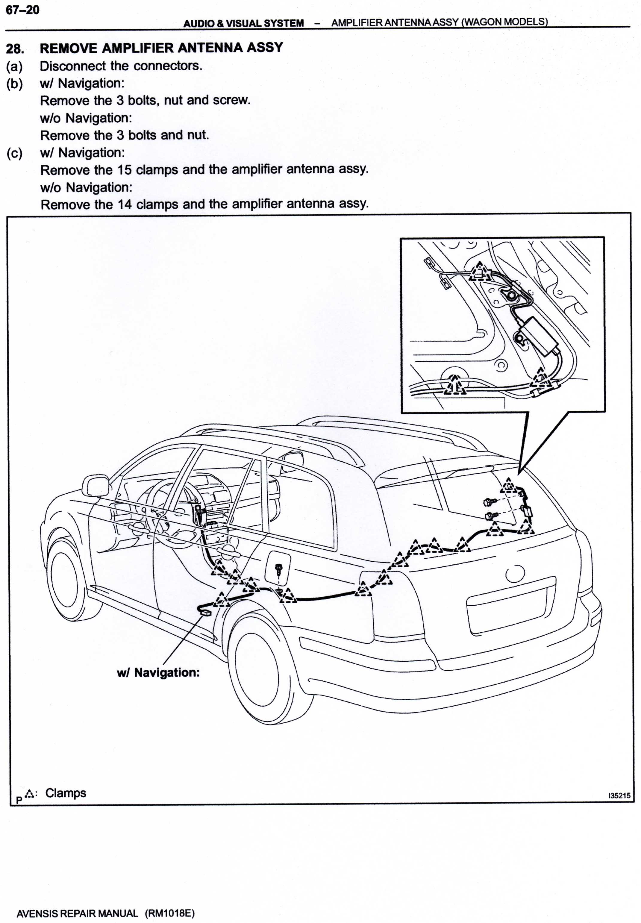

Not sure what year your car is but see if the attachment helps.
Fitter
Thanks for the illustration, unfortunately it doesn't really help.
The car is an 07 T3X estate and does not have the satnav, so only one connector is bonded to the window aerial.
But thanks again for trying.
