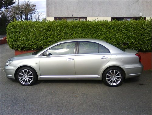

Yh im 18
and i wana know how to take the door panels off in my 2003 Toyota Avensis T4 (1.8 Litre Engine)
i have had it since April 2009 and i have blown all the door Speakers so i wana just replace with Jbl Speakers from Halfords
Any one know how please help
i think its this 3 little clips at the bottom of the door but i duno need sum help please
PICTURES OF MY CAR BELOW:
http://www.bebo.com/PhotoAlbumBig.jsp?Memb...umId=9096384859
