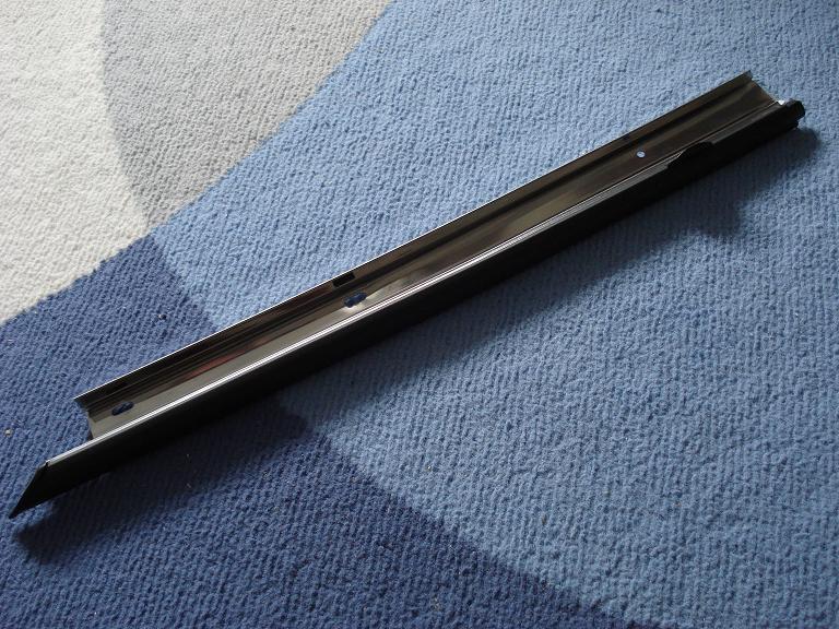

Hi,
One of the plastic covers had gone missing on my side window which helps form the waterproof seal around the window, I've managed to get the part I require but I'm not 100% sure how to fit it. Any advice would be much appreciated!
Many thanks,
James.
Hi James
I had a quick look at mine and had a go at popping the internal screen trim to get at the surround rubber and it came away but the trim retaining poppers came off and I had to fiddle about to get them back on.
Not that it is a big problem though as it looks like you need to undo the top & bottom trims as well, 10mm bolt it looks like at the bottom and a hex/torx type fitting at the top. This should let you get at the rubber surround.
After that I would need to check further but you might see the necessary screws holding the trim in place.
Hope this helps
Les
