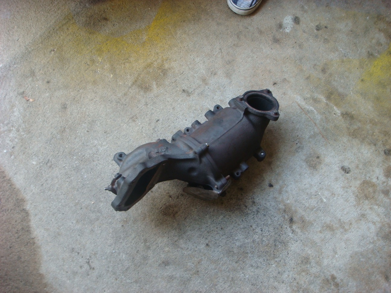

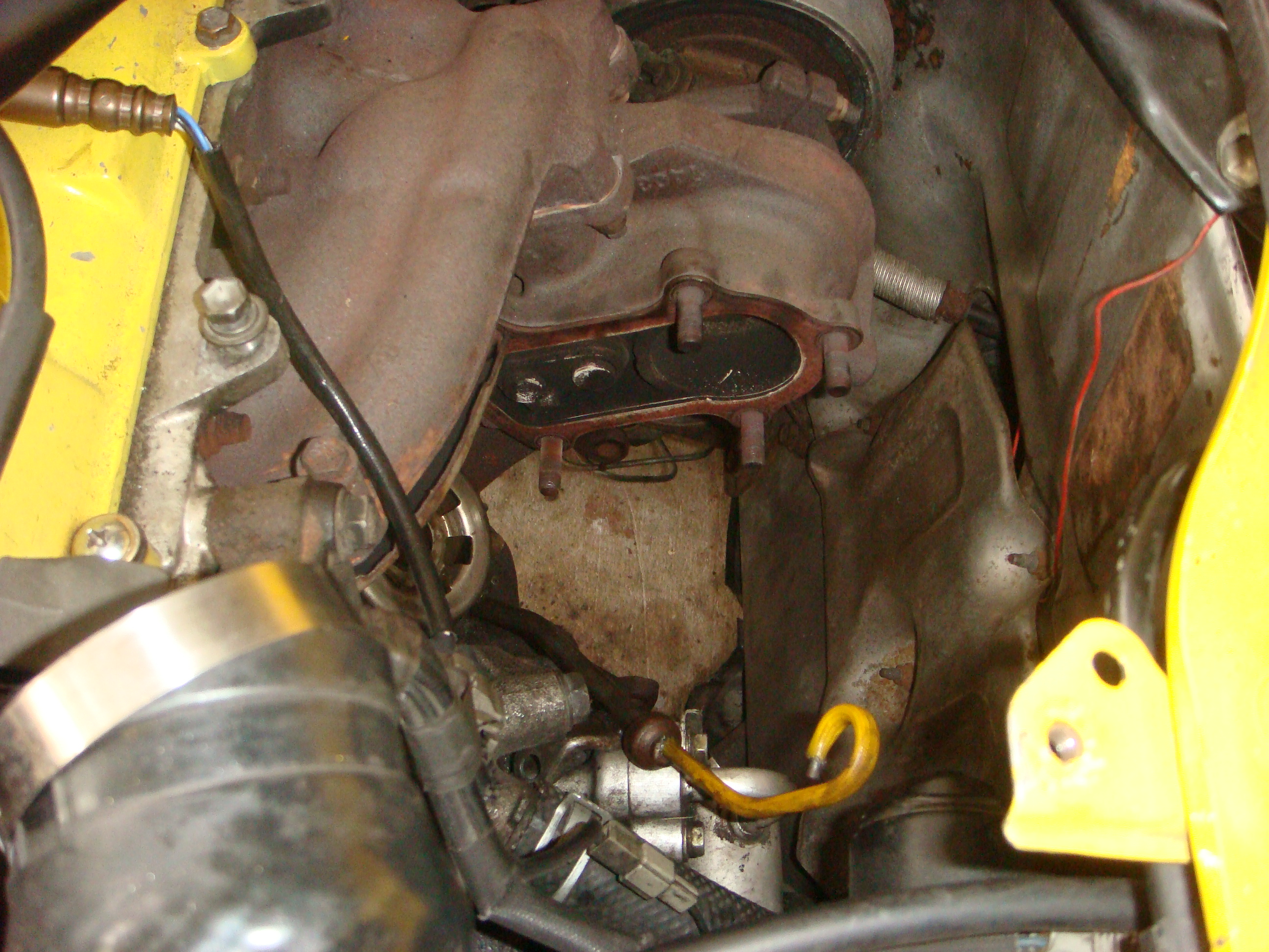

And its out (as well as the tranny)... Compared to the transmission, this downpipe install was easy even with the engine in! Hardest part was Takin the stock exhaust off of the cat, Had to cut the nuts off with a Recipricating Saw... And i stripped a bolt on the Cat to downpipe so i had to drop it as a whole... The part i thought would be worse (the nuts holding the pipe on) Wernt bad at all, but i prepped with like 4 days of PB blaster... Well it went well, just thought id post some pics
