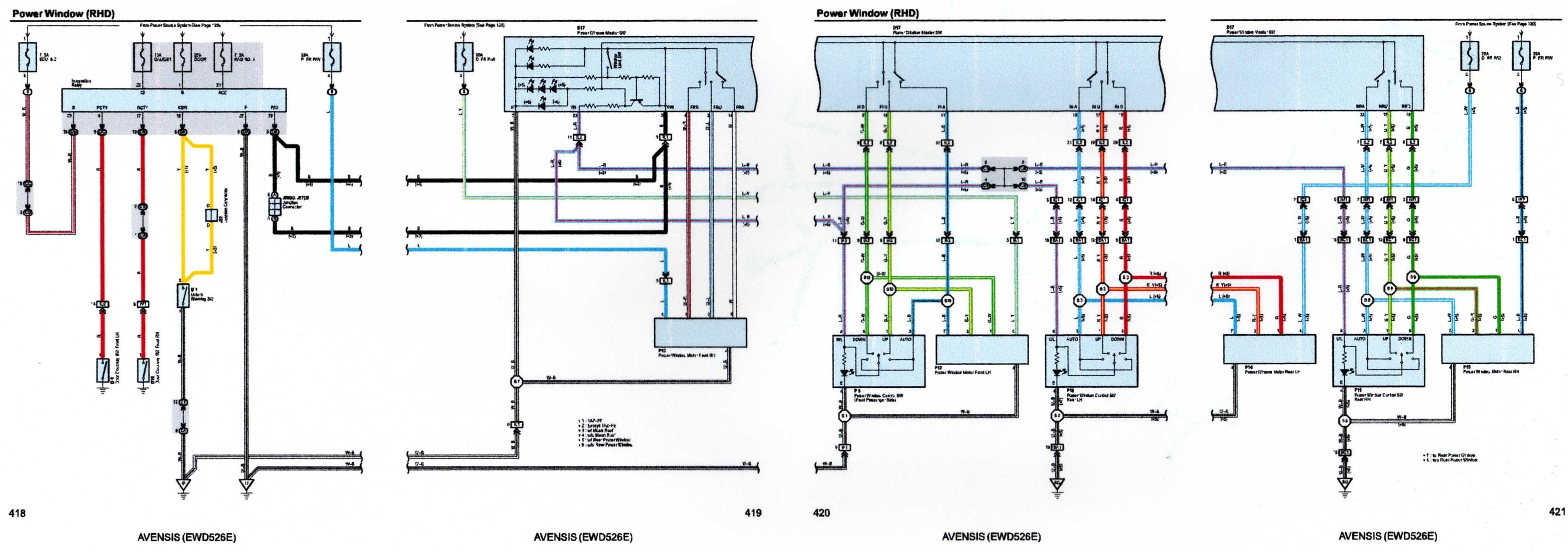

I attach a wiring diagram of the power window system. I hope that it is the same as your model. You will have to enlarge it to get the detail.
Fitter
Fitter

cool, looks good, dont think you'll have any problems with it, should be a wire going to the (auto) wire and maybe one going to the (up) wire to enable the auto function know taht it needs going up and not down! Not 100% but sure it gives you more information on what wires you need!

you can trust it as i ve install this module on several cars like honda civic, toyota corolla, mazda and so on but on avensis its the first time but its not working properly. its dont close all the window at the same time, its goes one by one. can someone tell me how the auto button work i mean what does it need to go up or down as it use only one wire.
If it only uses one wire i'd try attach it to the "auto wire" on the wiring diagram you'll see up down and auto. This this just sends a current to the window motor that keeps the current running for several seconds or something! If you try this with one wire it'll give you a chance to see if it works!
