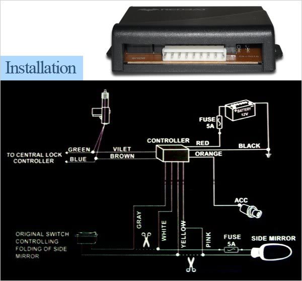

great device. no need to worry about closing your mirror everytime and its really easy to install. installation about 30 min. fold when locking and unfold when unlocking.

one more thing dont buy the T-Harness adapter coz it wont fit the avensis. if you need help on wiring just let me know i'll post some pic
