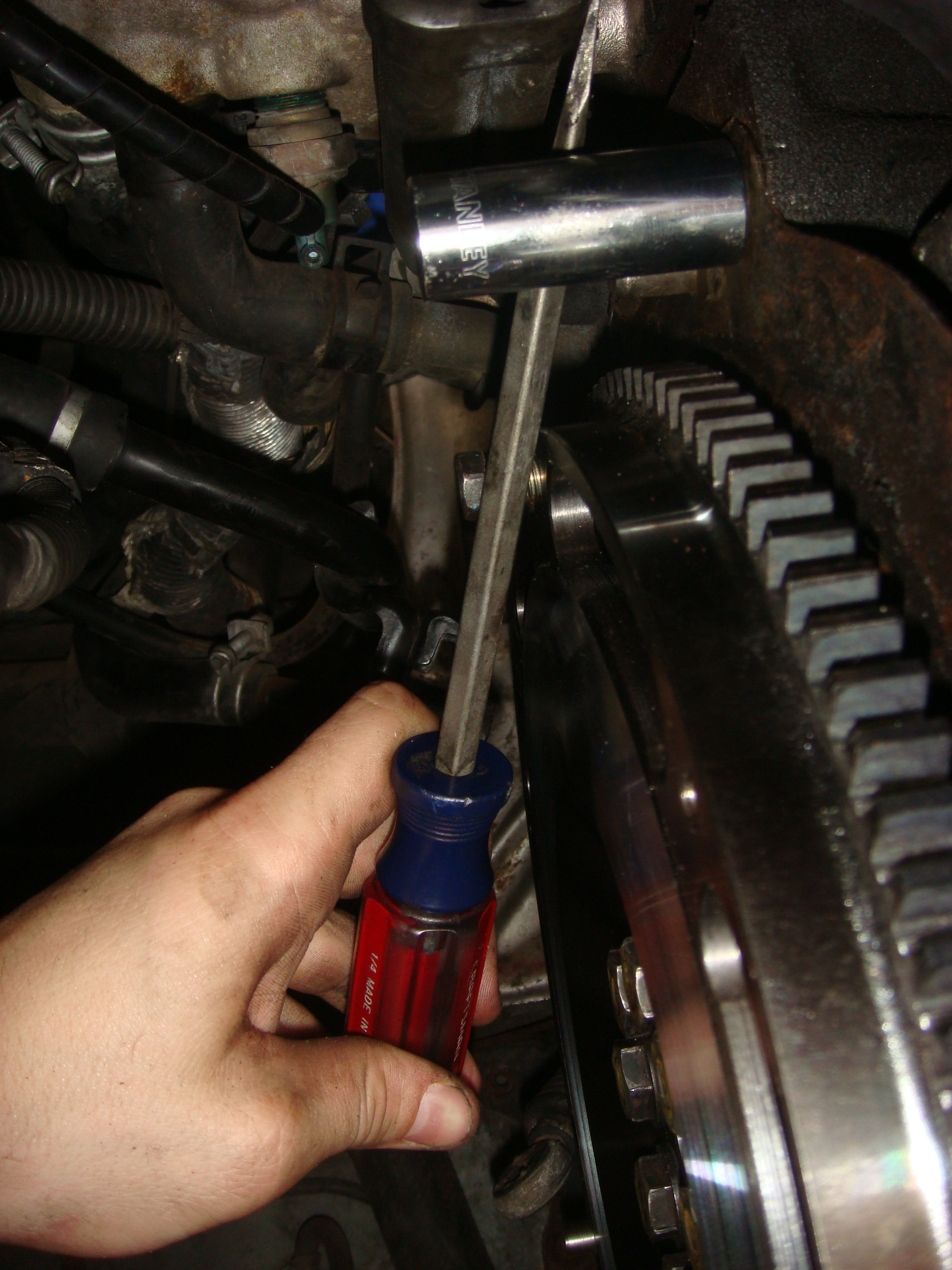

After sitting and staring and googling how to take the flywheel off and puting on, there was 1 way to take the flywheel off (impact Wrench) and 1 way to put it on (wedging wood between some points)... found another way thats inexpensive and EASY! I think i took a 14MM deepsocket and put it on the stud on the back side right next to the back peg for alignment. Then i installed a clutch cover bolt inside the flywheel and rotated it so i could wedge a long screwdriver. This works for taking it on and off... Here s a pic to put it on, just do the opposite for reverse.
A good trick, although when I have someone with me I will just ask them to hold the crank pulley with a spanner and that does it just fine. :D
Good idea though for those working lone-wolf style. :yes::thumbsup:
