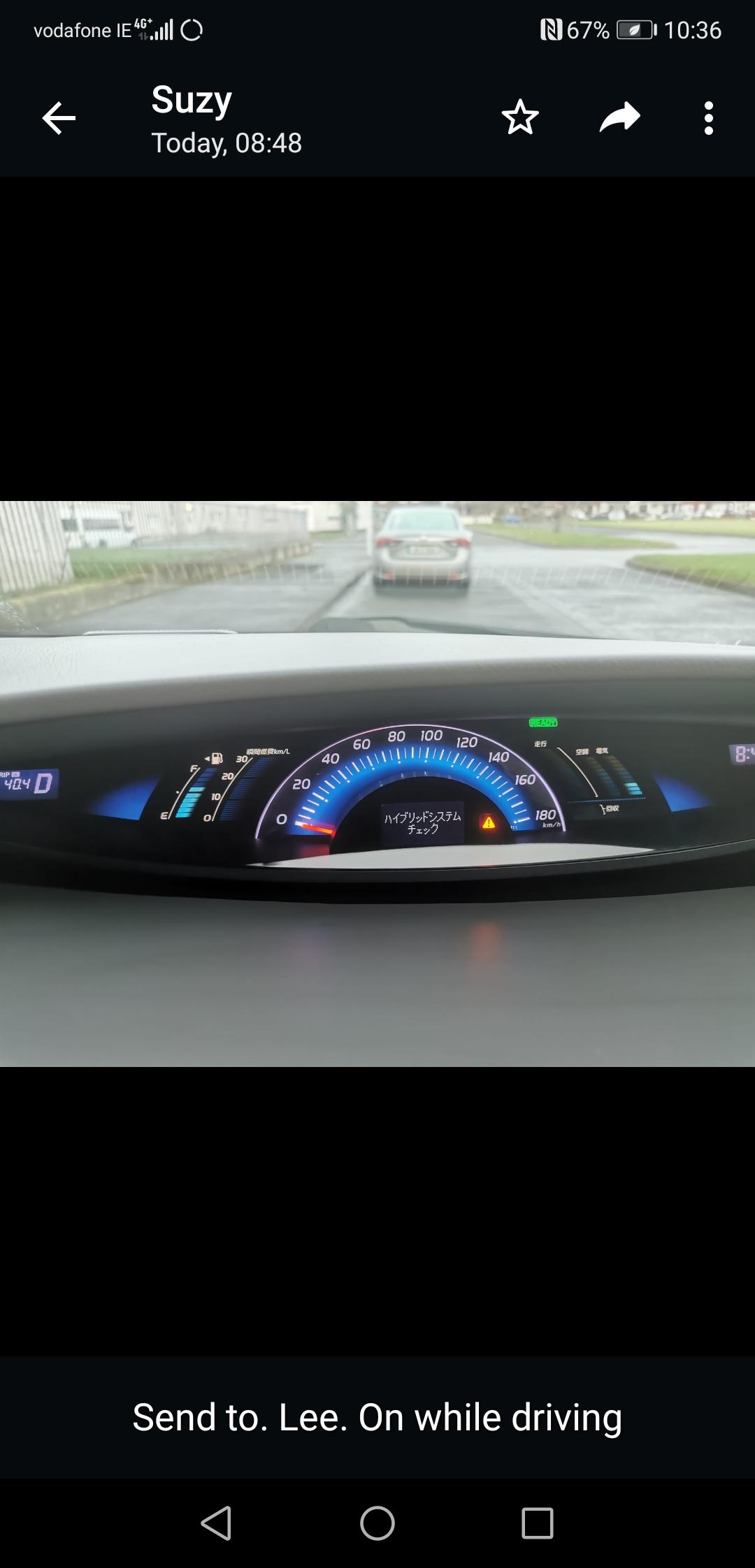

 Hi I've recently bought a 2012 toyota estima. There is a light on the dash constantly. Its a triangle with a explanation mark and orange in colour. Any idea?
