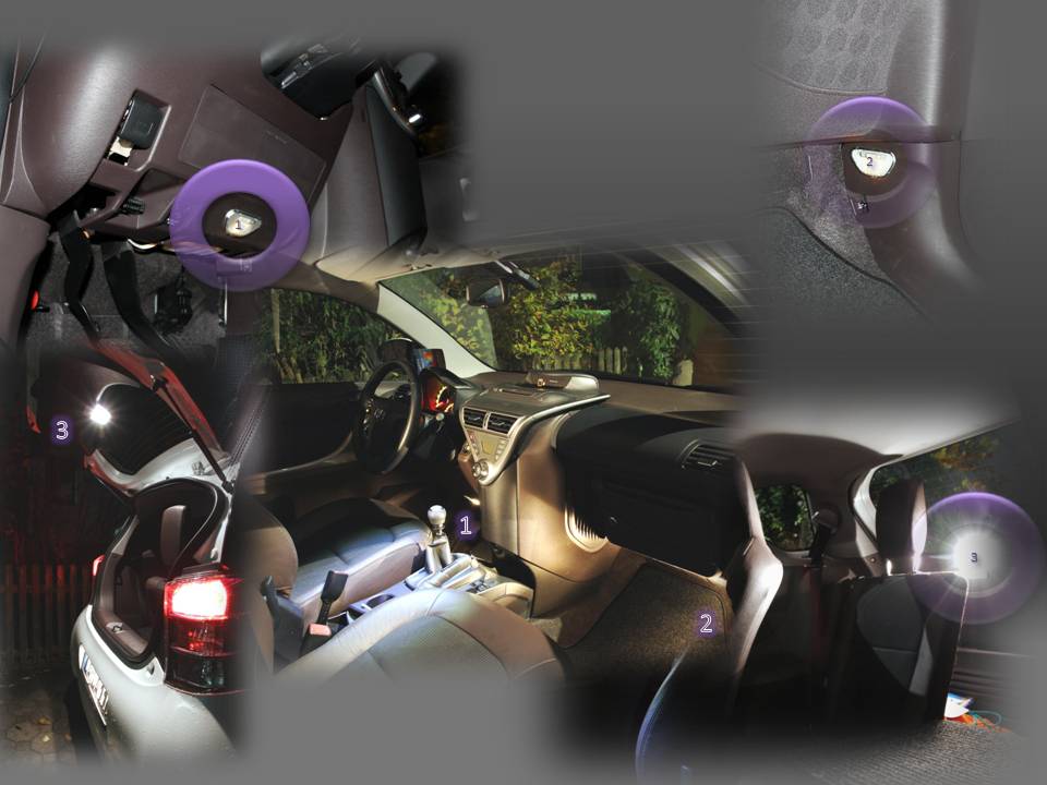

I added 3 extra lights (each in the footroomarea and one in the reardoorlid from "broken" car).
Can you post pictures of it? What kind of lights and how put it there?
thanks :)
The footlights (#1 and #2) and the reardoorlight (#3) are from an old Audi A4. Dimming is with the "great" LED-spot.
All photos shot without extra light!
Nice job, if only I know how to do it myself :(
It looks complicated to do the wiring, cutting the plastic and connecting to the main circuit so they auto power on when the door is opened etc...

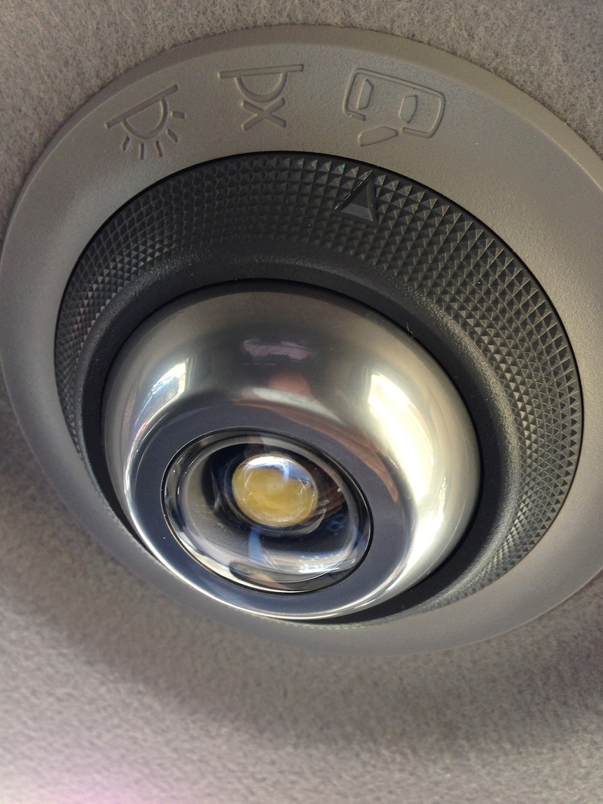

Hi There
This is the Modification I do for the Dome light..It is 12 times the rating of the original light and the Led is brought forward so the beam angle is much wider covering all the front cockpit and part of the rear,
David
post-109788-0-05237400-1392669138_thumb.
And he has a rear area light that is easy to wire up and completely floods the rear compartment with bright, blue-white light.
