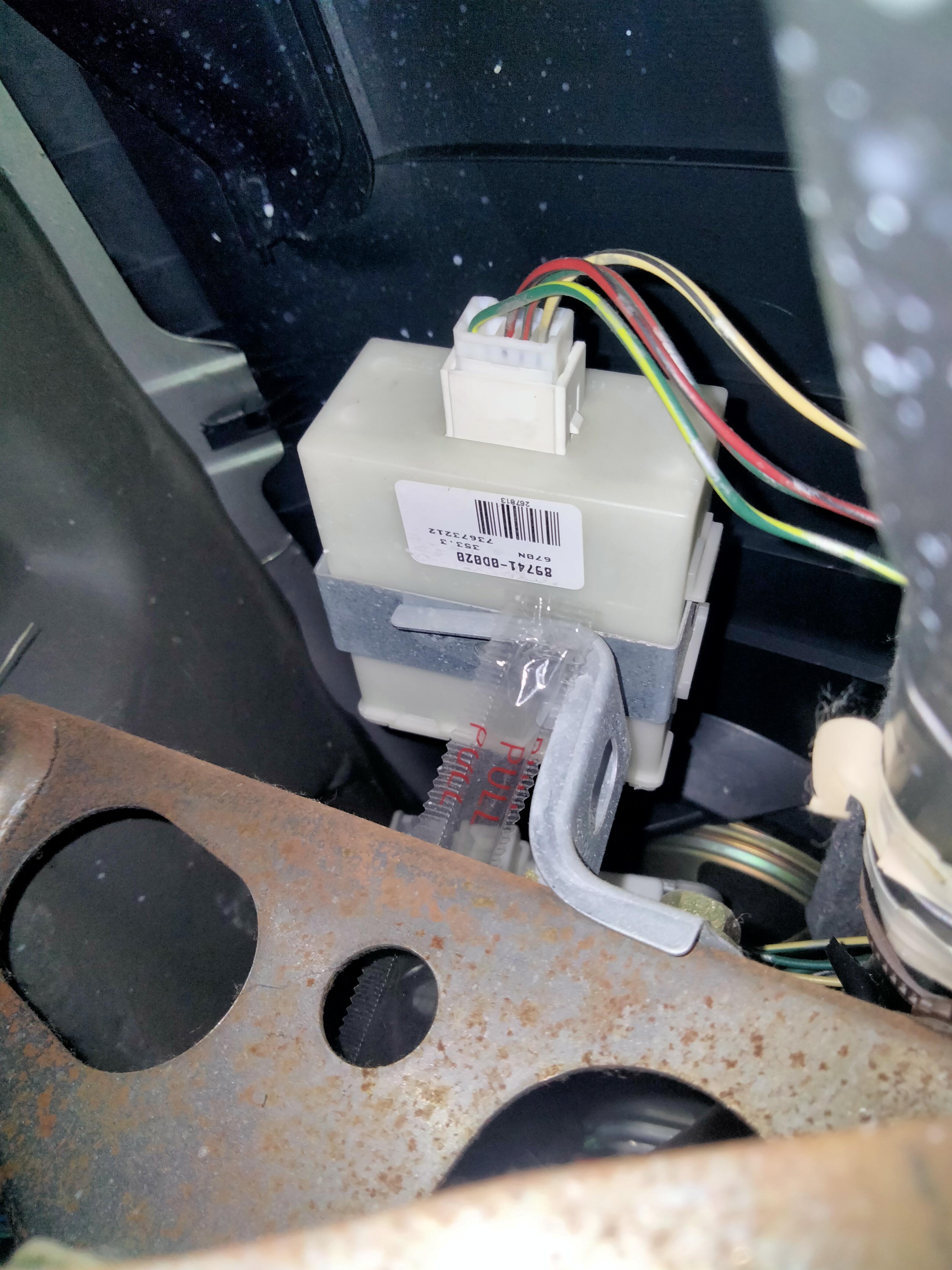

Is there any easier way to check for the receiver? My Haynes manual suggests taking all of the dashboard out plus steering wheel to locate it. No thanks. I had a search online for any videos or anything to locate it but was unable to find one
Pete
On 10/8/2023 at 10:08 PM, boyse7en said:
Thanks for that. I tried following these instructions, but I still get to No10, the locks cycle and then I press the buttons on the remote, but nothing happens. The locks never cycle once, nor twice.
Perhaps try what Flash22 says? See if you can locate the receiver and if it's plugged in? Your problem is exactly what mine is doing and I have a 1.3L as well

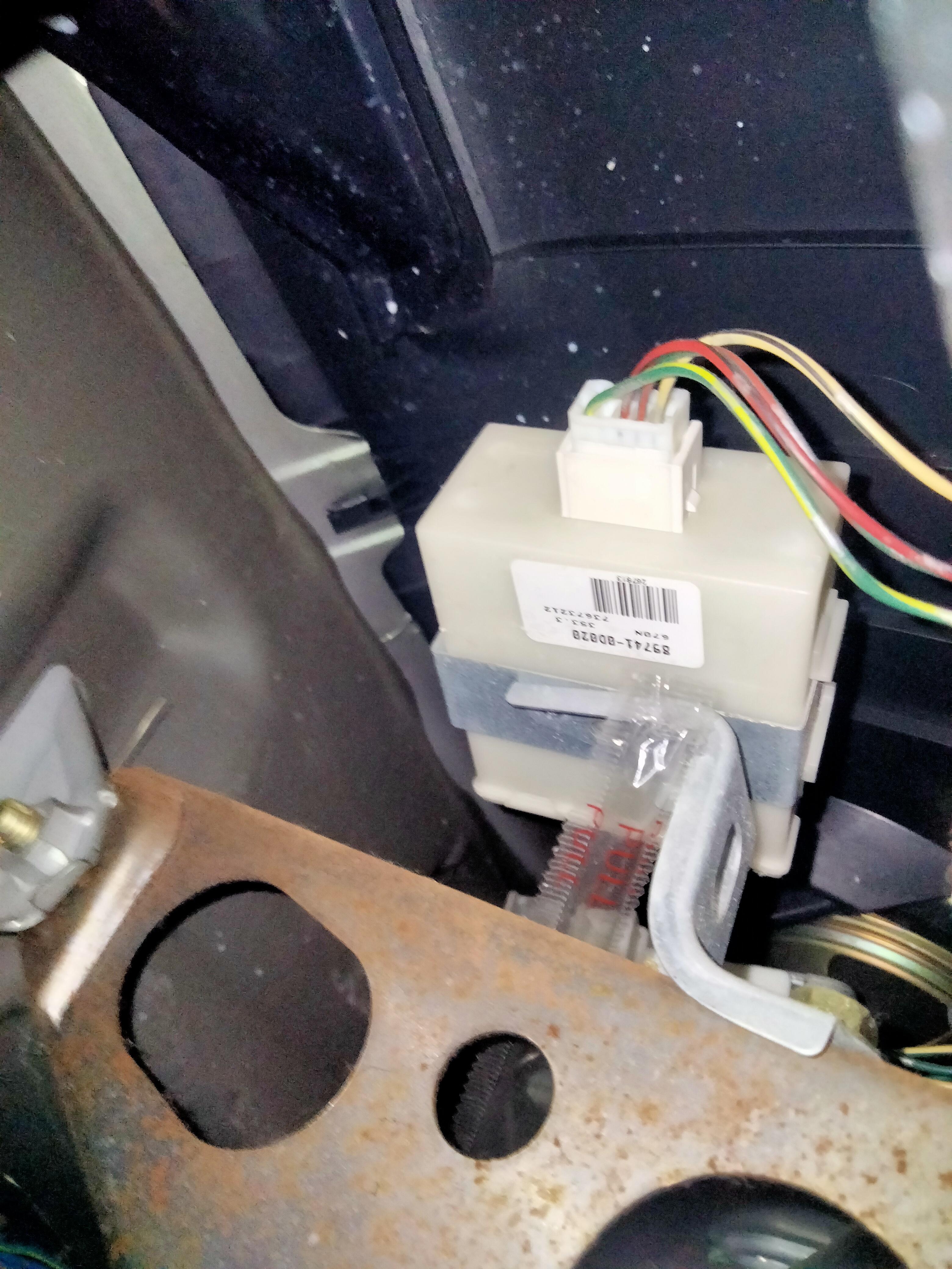

no need to pull the dash stick you head in the footwell and look up a torch
IMG_20231010_190549.thumb.jpg.2b864af4eef82f1385645644f75c9854.jpgIMG_20231010_190549.thumb.jpg.2b864af4eef82f1385645644f75c9854.jpgIMG_20231010_190547.thumb.jpg.dc404f0a2cffb07ccc17c246dc434c71.jpg
Haha I had a brain !Removed! moment. Well done for suggesting that, Flash22. Yep definitely there. Though I have absolutely no idea what that wrapper is that says pull on it. No idea.
Not sure on the pull tab, unplug the connector from the module there is some sort of dust/dirt on the loom and plug
it looks like there has been moisture/condensation under the dash at some point

I'm going to try this method once I finish work in half an hour or so. I'll disconnect the plug, try and blow it somehow and reconnect it. I don't know why the metal frame is showing some patches of rust. The car used to collect a bit of damp in the boot area but I found this out very quickly after getting the car. The rear light clusters used to allow water in which is a common problem on the Mk1. Rectified will silicone sealent on the gaskets and the some gorilla tape around the top of the clusters. Hasn't had damp in since.
I'll update with the outcome

So I attempted to try the updated instructions after I removed the plug and the wrapper from the central locking ecu (the wrapper was from a straw, from a previous owner) still no response from the car. I get to part 10 and when I press the lock/unlock button for 1.5 seconds and then lock for 1 second, the car does not respond at all. I'll keep trying as I might not be getting the timing right
