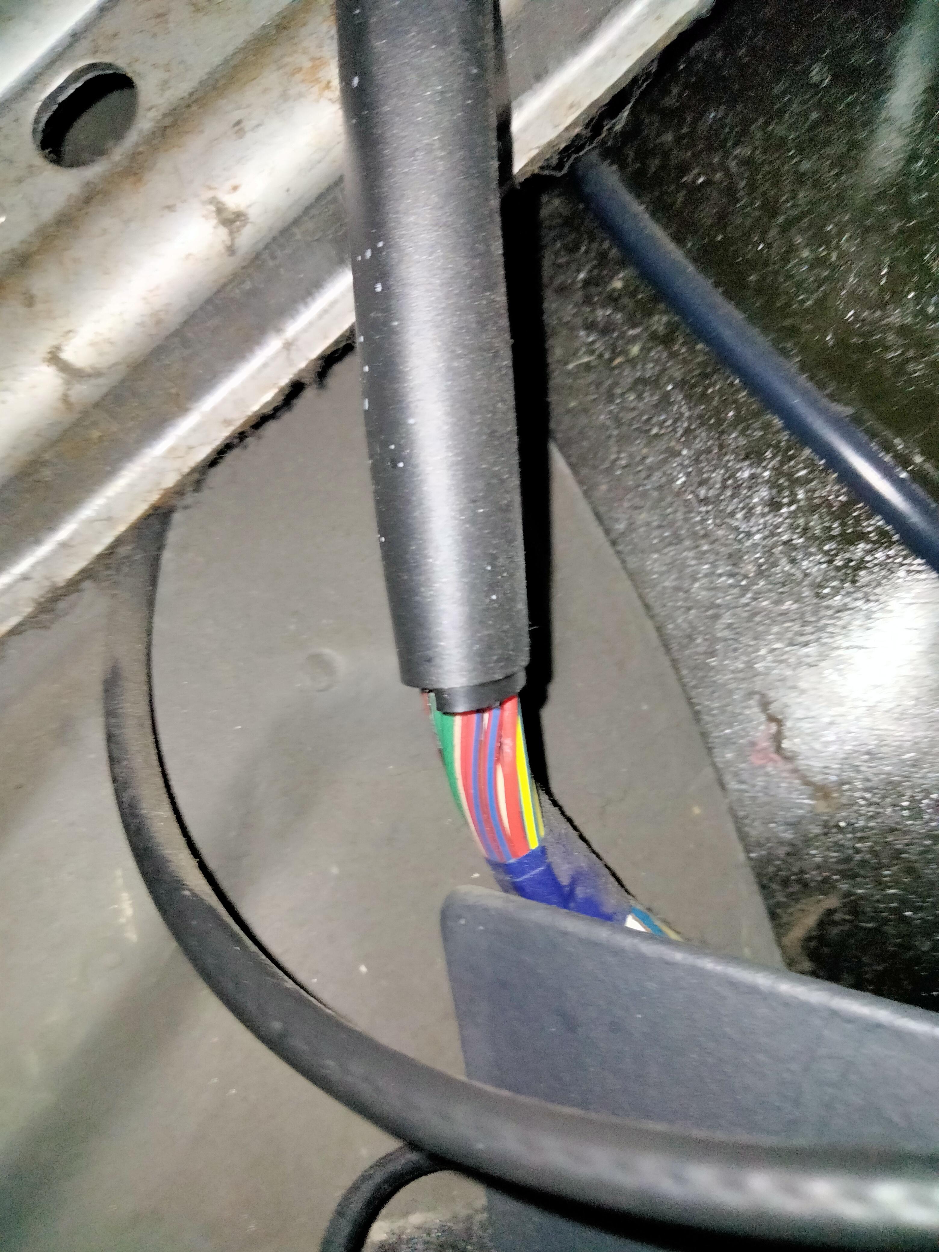

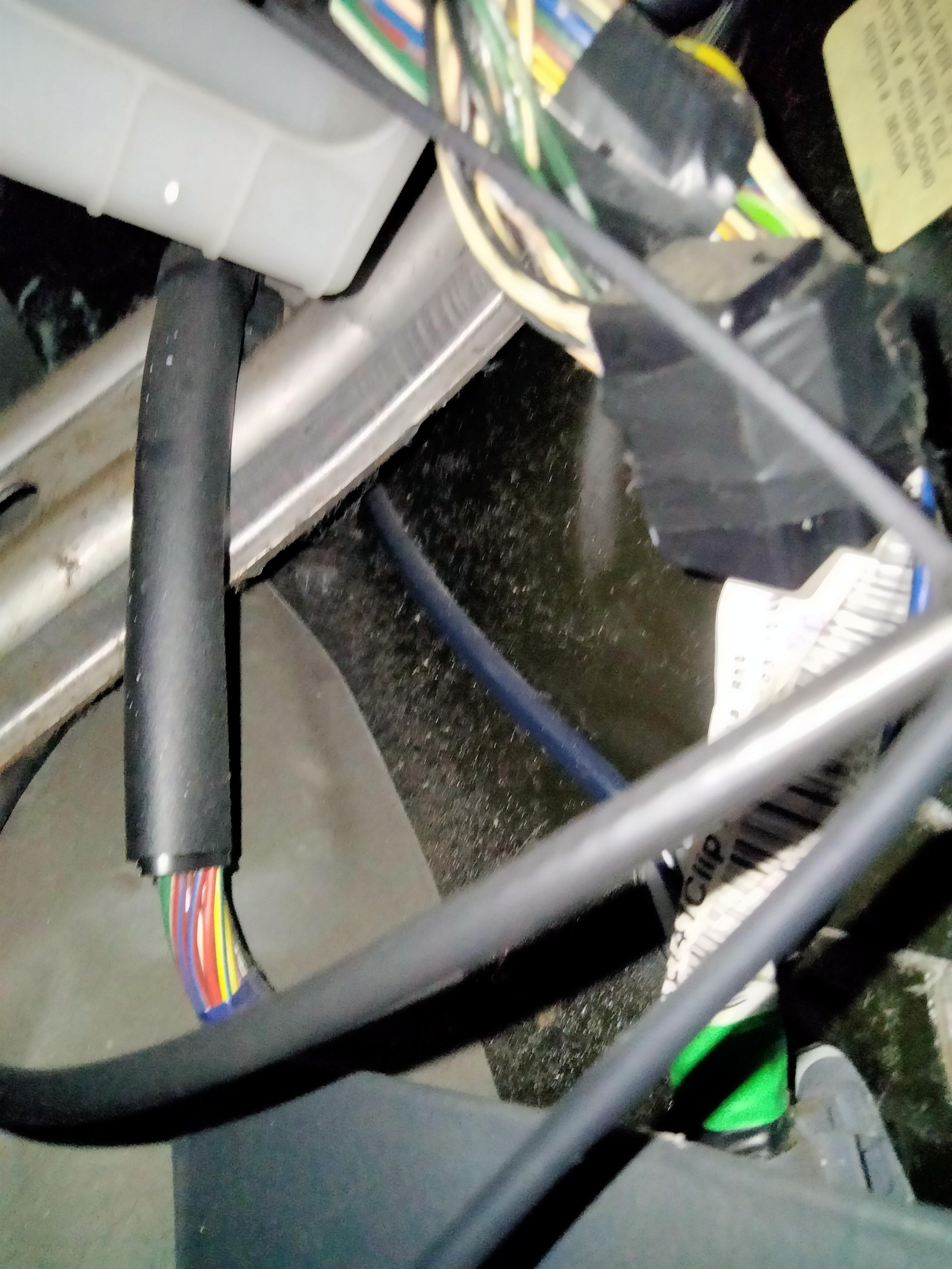

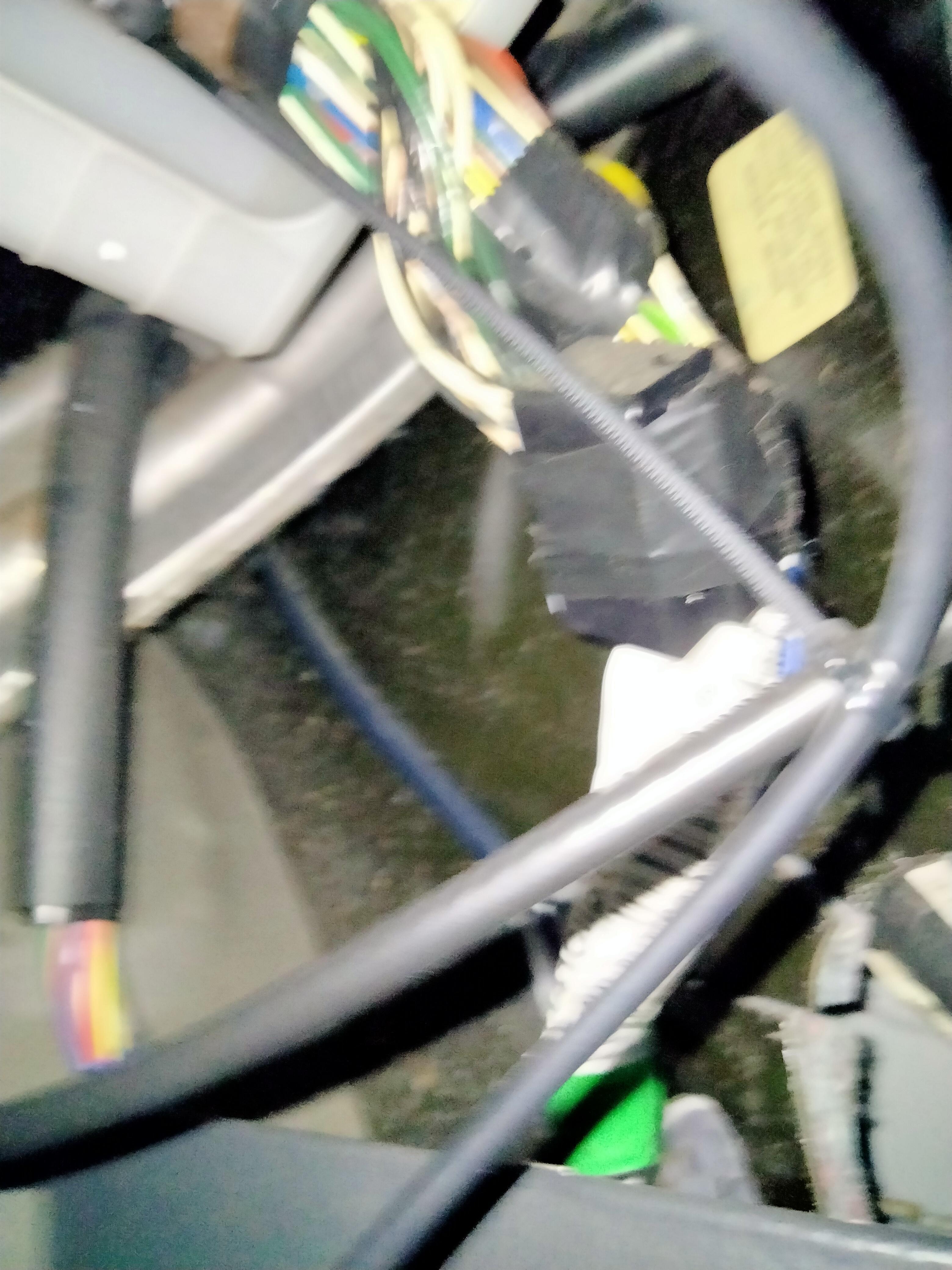

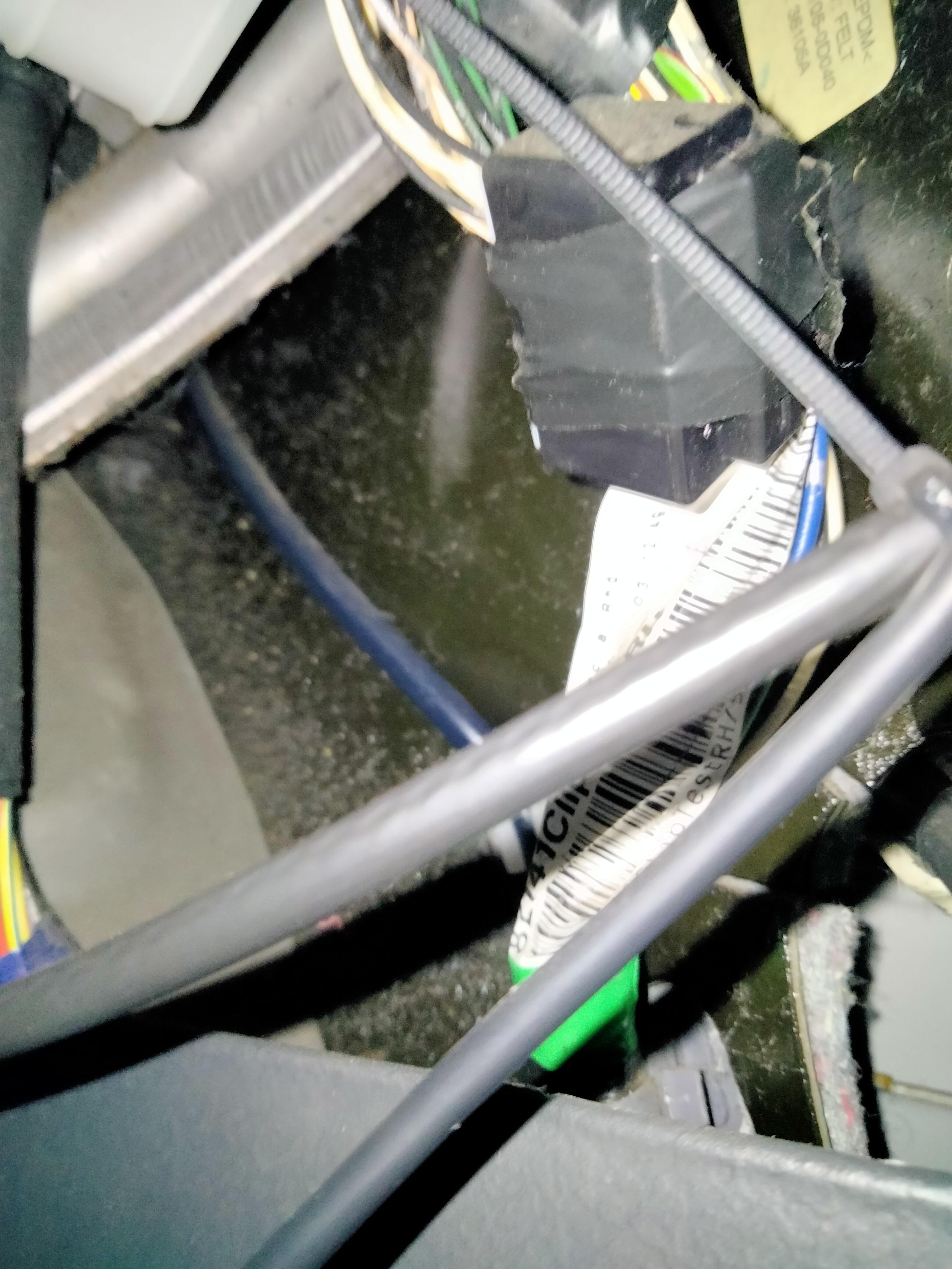

So update. I finally got around to fitting the new receiver box. Tested the instructions that was posed very kindly by Flash22 and....... nothing still. No response from the car whatsoever. But interestingly I noticed some wires at the right lower side near the A pillar looks like they have some electric tape around them. Now I am beginning to suspect perhaps someone has previously been messing around with the wires back there. I'll grab a picture of what I mean. See if it looks normal to you guys who know more about this than I do.
Pete

Ah, maybe someone fitted an alarm

I'm not sure. I can't see any indication of an alarm system. I definitely suspect someone before me has been fiddling around with the wiring behind the dashboard.

The wiring looks stock

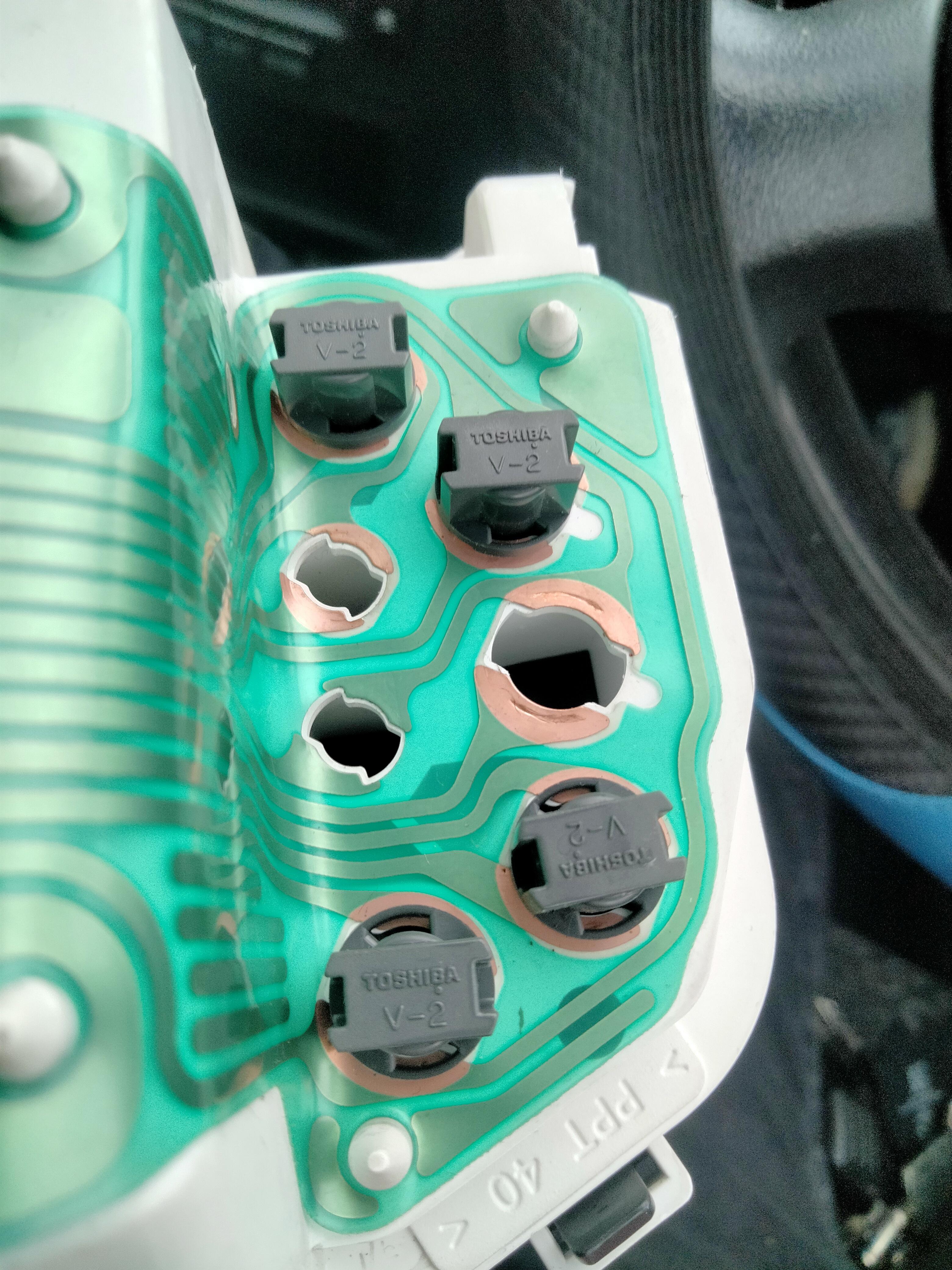

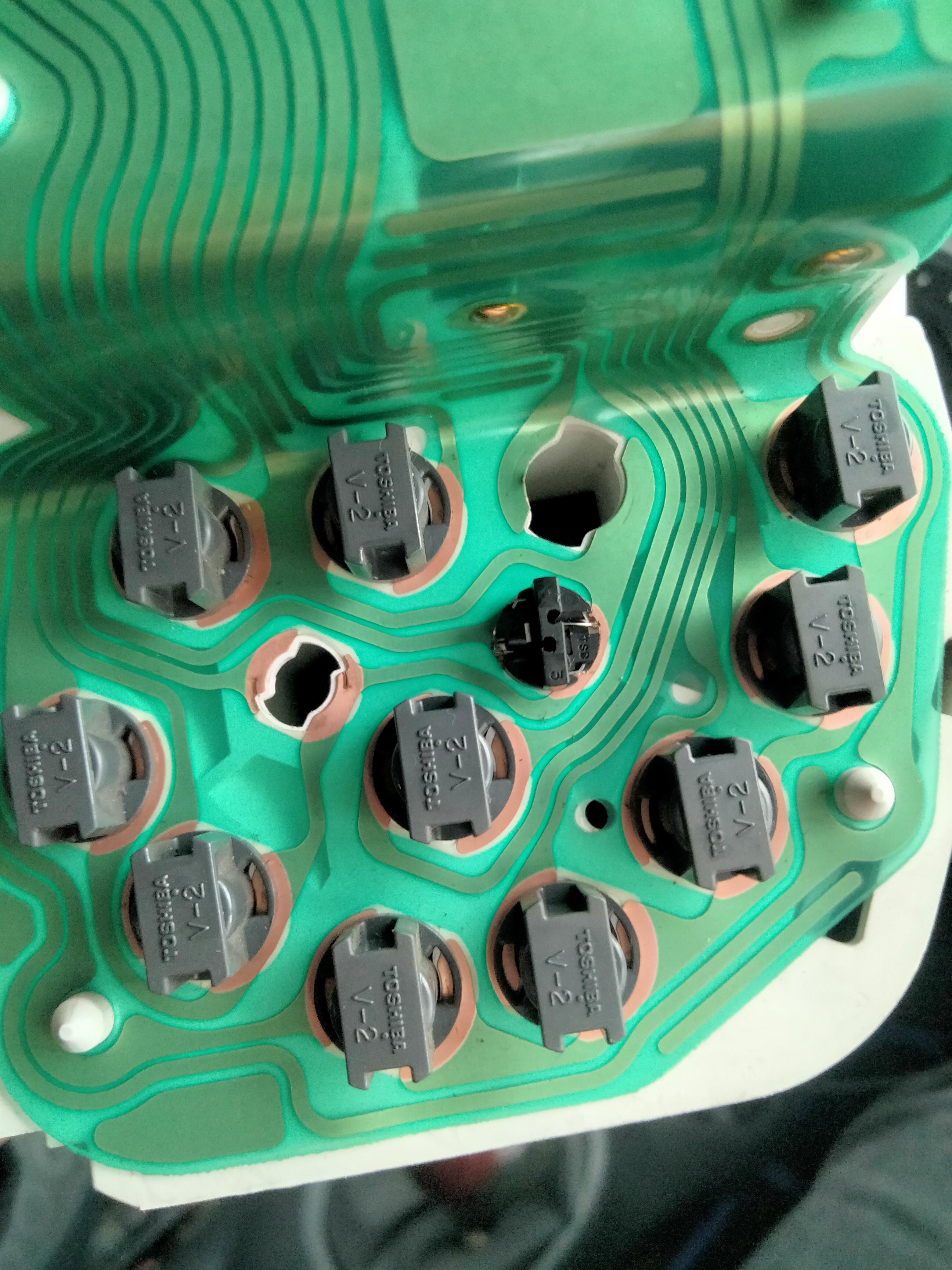

There is something I'd like to ask you fine people though, I've noticed my red temperature light on the dash has gone off completely. Won't turn on when I insert the key into the ignition. So I did some research, turns out the bulb has blown. Anyway, I've taken a picture of the bulb holders and noticed some are missing. I'd like to know what bulbs they are and if I can get hold of some holders too. I'll attach some pictures.
Any further help would be much appreciated.

Perhaps you can shine a torch thru the hole to see what lights up? Maybe for indicators for equipment not fitted?

I should have mentioned this. I did. I was able to shine my phone torch through the holes. The cluster showed the blue temperature indicator (missing) which I have no idea what bulb or socket it uses as it looks smaller than the others, and just above it is the red temperature indicator which has the bulb blown that was working this morning l. On the other side, it's the door open indicator (missing) and I believe it's an indicator for a glow plugs (Diesel) but I have a petrol engine so I don't need that.
I'd just like to know what bulb fitments I need for the temperature indicators and the door open indicator. I am a bit suspicious as to why some have been missing. This is the 1st time I've been back there since I have owned the car.

Think these are what you want.  Compare with whats fitted but they do quote a Toyota part number.
Dash bulb holders Classic Car Parts
Same company on eBay
eBay seller, 5 holders
Selection of T5 bulb sellers / colour
Thank a so much for this. I've bought some and they are on the way. I'll update when they arrive and I fit them. Do you happen to know what the smaller sizes are?
Regretfully not, it was just a Google search, i've no personal experience with these.

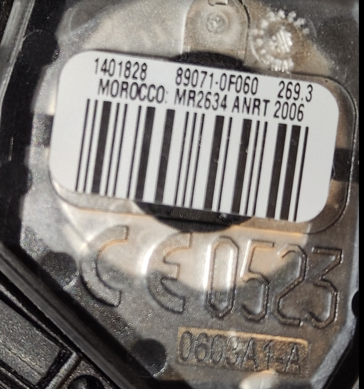

Hi everyone. *Big* update simce my last entry. I HAVE GOT IT WORKING 😁😁😁 I gave up for a while but then I decided to try again. I needed a Valeo key fob 736716-A
Tried to reprogram using the methods described. Worked 1st time. I am sooooooooooo happy it works. You wouldn't believe my jump for joy that it worked! My grey key did work for remote reprogram if anyone else wants to know.

ah you have the later fob as used on the Mk2 Yaris and a bunch of dead fobs

Oh, I forgot to add the fob number that worked for me if anyone in the future requires it....
Valeo 89071-0D030
