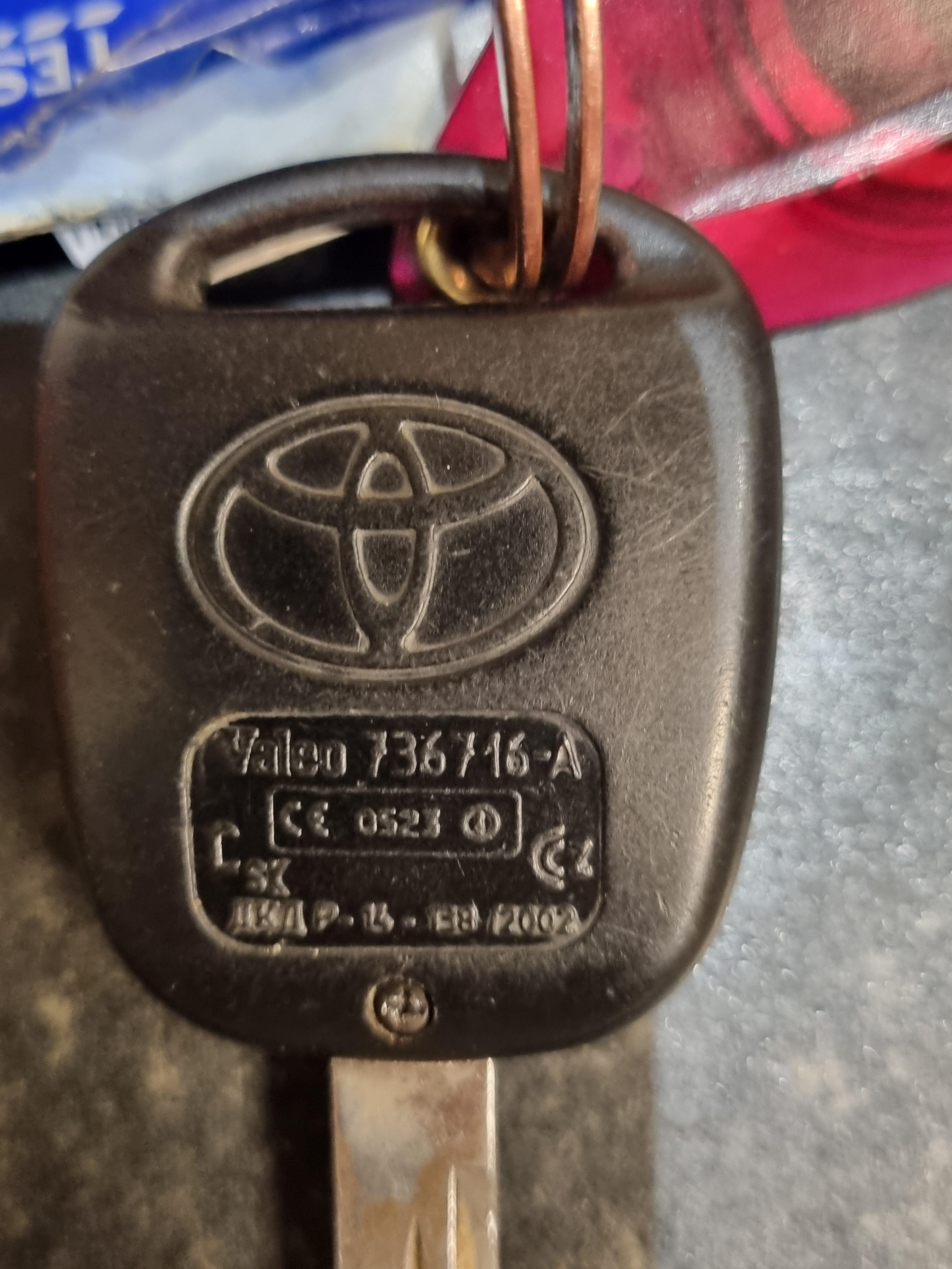

The key I have brought is used off eBay and the code on the back matches the cars original key (Valeo 736716-A)
The only key I have is a black master key with the central locking  ( the original one to the car )

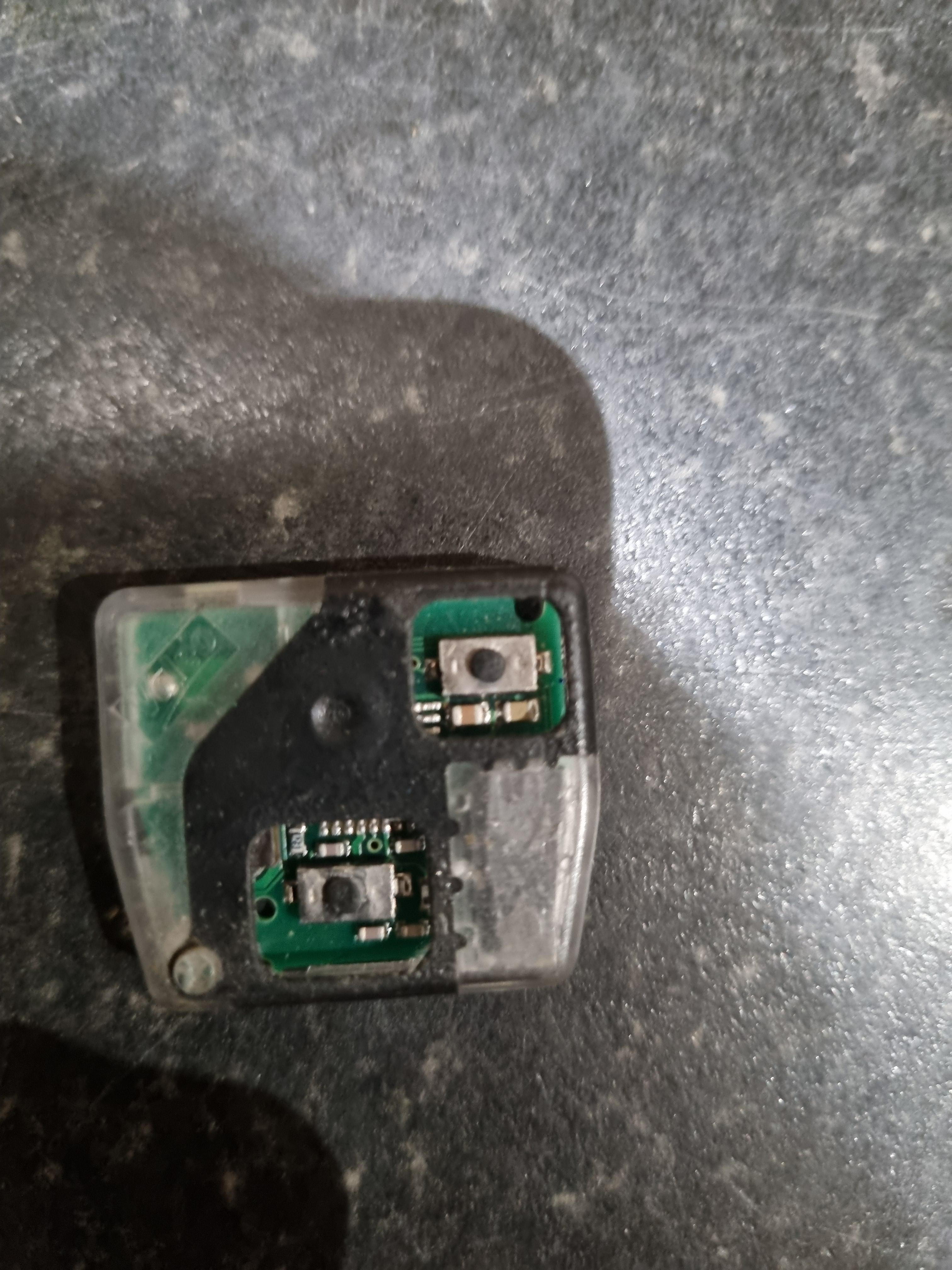

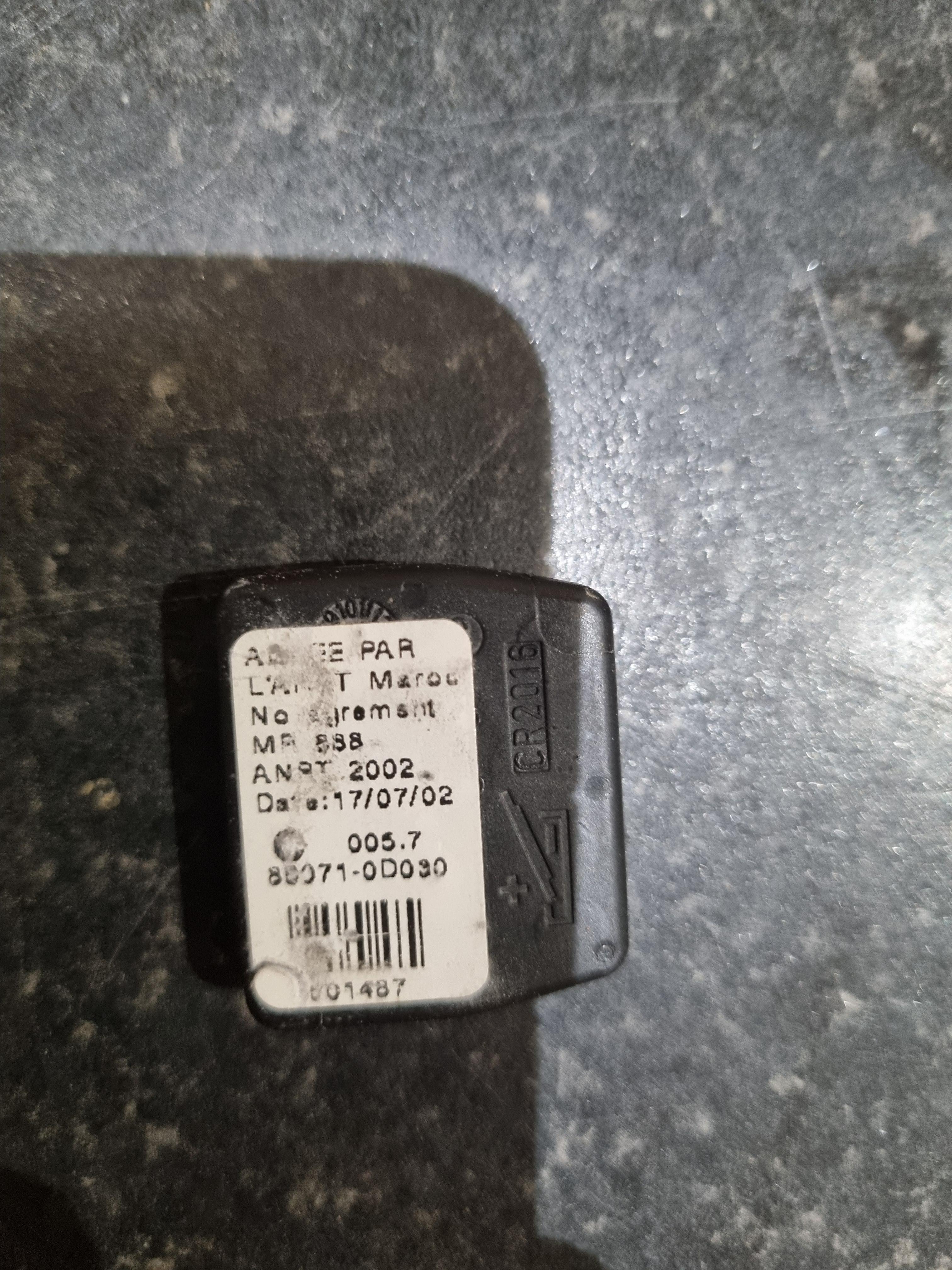

Follow the pdf, the car may have too many keys programmed, what year car did the key come from the Mk2 uses the same key but a different chip (edit. MK 1 - 4C, Mk2 - ID70)
find a decent locksmith and get them to test the key, the passive chip for the immobiliser could be duff or missing
the Battery and circuit board are for the remote locking, the passive black chip is for the immobilizer
no such thing as a clean key - the key is synced to the car via programming

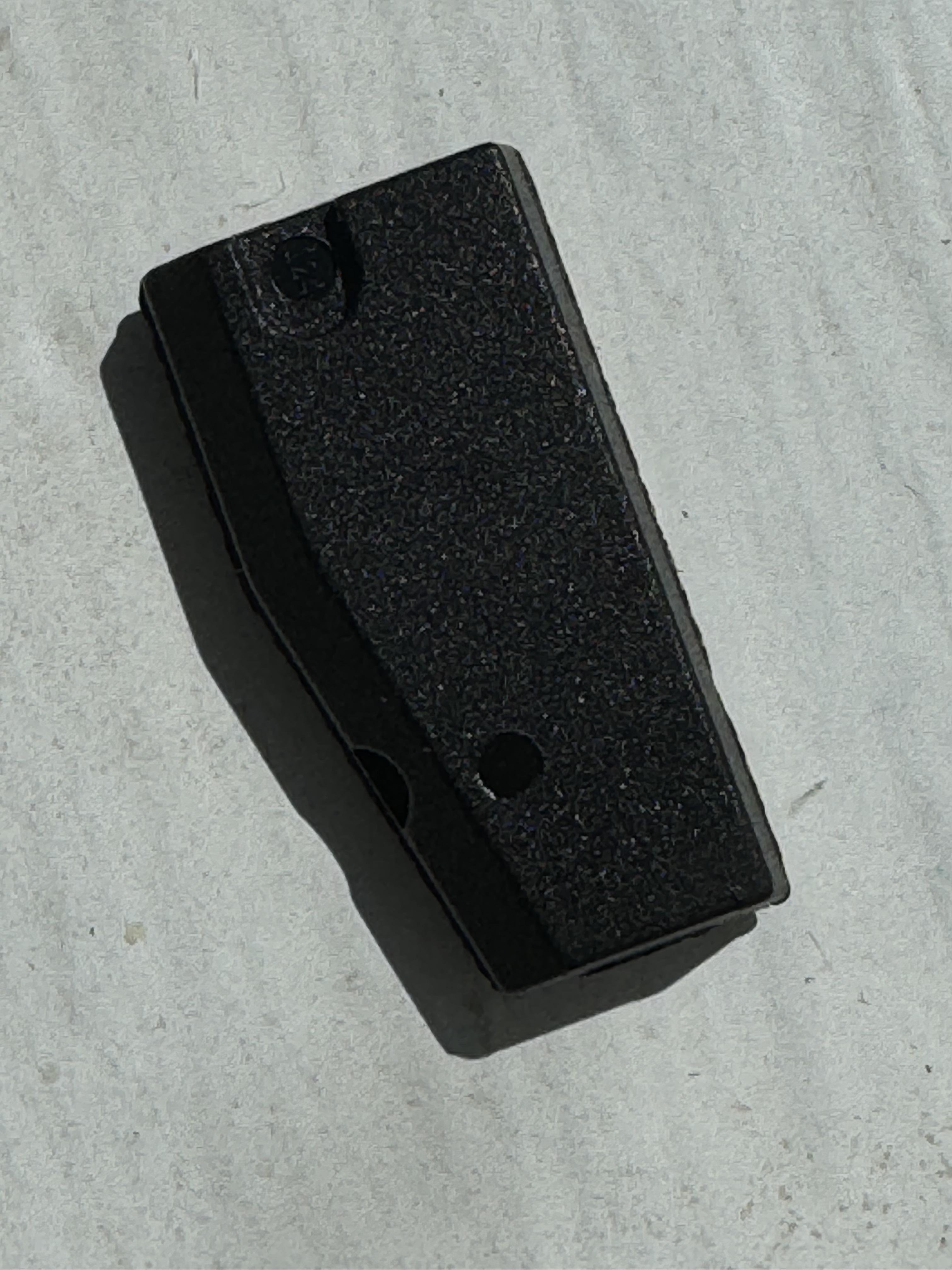

the chip is the size of a large grain of rice as per the pics on page 6

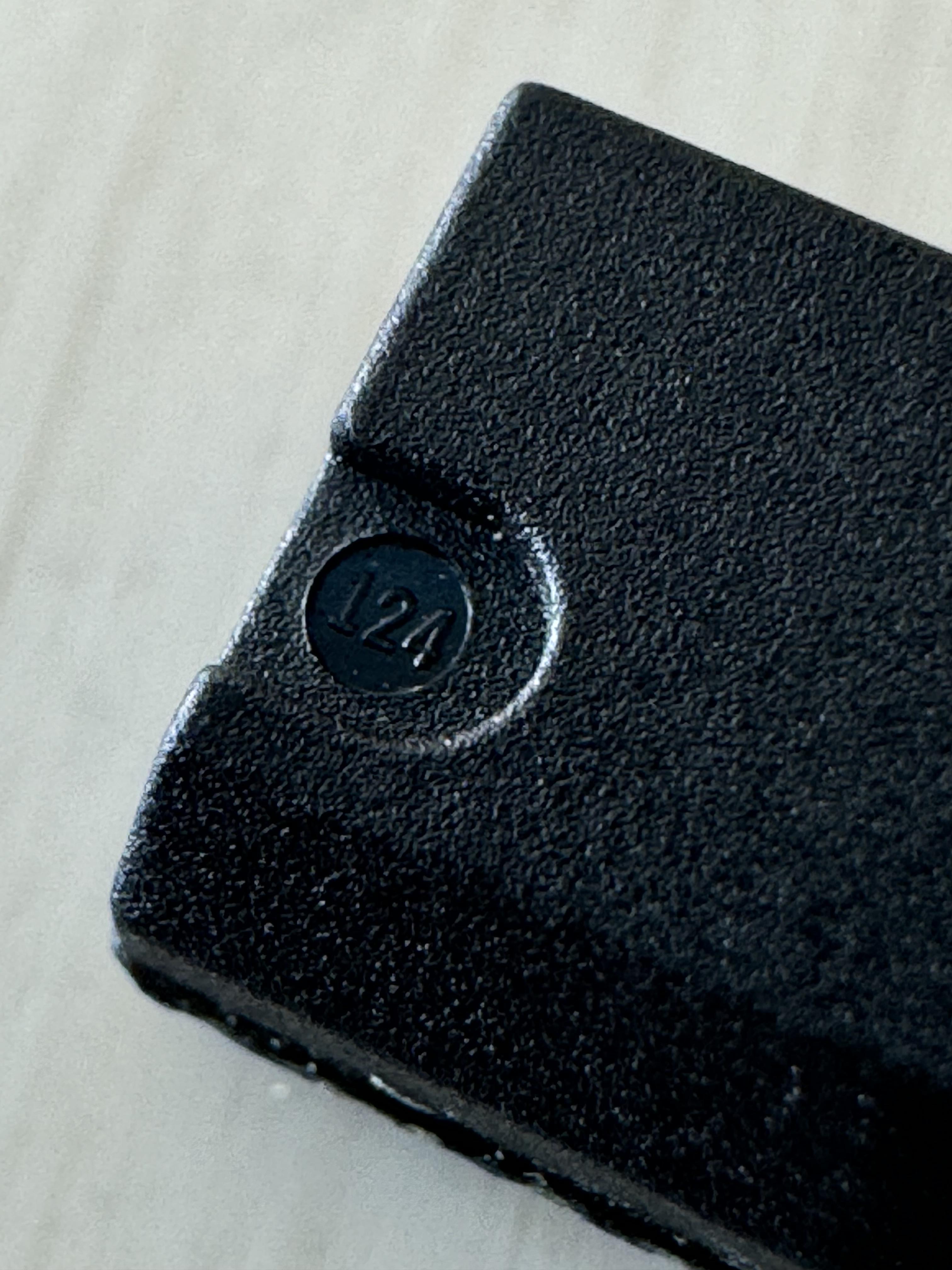

the number is on the chip itself
Thanks again for the reply flash22

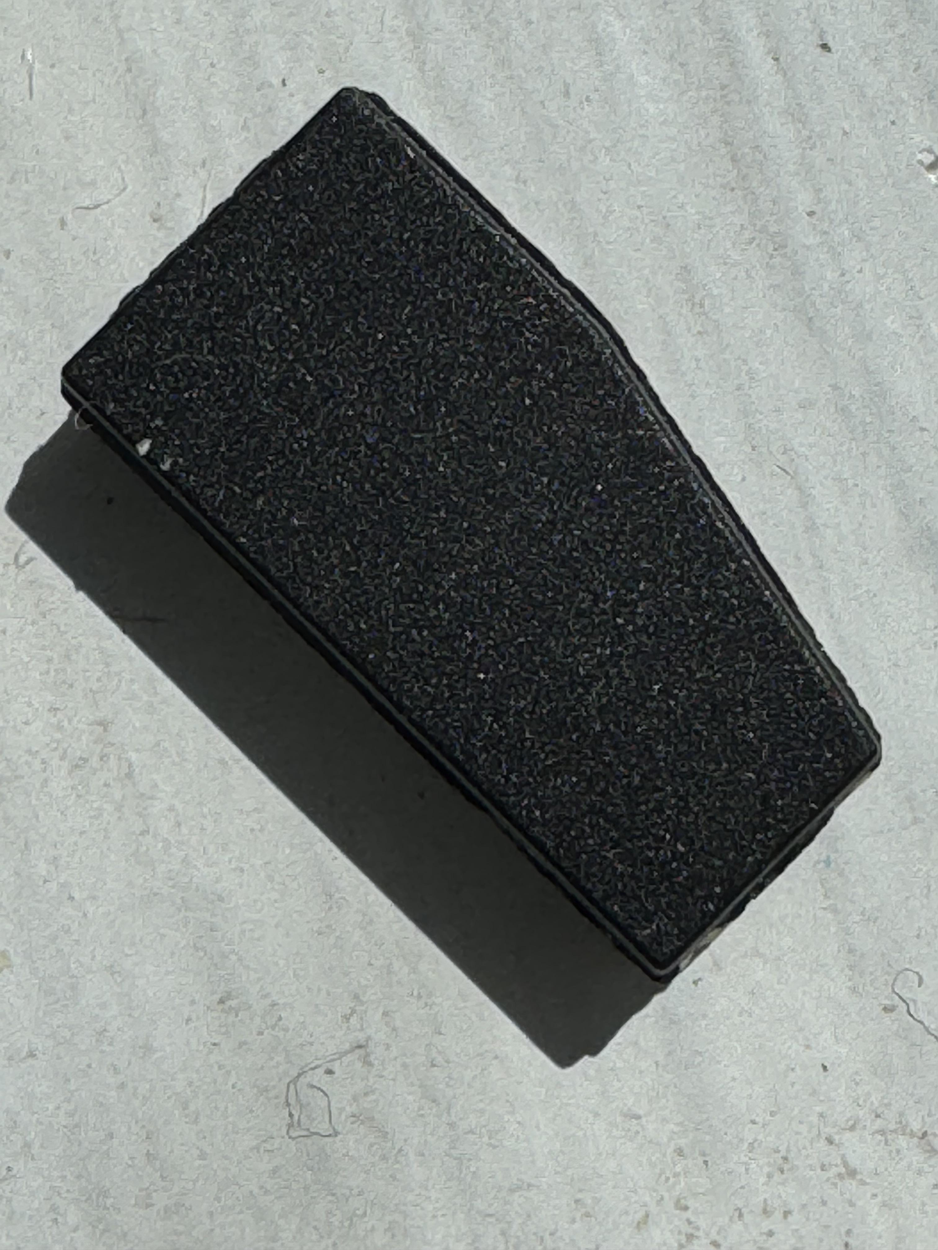

I have looked on my original master key and indeed found the chip. I however cannot see any codes on it apart from 3 numbers in a little circle.
Turns out the key I have brought on eBay didn't come with the immobiliser chip so i am guessing I need to order a c4 immobiliser chip online and then follow the programming procedure ?
You definitely need the transponder chip in the key... are you sure there isn't one in there? Seems odd to sell a key without one.

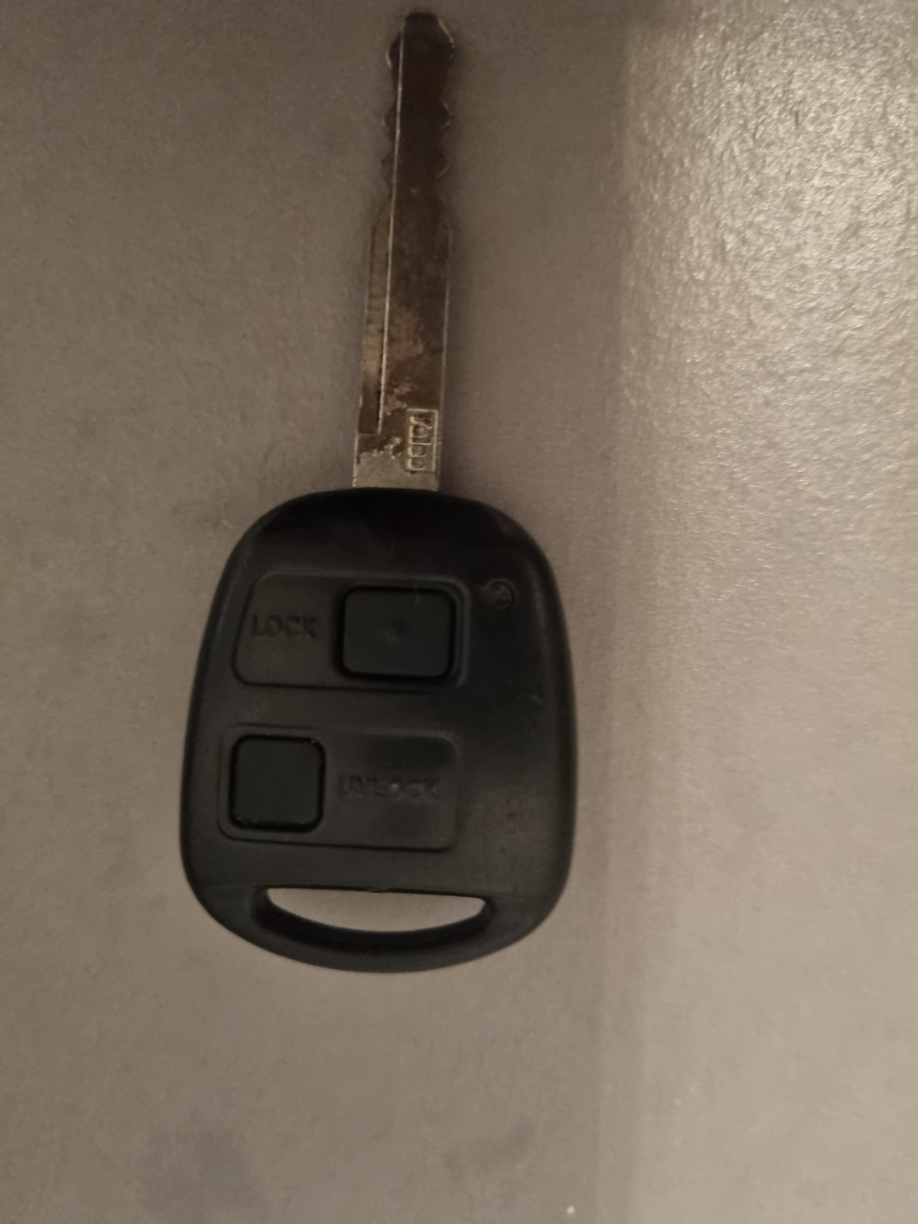

Have you got a photo of the key? if it is an original Toyota-type key then the transponder is a bit hidden
I bought a replacement flip-out type key that i was told would work, but i had to swap the transponder in from another key in the (kindly donated by a forum member) to get it to program successfully.
well that will be the reason you can't program it
Looks like that chip has been replaced in the past
you will require a 4c or ID4c chip
Precisely what Flash and boyse7en said. You need a 4C chip or ID4c chip to program the key to your immobiliser. Don't go buying cheap eBay ones either as they are fake and will not program to the car. You'll need genuine Toyota chips. You said that you have your master key so you will definitely be able to program the chips once you acquire them. Trust me, I have researched and experimented with the Yaris central locking and immobiliser system (this thread will show) for a long time to confidently say that as long as you follow the procedure further back up the forum and with the right chips, you should have no problems. Though I lack my original master key, I was able to collab with boyse7en to figure out that we needed official Toyota chips to be able to program one to the immobiliser. I hope you're able to get it working.

Hi everyone , been a few weeks but I’m back with news …
it’s works !!
a couple of weeks ago I order a new chip of eBay costing just £4. Today it arrived and I followed the programming procedure from this forum and it worked perfectly first time , you won’t believe the excitement when I saw that little red security light go out 🤣
Attempted to start the car with the new programmed key and it started right up !
Here is a link to the eBay chip I brought in case anyone else needs one ( 4c )
https://www.ebay.co.uk/itm/303248647097?mkcid=16&mkevt=1&mkrid=711-127632-2357-0&ssspo=85Dn4utpSVq&sssrc=4429486&ssuid=gm_ZrADnSH6&var=&widget_ver=artemis&media=COPY
I can’t believe all this time I had missed the actual chip for the immobiliser , I genuinely thought it was all one unit with central locking one
