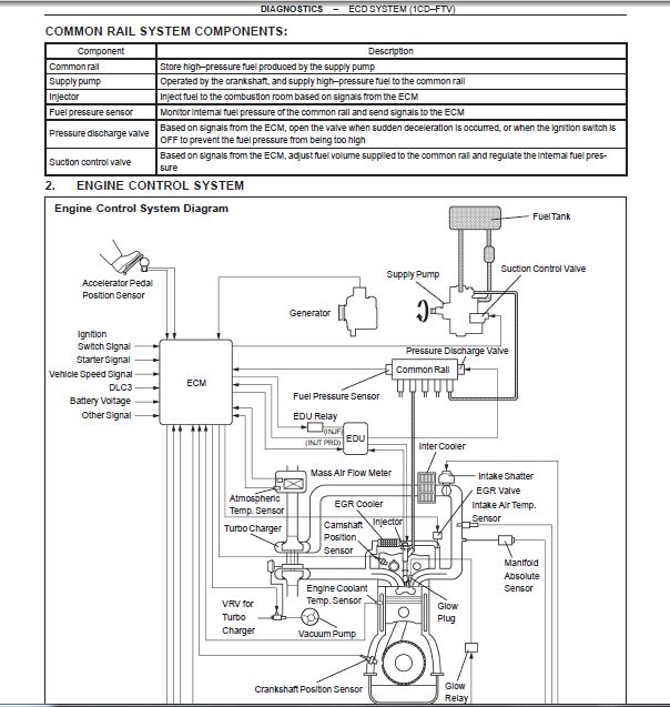

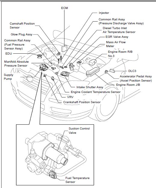

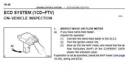

Here are a couple of diagrams of the parts to be cleaned, it's the maf sensor on the air filter.
Pete.
Pete.

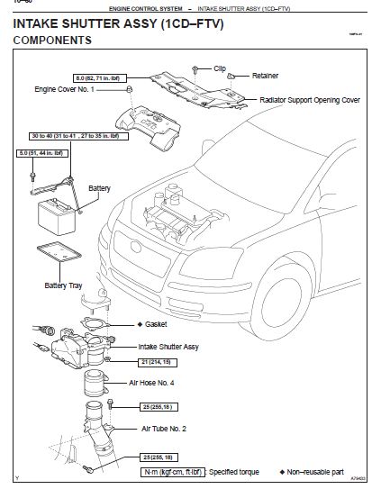

Hello again, for that kind of money i would have a go anyway, i have attached a diagram.

Hi mate, it sounds to me like the throttlebody/air intake shutter is faulty, maybe you can remove this and clean it out before shelling out for a new one, this can be linked to code PO488.
You may find it is jamming due to a sticky residue inside the throttlebody, worth a try anyway as you must have spent a lot of cash already.
Best of luck ..... Pete.:thumbsup:
Thanks for the reply, Pete!
Yes it is code P0488. Where about it is the throtllebody/air intake shutter?Is it the one on the plastic lid on the air filter?
Regards
