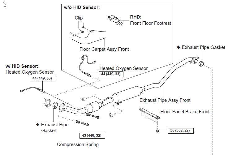

I need to change the oxygen sensor on my 2003 Toyota Avensis d4d.
Can someone please point me in the right direction as to where I can find this sensor, as have been all over the engine bay and underside and can't seem to locate it anywhere. The only place I can't really see is the turbo area due to limited access. Have I missed it or is it towards the rear between engine and firewall?

Hi,
On the 1ZZ/3ZZ-FE engines, the heated oxygen sensor is like in the below picture.

That's great - thanks for the diagram. I have a flexible pipe where the oxygen sensor should be according to diagram, but I'll look further up as couldn't get directly beneath firewall yesterday.
