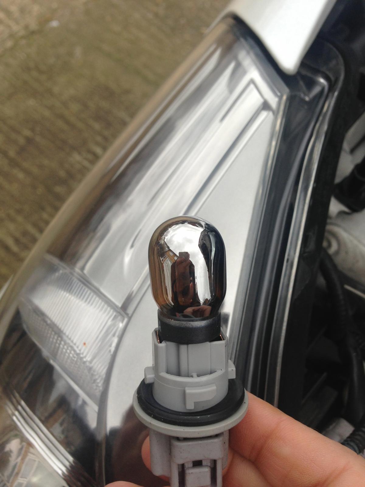

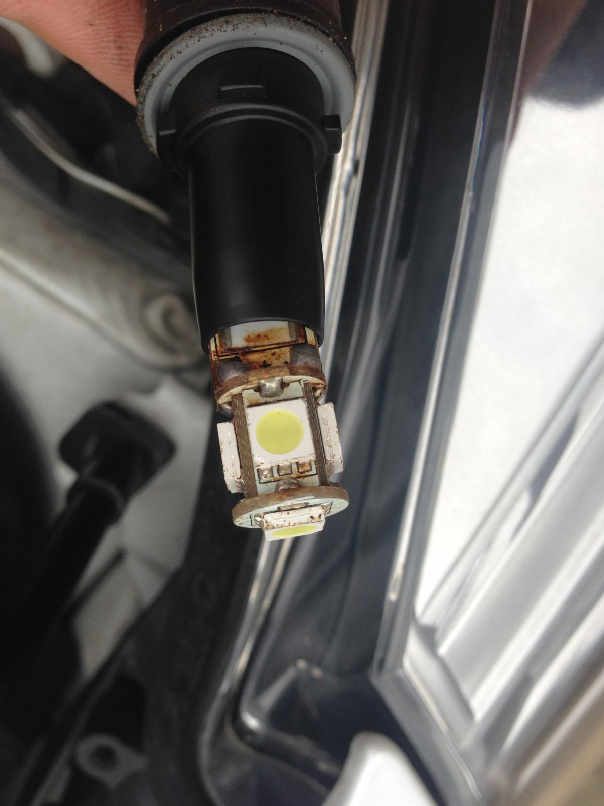

Here are some pictures The 501's are replaced with the LED's. The pic is showing fitted with 5 LED's Thought i had fitted the 13 LED version. I will do that soon These were available from eBay for £3.00. The 13 version is £6.99. Just search for 501 LED.
The Indicators are type WY21W T20 fitting and are chrome £6.90 set of 2
The main headlights are HID and are bought as a kit for around £45 again on eBay you can easily swap between the HID and normal bulbs for the MOT . fussy MOT station will refuse to test as the car doesn't have auto adjusting headlights and no lens cleaning device fitted which is a requirement for HID

Nice one. Do I assume you replaced the front indicators with silver lenses to make the bulbs shine brighter and at standstill don't have the orange tinge?
I did a quick search for 13 version 501 LEDs on eBay, are these the ones you are talking about: http://www.ebay.co.uk/itm/2-x-ERROR-FREE-CANBUS-W5W-T10-501-LED-SIDE-LIGHT-BULB-Xenon-White-13-SMD-/321313712389?pt=UK_CarsParts_Vehicles_CarParts_SM&hash=item4acfca2905 or different?

Yes those are the ones. One thing to remember, they maybe polarity conscious being diodes. So if you buy and put them in and they don't work, just turn them around in their holders. You may find one will work and the other not, just turn the non worker round.
The indicator bulbs are silver/chrome to mask the inner amber coating and work kind of back to front so as you say at stand still you don't see the Amber or fried eggs as some people call them, They are no brighter.
