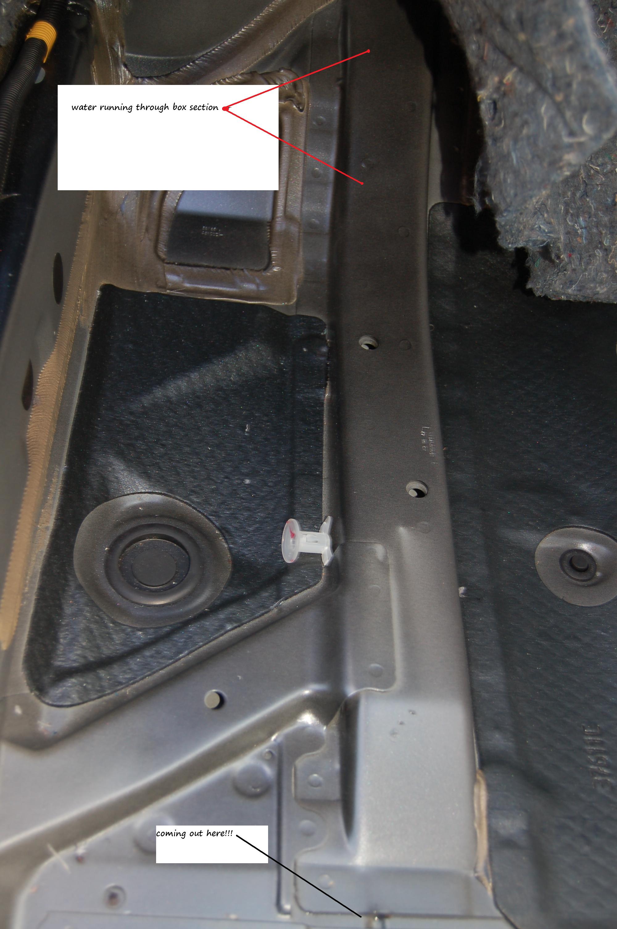

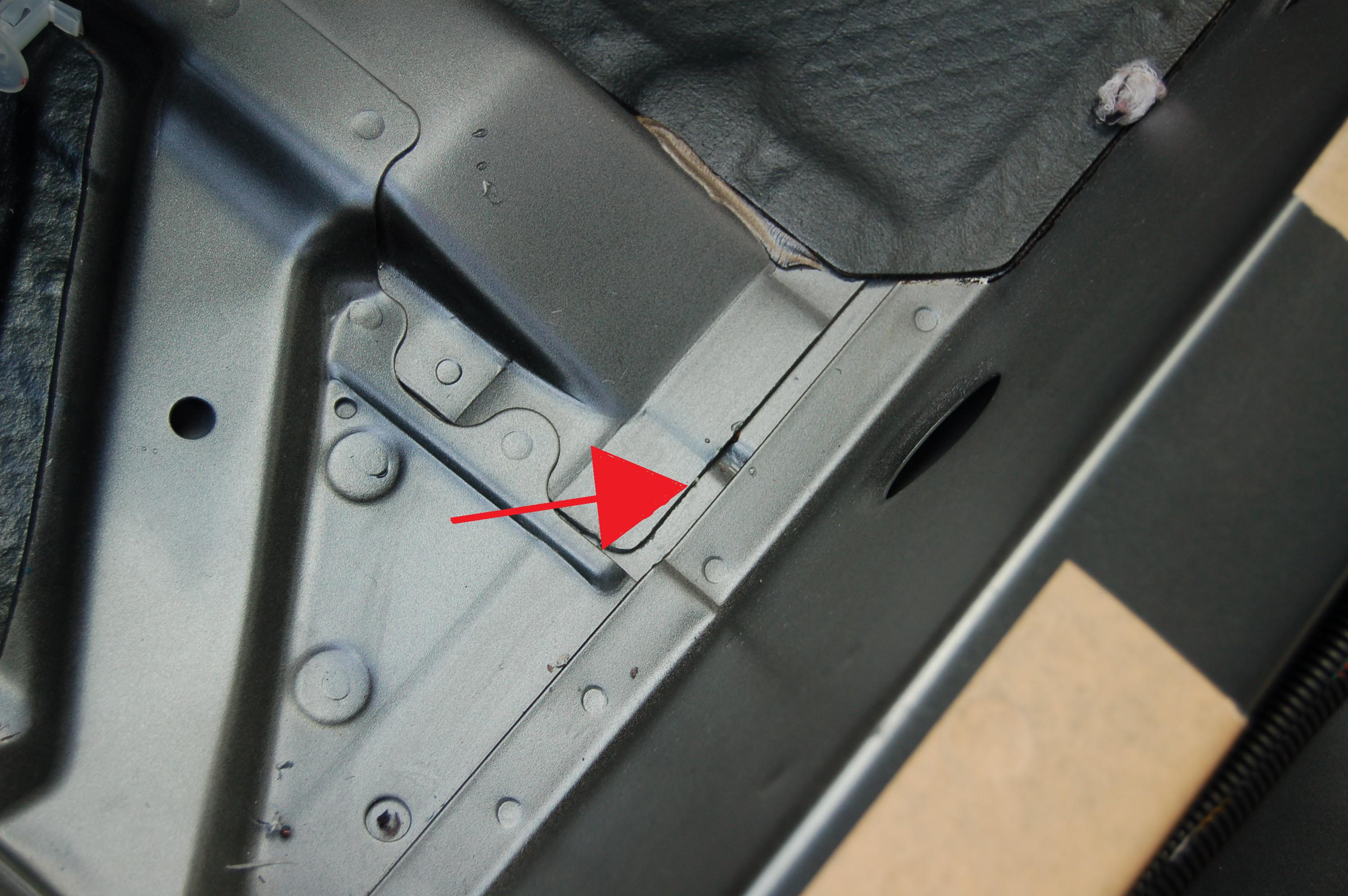

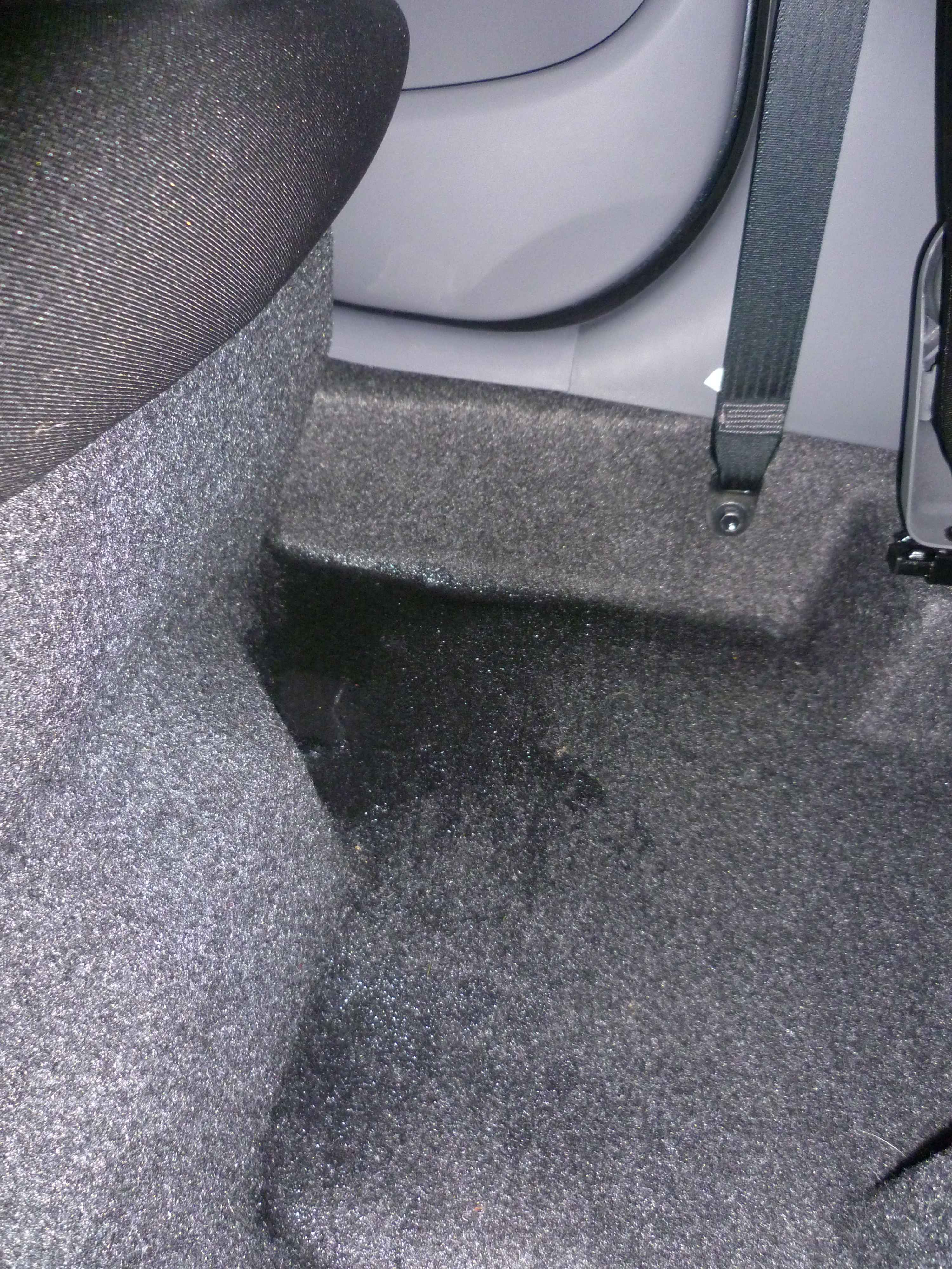

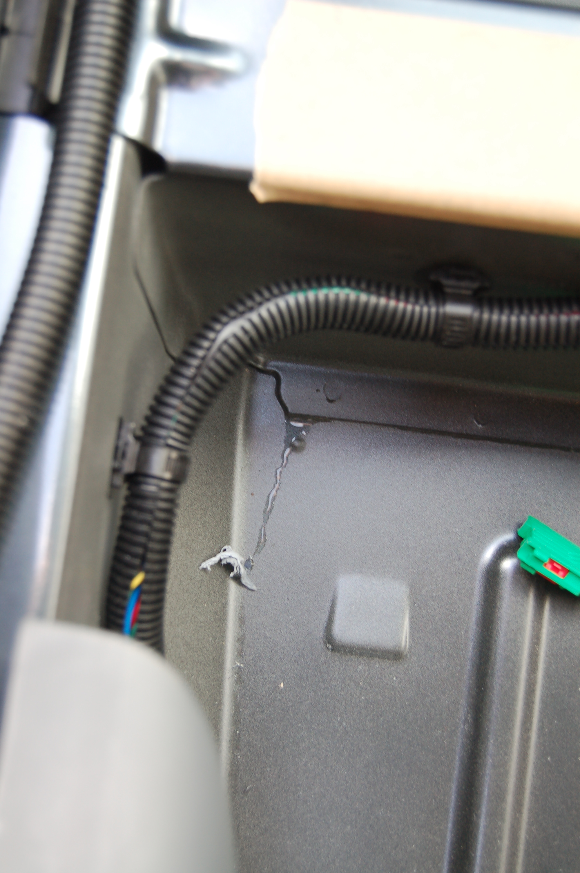

Hi,
We have a brand new Aygo GO 60 plate 5 door, which is just over 3 months old and it's leaking like a sieve (rear L/H foot well#.
So far it has been back to the Toyota dealer 4 times and is currently residing there for the last week. So far they have replaced a set of door seals and a bung in the boot and given it a respray after they scratched#butchered# one side and ruined the seats with door seal mastic.
After it returning home "fixed" for the 3rd time, I sat in the car when we had a little shower and after 5 minutes could feel the water coming in under the passenger seat on the back edge of the lateral strut.#through a flap in the carpet#
cue another phone call to Toyota whilst sitting in the sinking Aygo... :help:
So now after a week with team Toyota,they phoned and said they are unable to find the leak after hours of "testing"...
It was suggested that our car be parked on our drive and water tested, So today they came with our little stripped out Aygo for a flying visit, Anyway after 10 minutes with the hose I could see the water trickling in and witnessed the water filling up the back foot well quicker than a sinking ship.
The water is travelling from the front bulkhead #passenger side#under the box section that runs from front to back#its welded and sealed to the floor pan# and under the lateral strut #which the front seats are bolted to#then it dribbles out of the box section at either end and then straight onto the rear carpet.
The question I have is: how can water pass through what appears to be a solid bulkhead?? Is there a bung missing?? is it magic??
There is no other way in....SO now we wait to see what the fix is,It could be something very simple on the other side of the bulkhead but me thinks its a manufacturing fault... Anyway, I will update when I know more..
