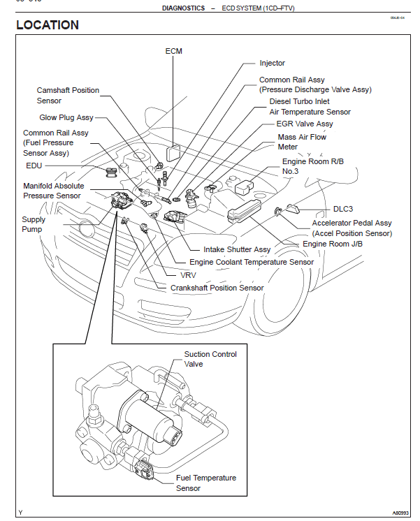

Is there a way to check SCVs without any special equipment? I know the location of one of them, where is the other?

they are (SCV) both on the pump body -- each one's solenoid coil must be measured on resistance by means of multitester or so. as to air escaping -- you did not mention whether or not you ve released an air escaping screw before priming this membrane -- if not the air is still in the system even minor part criating headache at idle.

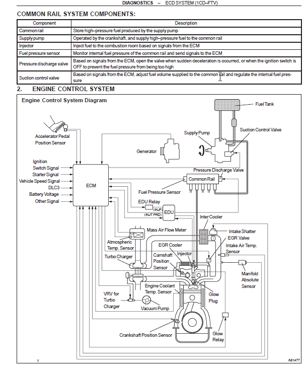

Hello again, I have attached some info on the MAF and intake shutter, if you don't already have it maybe it will help you.
EDIT:- attached more info.

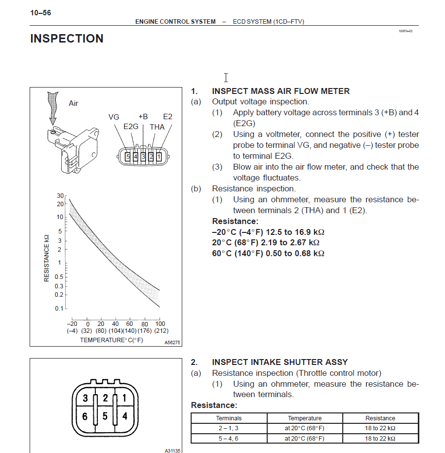

I disconnected the MAF and took it home. The resistance was supposed to be between 2.19 and 2.67. After several measurements the resistance is about 2.08 ohm at room temperature. That should be near enough, right?
Now I need to check if the voltage changes when blowing into the MAF. One silly question: it says "apply Battery voltage across terminals 3 and 4". Should I connect the plus to both of them or plus to one and minus to the other?
Now I need to check if the voltage changes when blowing into the MAF. One silly question: it says "apply battery voltage across terminals 3 and 4". Should I connect the plus to both of them or plus to one and minus to the other?

Please check the file Pete attached th other day:

OK the Battery has six cells and the voltage is normally taken from a boarder cells (+) and (-) to have a voltage from a full Battery volume. now you should conside two cells belong to Battery and take full voltage criated from them (two cells). but i am thinking how will you take this in cacsce the battery is service free :crutchy: -- let's wait for other posters -- may be i ve explained incorrectly . cheers/Igor
No, sorry.
You will have to realize that you are working with very sensitive parts, that have very little margin with the reference model programmed in the ECM/ECU.
The manual says: resistence must be between 2.19 and 2.67 kOhm.
If not, replace the MAF.
You are diagnosing a possible MAF related problem here, so if you measure a value of 2.08 kOhm, it is below the minimum reference value and needs to be replaced.
Repeat the measurement with another Ohm meter at 20 degrees if you like, and if the reading is out again, you may have found the cause of your problem.
Going further down into the diagnostic flowchart when you find a value that is out of spec, is pointless because you will either draw the wrong conclusions or never find the problem. :(
And to your other question:
"Battery voltage" is 12 Volt DC, as you would take from the car's Battery.
Simply connect "+" to one of the terminals and "-" to the other, both as instructed by the manual, blow air into the MAF and watch the voltage.
If the voltage does not fluctuate, the MAF sensor is defective.

Hello again, don't want to step on Igors toes here but anyway you need a 12vdc source near to where you are testing the MAF so maybe bring in a car Battery, your old one will do and make up 2 leads from light guage wire that you can connect to the terminals 3 and 4 as per diagram. It is better to have them connected to the maf first to avoid short circuit from the Battery, it won't matter which is (+) and which is - then connect the multimeter ( set to the DC Voltage range) as shown , (+) probe to VG and (-) probe to EG2. Carefully connect the 2 wires coming from pins 3& 4 on the maf to the Battery terminals (+) & (- )and read the multimeter voltage ..... then blow onto the maf as shown and watch for a variation to the voltage reading this will prove the maf is working.
You should also do the resistance readings later after changing the multimeter over to ohms range.
Just a word of warning ... if you don't you put an inline fuse in circuit do not let the bare ends of the 12vdc supply in the test wires coming from the battery touch together as they will melt in your fingers causing a very very bad burn!! (You don't need the inline fuse if you are very careful).
Come back to me if you don't understand any of this.
Hope this helps ....Pete. !

Now I'd like to inspect the SCV's.
I understood there are two of them(?). I can see the one in the pics on this topic, but where's the other?

Sorry, don't want to be rude, but you still don't get it...
You measured a way out of range value of 2.08 kOhm on the MAF (which indicates that you found a- or the problem; the MAF is at fault).
But you ignore that and continue looking for a problem that you do like?

Because.... it makes no difference if you drive your car with a defective MAF with- or without the wires attached.
In other words, it's defective with- or without the wires attached and therefore you'll notice no difference.
The diagnostics flowcharts referred to above, and from which several members quoted, rely on taking the prescribed action if one of the steps give an incorrect result or an abnormal reading.
In this case: "MAF resistance readings out of spec": --> Replace the MAF, repeat the measurement and if OK, continue with the next step.
"Assuming" such findings are still "a little bit correct", and going to the next step is pointless.
You may never find the real problem and end up drawing the wrong conclusions further down the chart, replacing parts that are not defective, and so on....
In the end, after spending a lot of time and money, you'll give up and turn to a Toyota dealer to get it fixed. :(
These diagnostics flowcharts were specially develloped to rule out the guesswork.!

Here's an update:
I borrowed a MAF from my friend's car -> did not help.
I bought and installed a secondhand SCV -> did not help.
Car does not start at all now! When I turn the key it almost starts after two seconds, then the starter only runs but it will not start. If I try to turn the key again, same story. The fuel will not go into the cylinders for some reason.
Now I'm getting desperate since I'm rather short with money and cannot afford to take the car to Toyota service.
