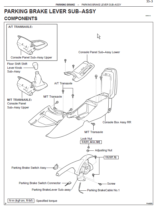

Hi does anyone else have problem of handbrake light coming on and off while driving?
switch needs adjusting.
Sounds like a faulty switch to me...
Thanks all will get it looked at.
Edit:- sorry I may have put this picture in the wrong place but it should help you to locate the handbrake dash light switch which may be loose or the cable adjustment needs backing off, Pete.
