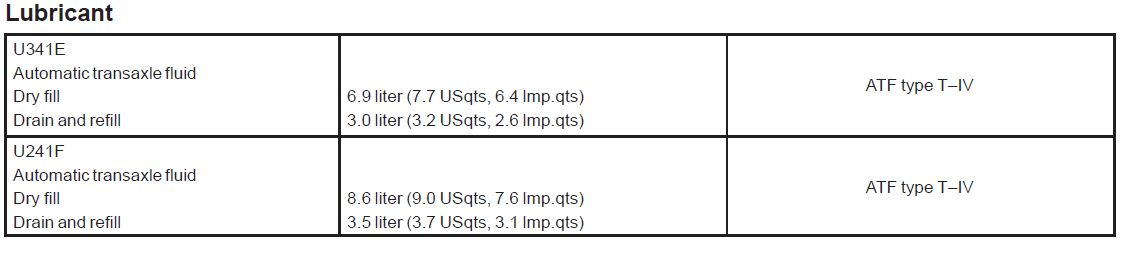

Hi John welcome to the forum, I have attached a file in regards to the transmission fluid.
Regards Pete.

Hi Pete
Thanks for getting back to me so quickly.
Excuse my ignorance but can I use either of these lubricants in the volumes described or is
one more suitable than the other.
Regards
John

Hi John, both fluid types are the same .... ATF typeT- IV so that's OK, the other numbers mentioned (may) refer to the gearbox type but i'm not 100% sure on that one.
Pete.
Edit:- John take a look at this to ID your transmission http://mr2.phpwerx.n...ntification.pdf
it will be U241F or U341E it shows where the ID is on the box.
Apart from the advice already given on ATF fluids, capacities etc, you will find that the vehicle will lurch when it is started from cold due to the "cold start" running the engine at much higher revs until it gets warm. Where I live on a slope, after starting, I let the car roll to about walking pace & then select "D (drive)" to lessen the lurch that you rightly describe. With the fluid level check, are you checking with the engine running, very important? The most accurate readings will be obtained with the fluid hot after at least 30 mins driving.
