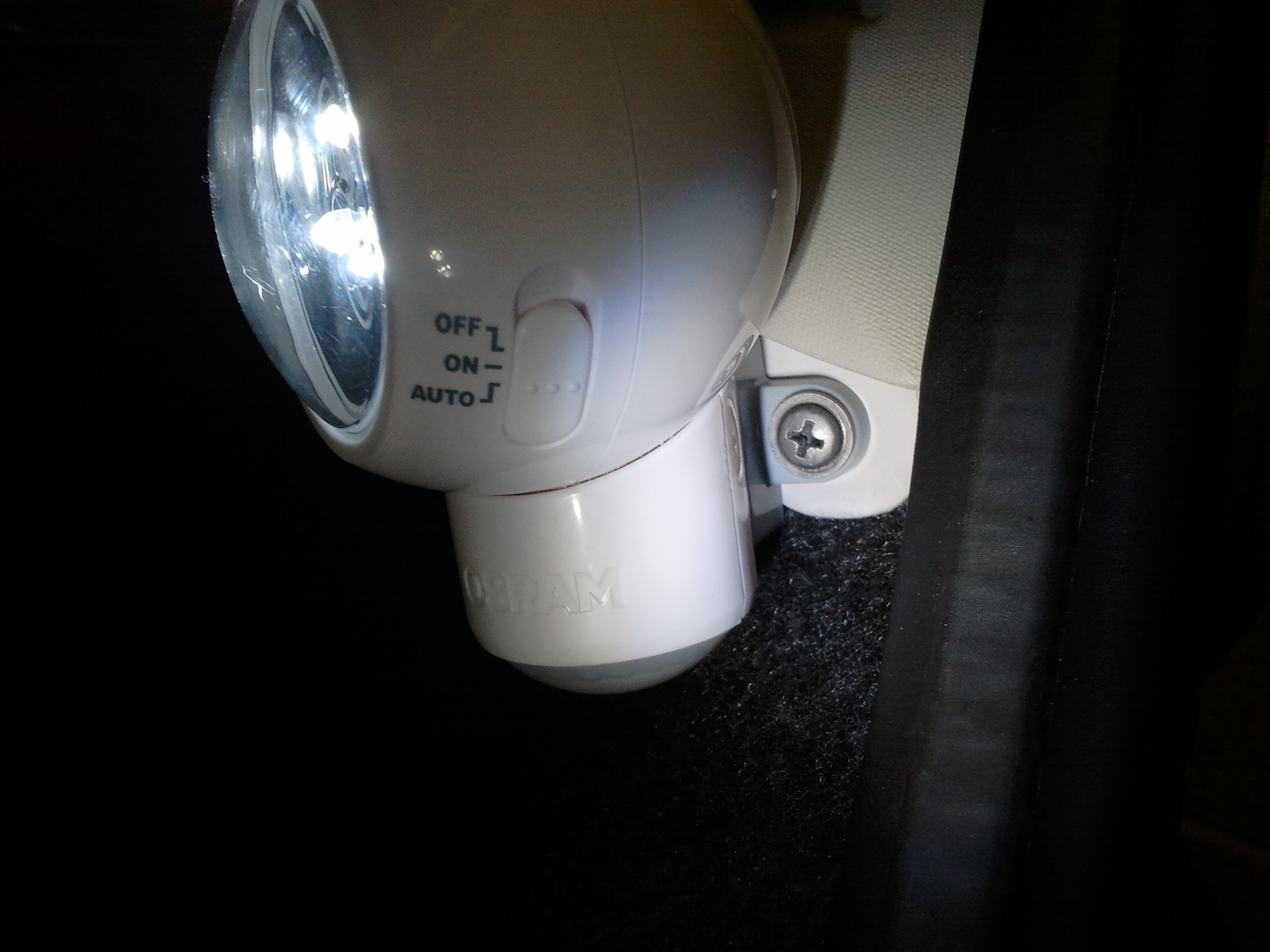

Ideal retrofit boot light for Toyota Aygo
http://www.maplin.co.uk/spylux-pir-activated-led-lighting-400170
NO NEED TO DRILL OR ALTER THE CAR, NO WIRING 3 MINUTE INSTALL.

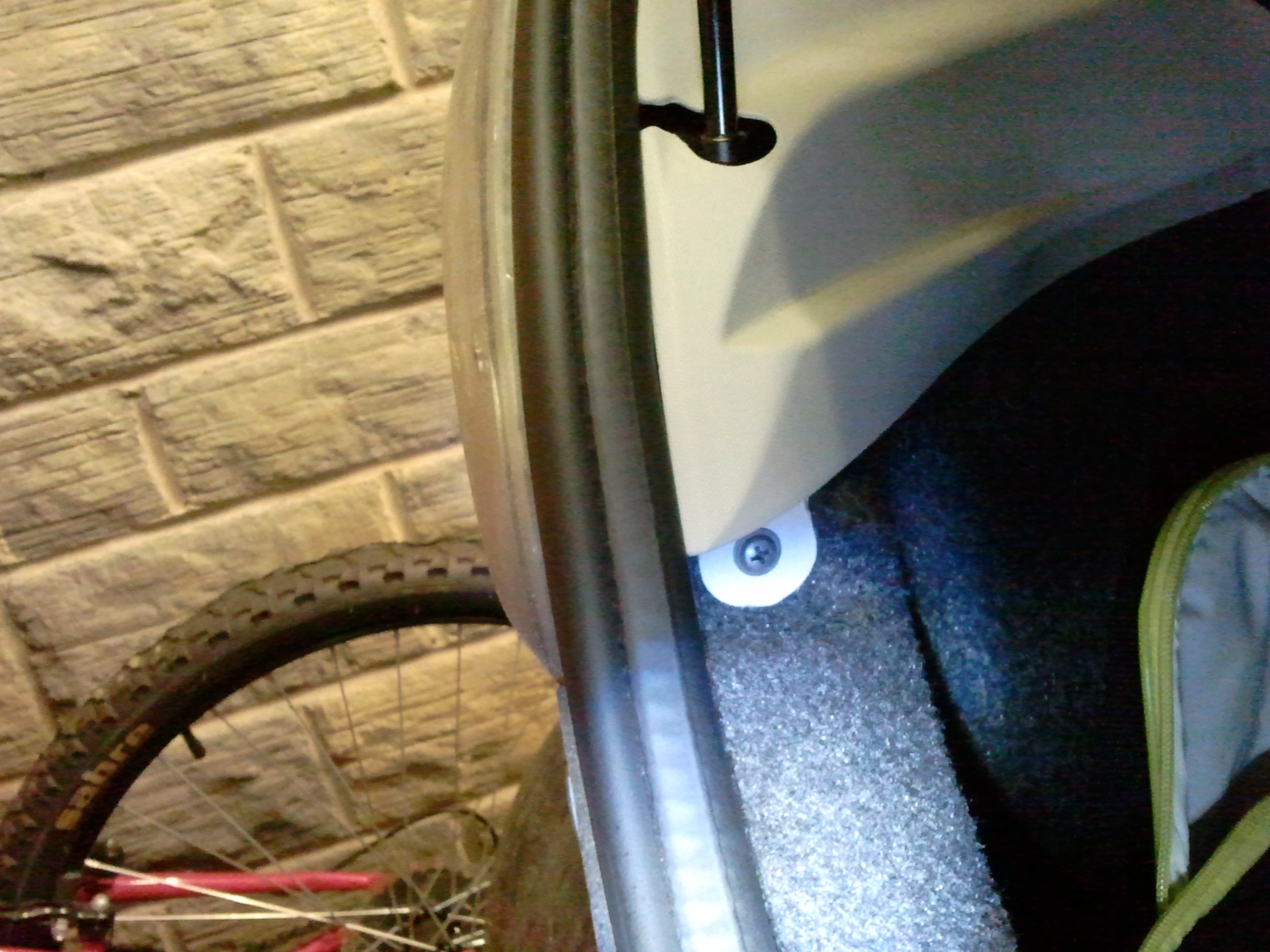

Simply drill the LED lights screw mount point to expand it slightly with a 6mm drill bit to the size of the existing car screws. Then no need to drill car or anything! Simply unscrew one of the existing screws inside the tailgate as
in the picture and mount the light directly onto the existing screw.
It's an LED light so Battery wont need changing often. You can still get access to the Battery compartment without having to unmount the light.

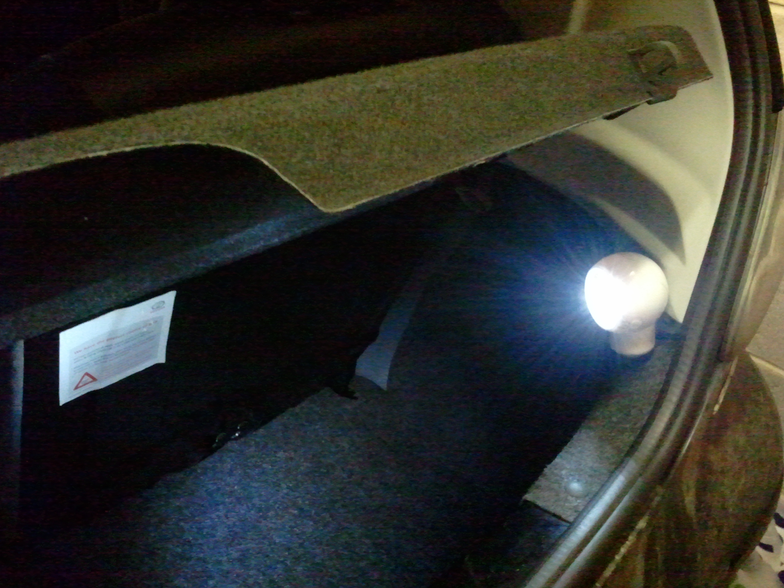

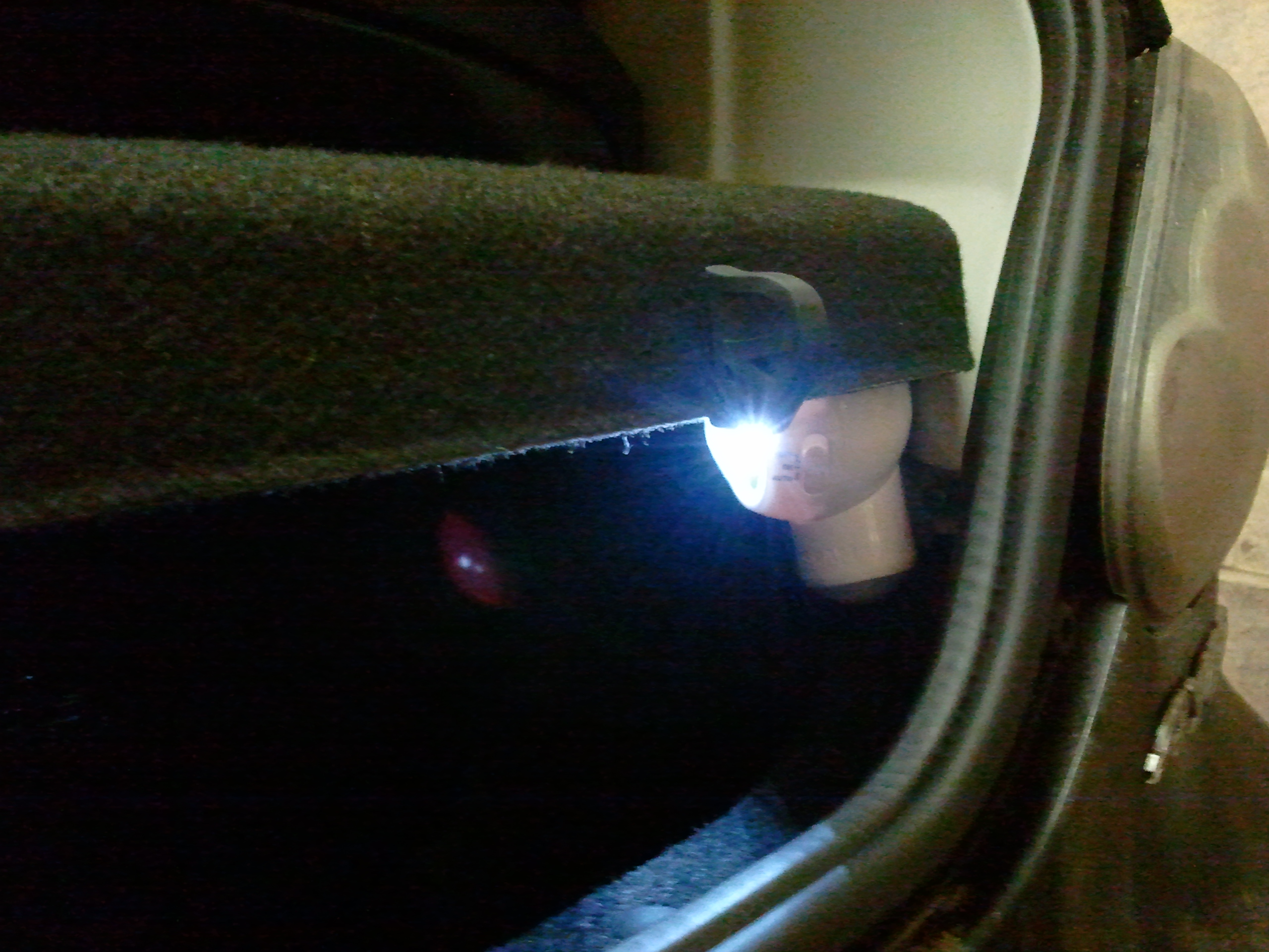

Fully automatic when you open the boot door the light instantly comes on an stays on for 10 seconds (adjustable) after any rear door open and any subsequent movement detected within the vacinity via PIR motion sensor.
This lamp mounts in the perfect position so when the shelf drops down as you close the boot the lamp is well bellow the level of the shelf.
Brilliant neat,easy effective solution to the annoying lack of a boot light on the Toyota Aygo. See the pictures and link.
