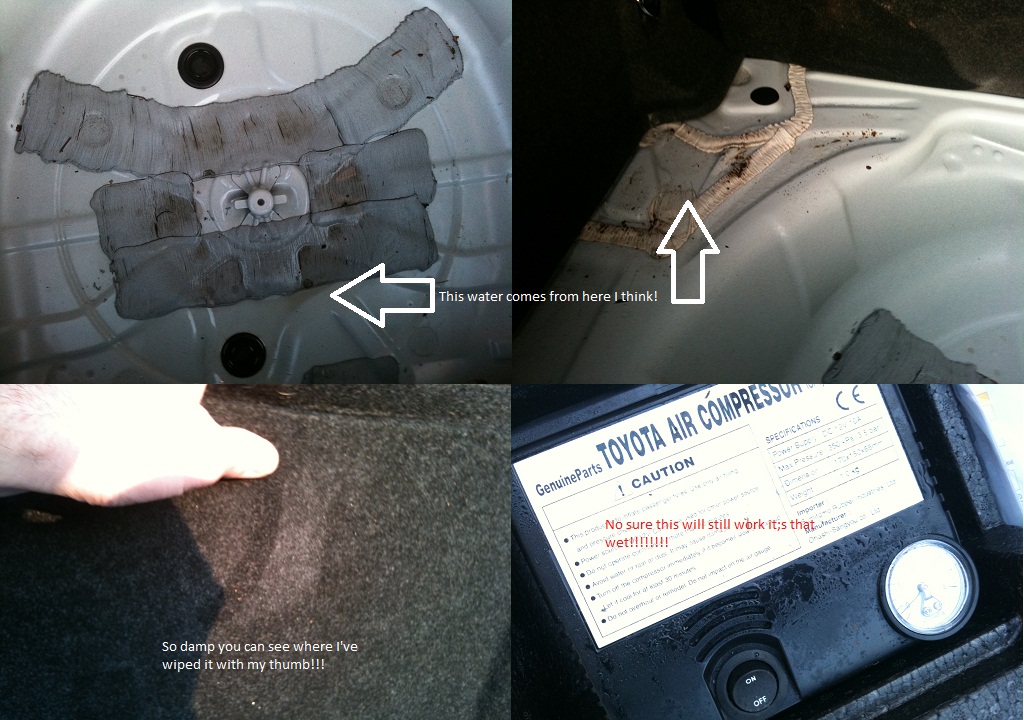

I sort of forgot about it for a while, but having recently been enthused by the thread I took a look... See below! It's not sorted, a call to Mr T is on the cards.
