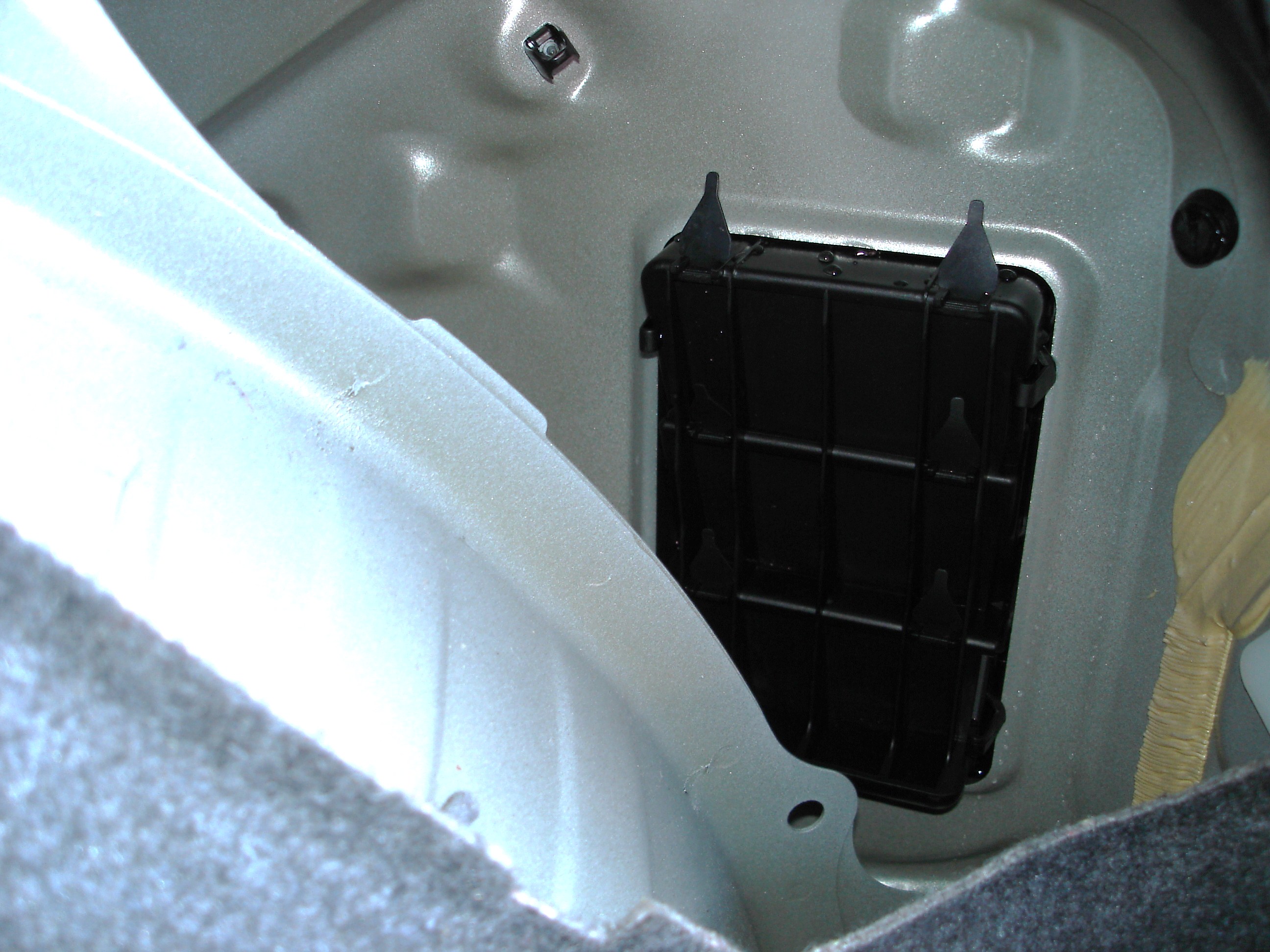

Go back to your dealer tell them the problem and ask have the vents in the boot been replaced This was subject to a recall that RRG didnt pick up and should be done free of charge I had the same problem with RRG :thumbsup:
Just checked mine this morning wet again all around the vent on the offside and carpet and boot lining :crybaby: going back into RRG on thurday for another go
The vents are in the jack compartment and go into the rear bumper void I am just wondering if I had mud flaps fitted the spray of the rear wheels wouldnt find its way up to the vents It would be interesting to know if anyone with mud flaps fitted have had this problem it is definitely spray coming in from somewhere

Stripped the boot out today the vents wet but there is water droplets above the vent and its clean water if it was the vent I would of thought it would be dirty water of the roads. so I unbolted the light but could not get my very large fingers onto the connector loom for the rear lights, then it started to rain in Bristol so I had to put it all back. I am guessing the water coming in behind the lights, will do a trip to B & Q tomorrow for some sealant and try again.

Mine was exactly the same water coming in through the rear light but when I went out on wet roads the water was all around the vent it can only be spray coming off the road see photo so it has been sealed around rim on the outside but you need to take the bumper off to do that

Forgive my ignorance but where exactly is this "vent" in the boot that people are talking about? :unsure:
Bruce, take the panel out where the jack is and look down.

The vents arent the issue Platinum told me it was the seal around them
Cheers, found it & it's dry. I wonder if this only effects particular models/5D or 3D/year etc?
