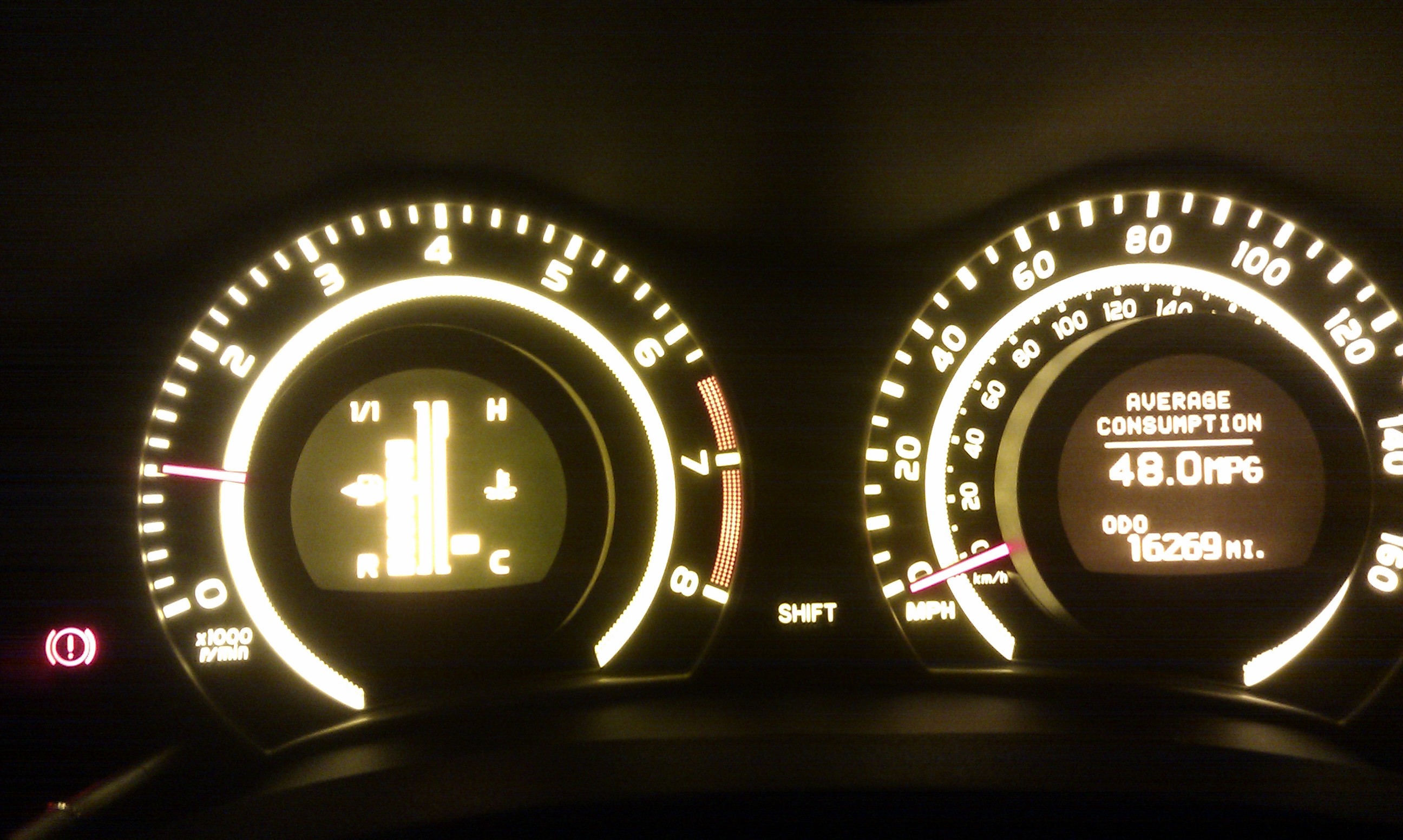

right guys here an update after getting ecu reset,i will let pic tell all,p.s.same journey as before.

As an electronics engineer I know how many issues a "hard reset" can fix on any electronic gear... however... if the ECU adapts to driving style, why has it not adapted to yours ? Also if the car were using more more fuel than it should in a "straight line" then what is the "closed loop" engine management system making of all that. To overfuel an engine by that amount would perhaps give other symptoms... that energy has to go somewhere... and if it's as unburnt fuel or a poorly combusted mix then the cat etc would be suffering which in turn would/should show on an emissions test. Maybe warning lights too.
I think the only true test is a before and after average done over many miles and several tank fulls, not just what the readout says on the dash.
I have noted and posted on here that my 1.33 "appears" to give significantly better mpg on the dash readout at a given speed after taking the engine up to the red line for a few seconds (This is particularly noticeable after a lot of "carefull" driving).
Whether the actual mpg is better or just the readout recalibrates I can't say.
