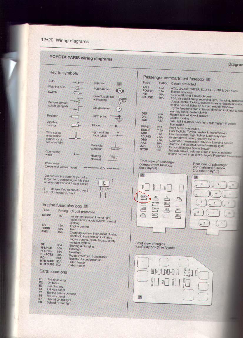

Try passenger compartment fusebox...10 amp fuse.. Labelled Gauge..see attached diagram - circled..in red..(Haynes)
post-22688-0-70805500-1297486794_thumb.j
thank you very much for this advice , i have removed this fuse and on inspection i found it to be blown , i have not tried another fuse yet as Halfords is shut and i dont want to pull another 10amp fuse from another slot to try as it is a small compartment and i have chubby hands, so thank you very much
