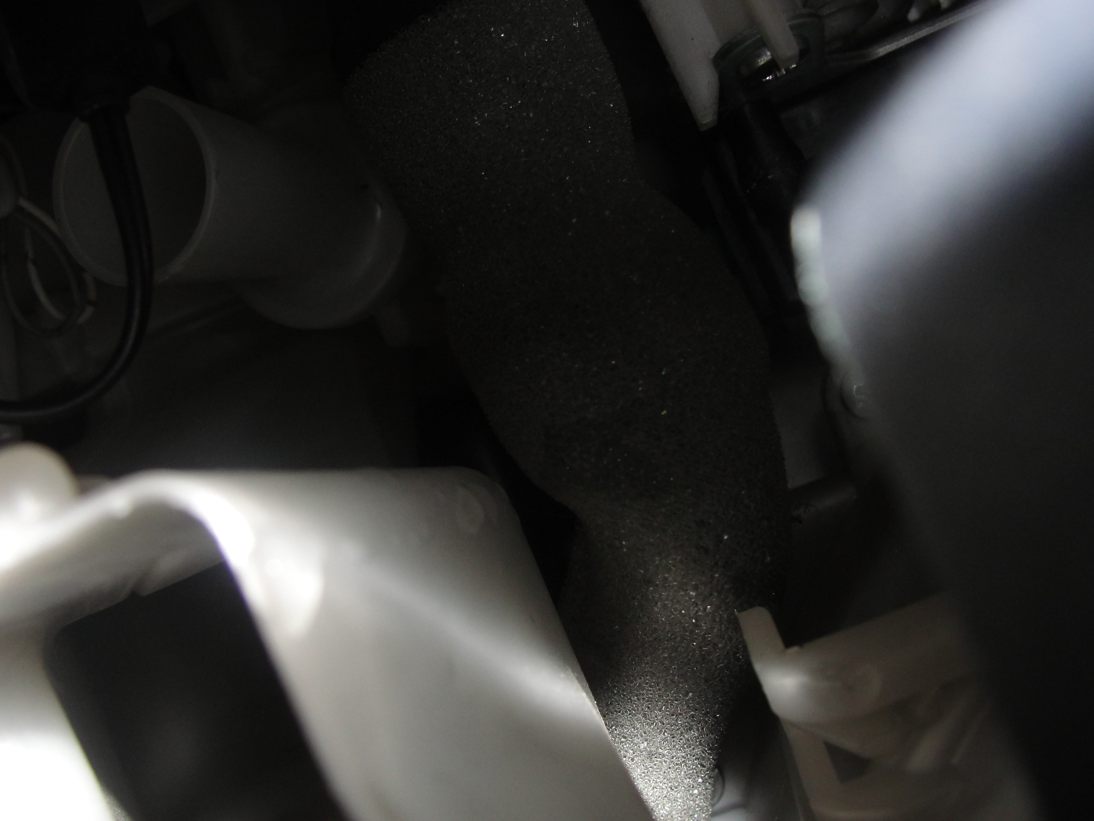

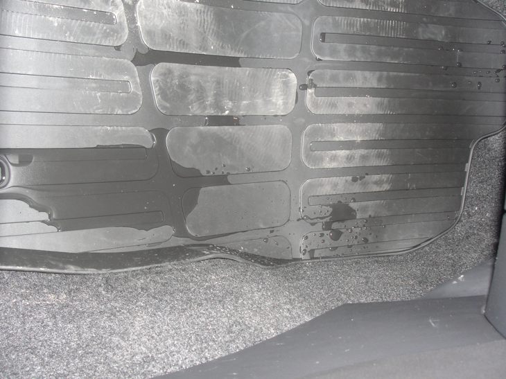

Hi all,
I'm after some help! I went out to my car this morning and noticed a pool of water on the passenger side mat. Now ive only had the car 2weeks and this is the 3rd time ive noticed this... previous times i assumed it must be wet from the wife's feet.... :!Removed!:
So as you can see it is dripping down onto the outside of the white plastic (assume this is heater air outlet) The foam wrap around the cables above it is also wet...
I'm assuming this is rain water getting in from some in the bulkhead between the engine compartment & the windscreen...
Any advice / help / cures greatly appreciated!!!
Many thanks
Tom

Hi Tom.
Welcome to the club.
I had a similar issue. Unfortunately, this is a design flaw with early 4.3 RAVs. There is a TSB (Toyota Service Bulletin) to address this issue, which replaces the "Cowl panel seal" with a better one, resulting in no more water ingress. :)
I don't have any asily accessible online storage space, so PM me if you wish me to send you the TSB.
Cheers.

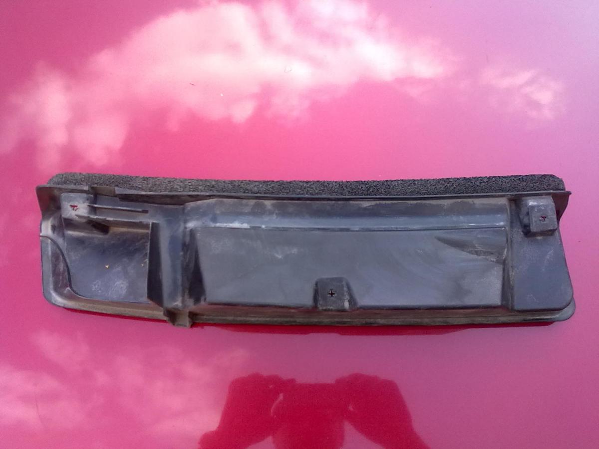

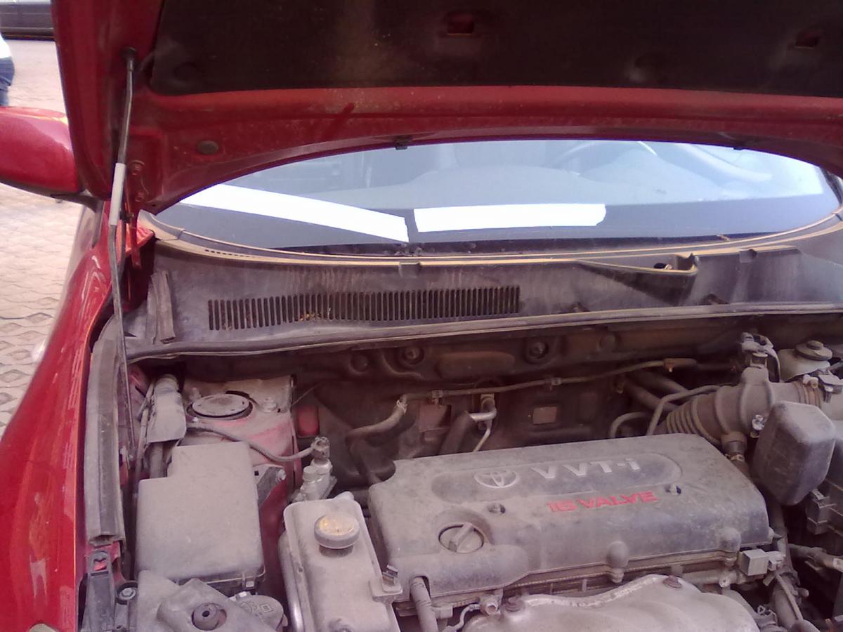

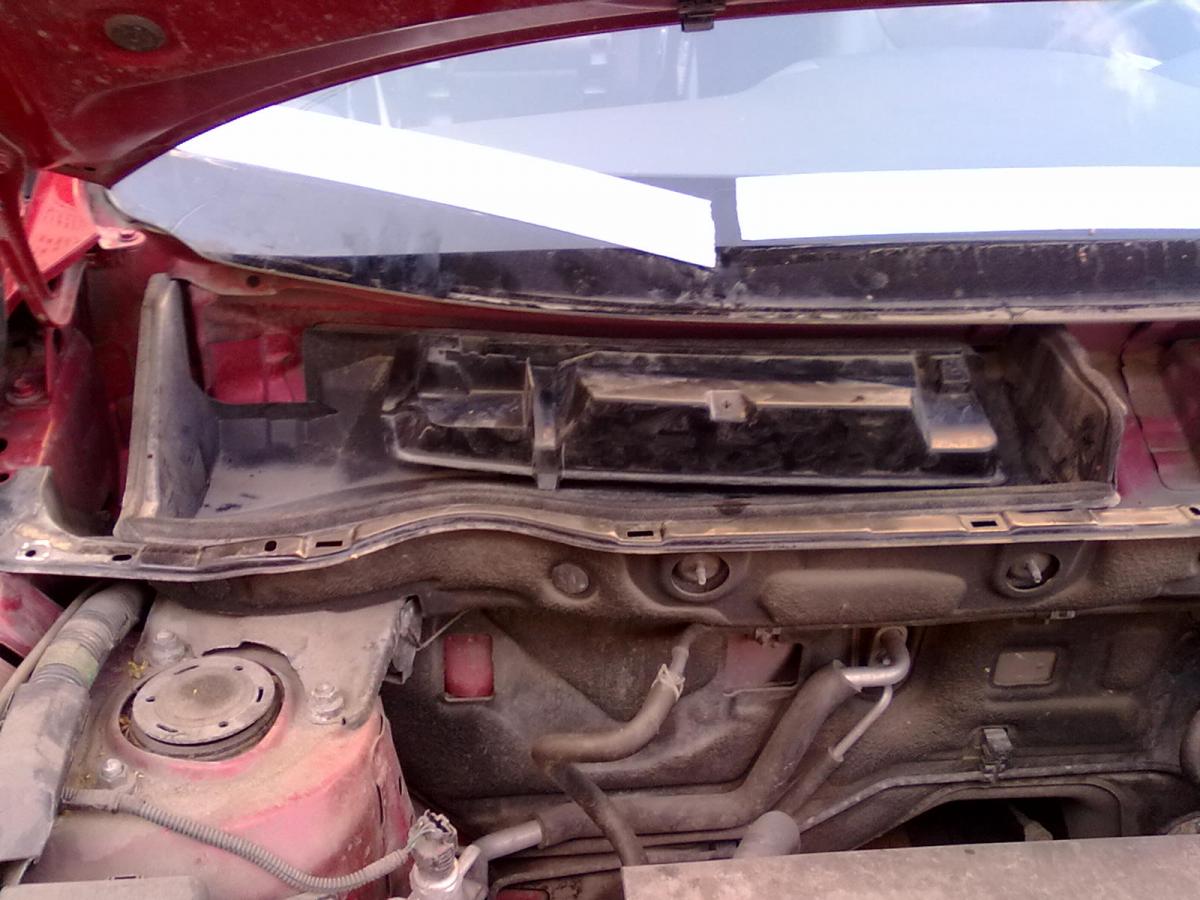

Yesterday, thanks to good weather, I was able to disassemble the louver and made some pictures to illustrate the problem:
1) Louver is in its place, I've marked the wipers position using white painting tape.
post-132699-0-53098600-1372929257_thumb.

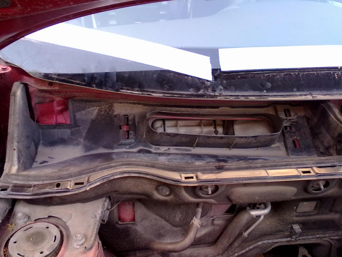

2) Louver is unmounted, you can see plastic cap that covering air inlet.
post-132699-0-62729800-1372929339_thumb.
3) Air inlet uncovered, there are no any clips which hold plastic cap in position, it is just dangling there.
post-132699-0-58172200-1372929401_thumb.

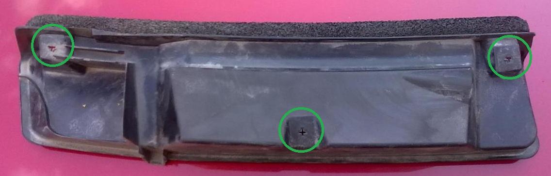

4) The cap itself front.
post-132699-0-76969400-1372929463_thumb.

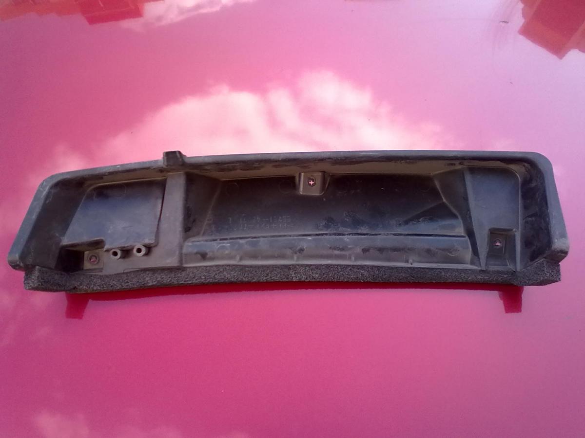

5) And reverse.
post-132699-0-57452300-1372929465_thumb.
As you can see there are 3 holes in the cap which probably intended for screws or something like it, but I didn't find those screws.
The plastic cap should be attached to the louvre - it's plastic spot welded in a few places - but not very well! If you look carefully at the underside of the louvre, you should be able to see where the cap was attached. Re-attach with silicon adhesive or small nuts and bolts etc. The upgrade described in theTSB is simply a strip of foam which is stuck on the metal panel just below the bottom of the windscreen (it's about £10). If there is already a thinner strip of foam already fitted - this should be removed first, as should the foam which is attached to the plastic cap.
And for goodness sake, once you have fixed the leak, get that engine bay jet washed :eek:
Finally I've done it!
Precise investigation of that plastic cap gave me 3 points where it was welded to the louvre. Here they are:
post-132699-0-63485100-1373273572_thumb.
Next I use epoxy glue to reattach plastic cap in place to the louvre.
When I re-install louvre back and do the test - simulate heavy rain on car from water hose. And it works! No single water droplet on my carpet!
I'm appreciated for your help guys, you didn't let my car converts to the aquarium.
PS: And yes, I've washed the engine up :)
