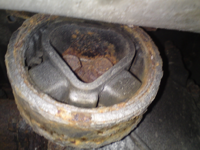

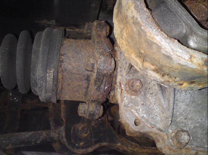

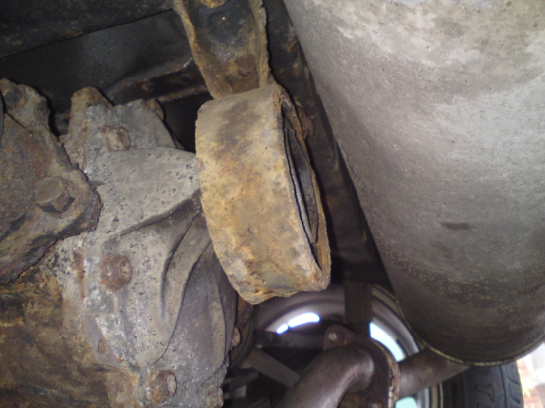

I have attached 3 photos of this bearing / bush assembly, just to be sure we are talking about the same thing.
If so, exactly where do I put the sikkaflex. I have used this before in sealing a boat panel, so rather imagined it will go off too hard rather than be flexible.
