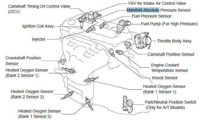

Need your help have Avensis 2003 vvti engine and engine management light is on the fault code is p0037 I am advised I need to replace the oxygen sensor, Bank 1 sensor 2 but I cannot work out which sensor this is.
Please can anyone help me to identify which sensor I need to replace Pictures would help

Hi,
If your engine resembles the one in the attachment, they are all there.
It's a 1AZ-FSE engine.
