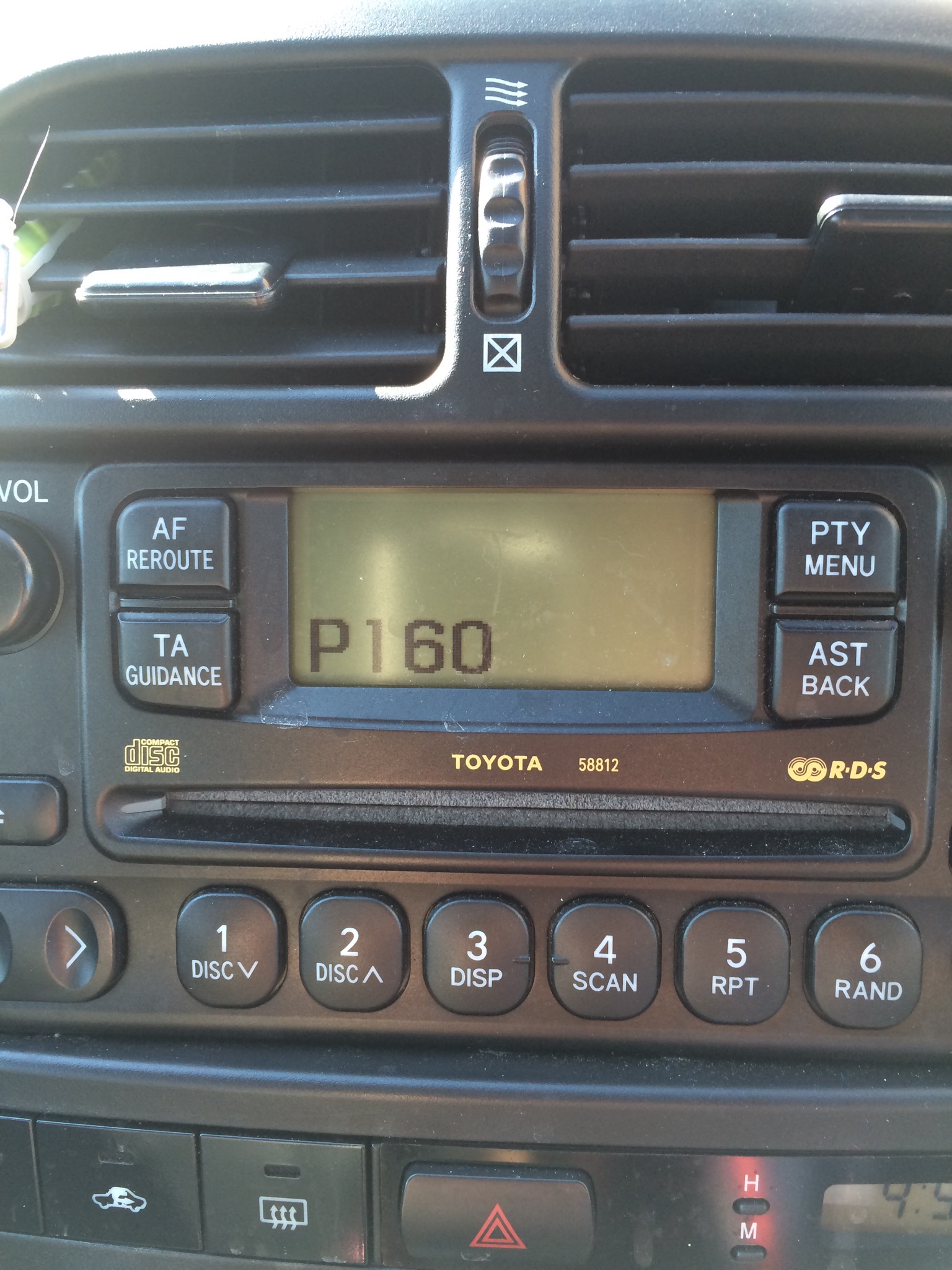

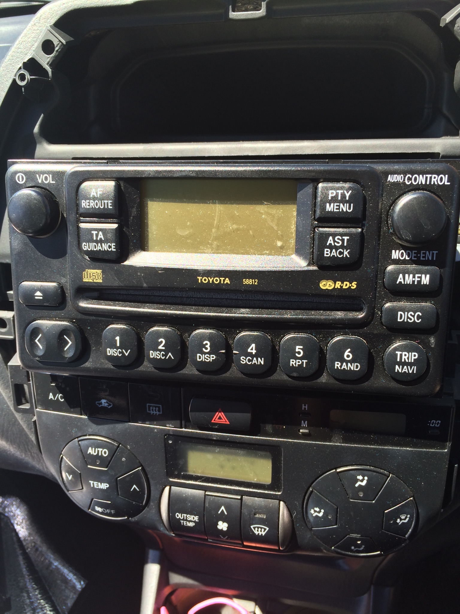

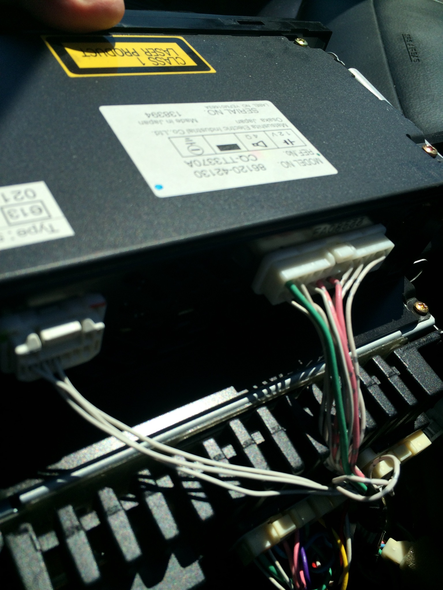

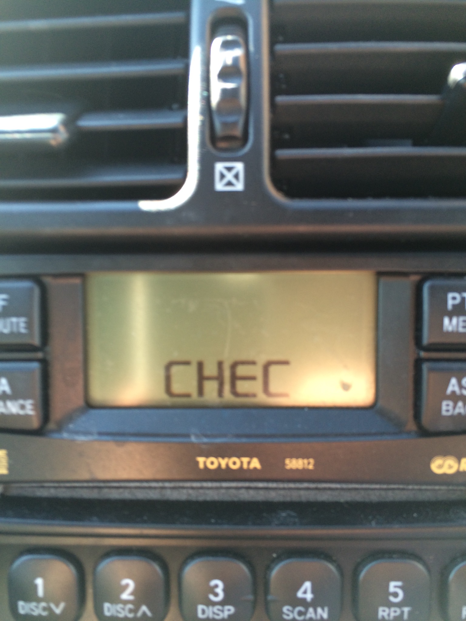

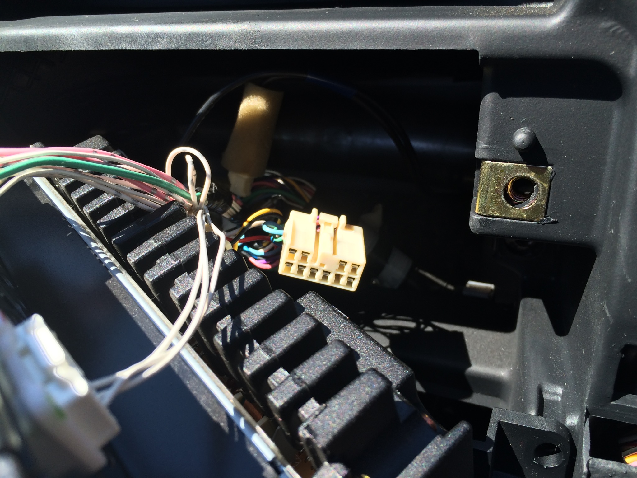

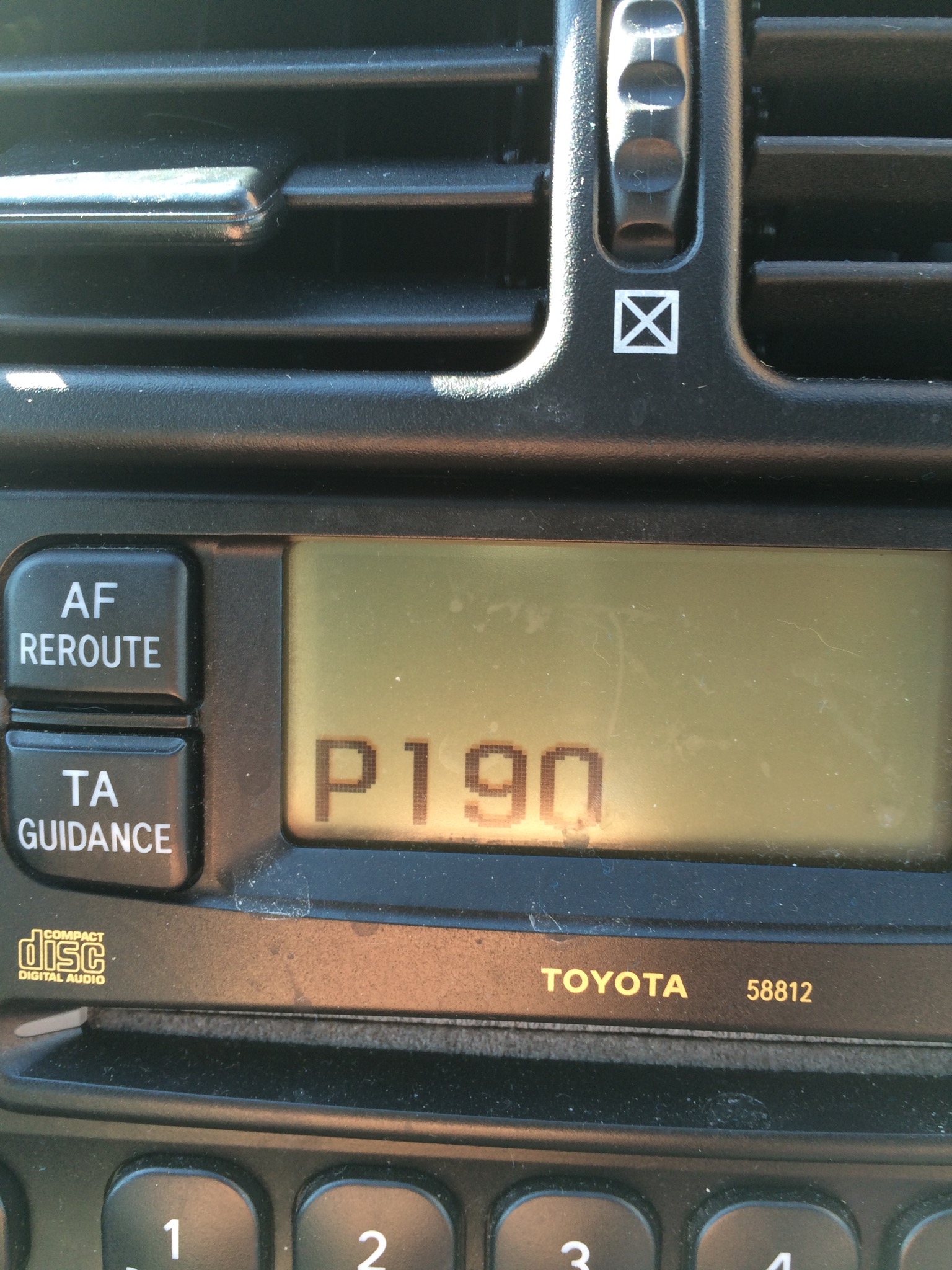

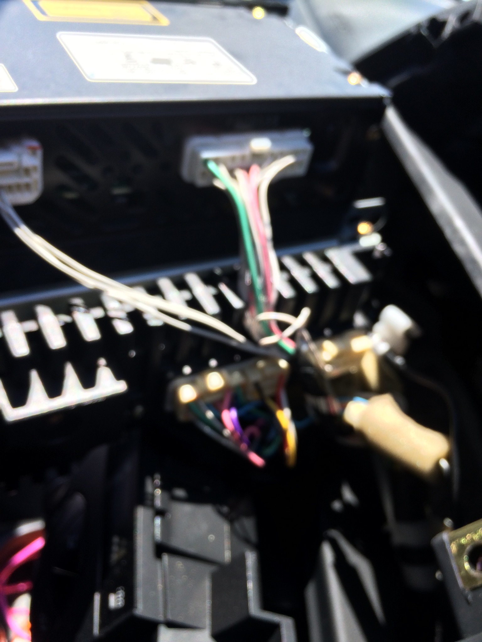

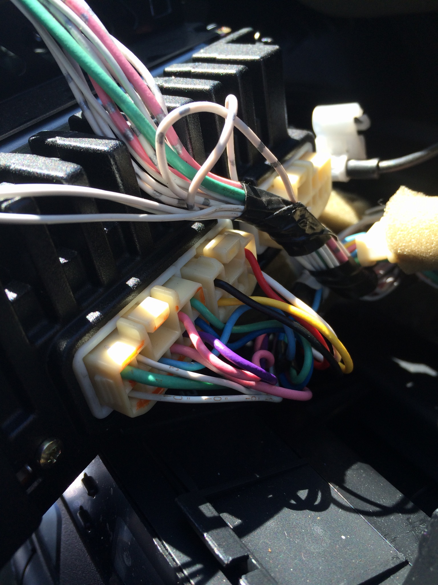

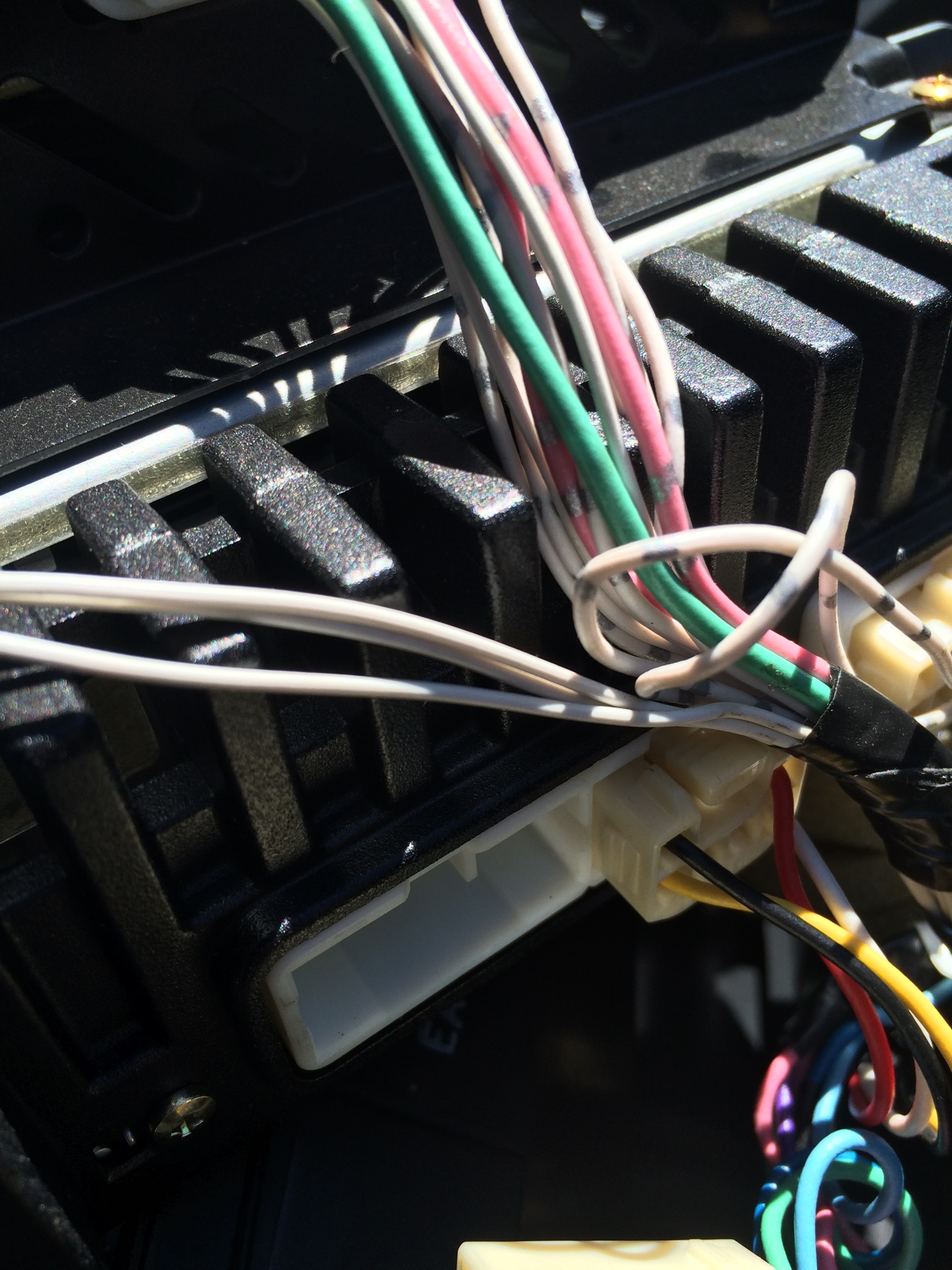

Hi. I need your help with a problem with my radio. Like earlier posts, my radio fades after 20mins or so. I've followed Big Kevs instructions about fault codes and I get P160 & P190. Does anyone know what this means? I am also trying to fit an Xcarlink iPhone adaptor but there's no spare cd input on the rear of the 58812 head unit. Any suggestion re the iPhone adaptor &/or the fading radio would be greatly appreciated.
many thanks
I have attached some photos of the unit in the hope that this will help.
Thanks again
