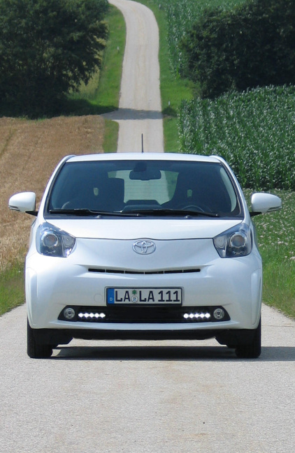

Here is my aftermarket solution.
post-78587-0-99943800-1302622432_thumb.j
If I remember the DRL,s LaLa used on his IQ are Philips. I fitted a set to my Dad,s Urbancruiser and they are easy to fit. The beauty of the Philips DRL,s is that they can be fitted to go out when you turn your side/headlights on.
They may not be the cheapest aftermart DRL,s but they certainly are the best and look the best as well!!!!
Regards Clare
Hi LA - LA could you confirm wether they are the philips DRL s? Also how did you find fitting them with the fog lights? I bought some ring DRLS and once the front bumper was off they was no way of fitting them with out a complicated bracket? Are the philips very slim? Amazingly compacted the mechanicals at the front of the iq. looks really well DRLS really suit the iq more so then most small cars on the road. Gives it a Merc excutive car kinda look but funkier!

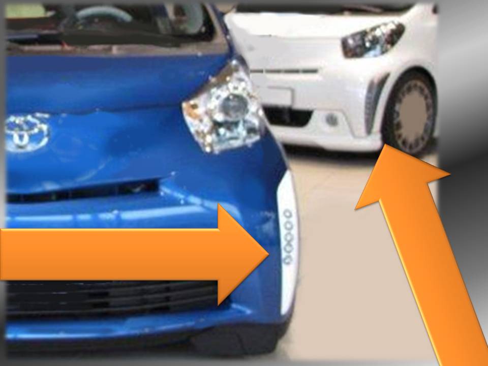

The official version??
post-78587-0-36931300-1302816031_thumb.j

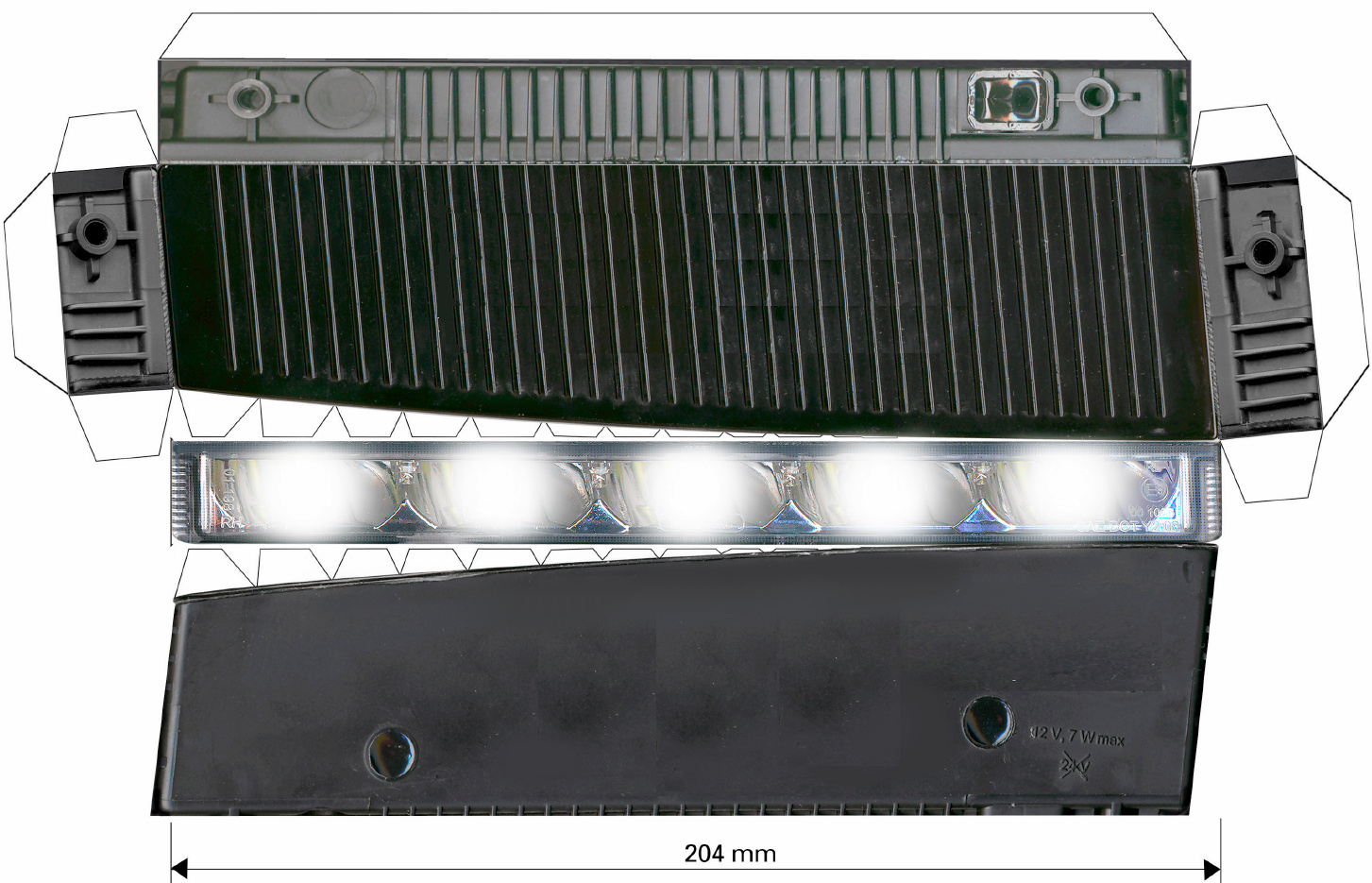

Kit PHILIPS :

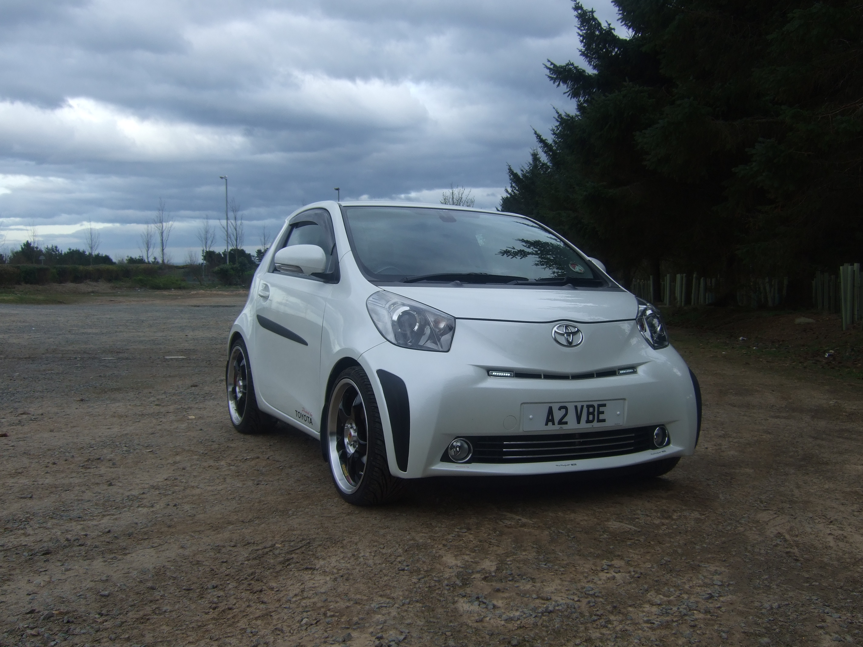

I put my lights in the holes
Mr Bean
post-98729-0-79452000-1302892175_thumb.j
And you respect the size between two light ?
Mr Bean
Is there any chance you could tell me where you got your running lights you put in the top grill please
David
Hi Mr Ben
Thanks for the reply. Had a look in Halfords a few days ago. The only ones they seemed to have were made by Ring. But Three versions were too long. The 8 led pne was 210mm long. Dont suppose you can remember the make by any chance.
Cheers
David
Hi Mr Ben
Thanks for the reply. Had a look in halfords a few days ago. The only ones they seemed to have were made by Ring. But Three versions were too long. The 8 led pne was 210mm long. Dont suppose you can remember the make by any chance.
Cheers
David
For what it's worth I use these which are a good push fit in the ends of the upper IQ intake without needing any other fixing, once you take the brackets that they come with, off.
So far they have been in for about 500 miles without moving or becoming loose so I will leave them as they are.
http://www.amazon.co.uk/Ring-Cruise-lite-Diamond-Daytime-Styling/dp/B0030L89FO
They are a bit cheap compared to some of the others, I suppose, so I don't know how long they will work for, but so far no problems and they look OK, AND I have noticed cars about to pull out of junctions having a "double take" on my approach when they would normally pull out after a quick look, so the lights do what they are supposed to.
And I didn't have to drill the car or mount brackets anywhere, which is a bonus.
Hi Johnan
Thanks very much for that. I have ordered a set. Thanks for the info and a good discription of your experience in fitting them
David
that ones are to thick
