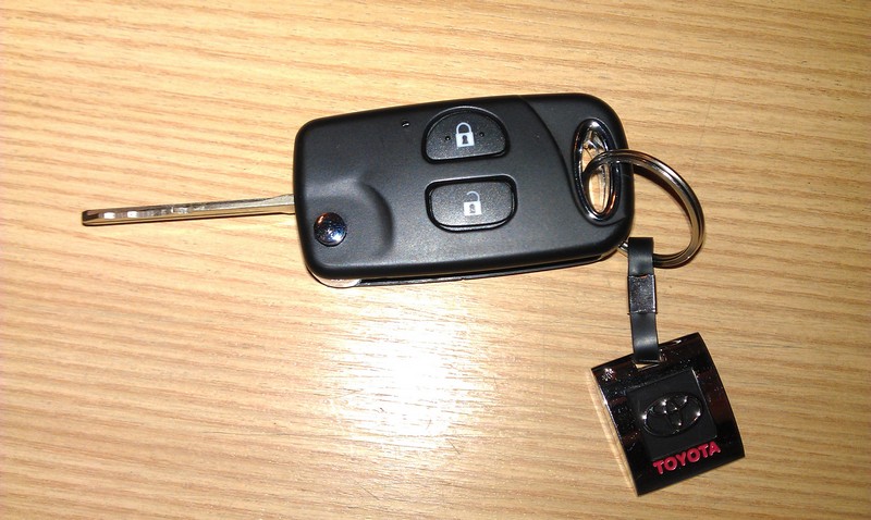

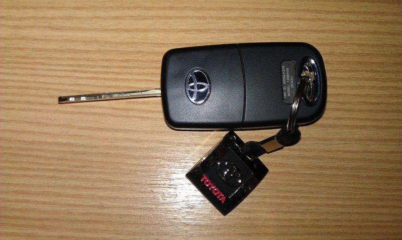

Finally got around to getting the blade cut; Works beautifully! :yahoo:
I couldn't find a transponder chip; It seems to be build into the remote module tho' as that's all I swapped over and the car still starts :D
It does stick out a bit more but not enough to get in the way like I'd feared.
All in all a good result :)
Gone are the days of me accidentally stabbing myself in the leg with my car keys! :lol:

Yeah, got a little Toyota sticker but haven't stuck it on yet because it covers one of the screw holes.
I got it cut by a local guy but because I was getting some other keys cut and a lock, and was supplying the blank blade, he did it for free :D
I think he charged me £1.60 each for the other keys tho'.

BTW, my locksmith did a template cut as he doesn't have the gear for 'cutting by the numbers' for Toyota keys, but that seemed to work despite my original key showing a bit of wear.
Just make sure they do a decent job de=-burring the edges after it's cut - My guy did a blinding job of de-burring the edges after he cut it tho'; Felt like an old well-used key! :D
Last time I had a car key cut for my old Fiesta by another place and I actually cut myself on a burr on the edge! :eek: I'm sure it wasn't good for the lock either and ended up filing it down myself with a needle file!

Build quality seems okay; Keep playing with the flip mechanism and have already dropped it a few times and it hasn't come apart yet :lol:
This is a Yaris flip key tho'.
TBH, I think if you check the picture and the button hole positions match your key you should be safe :)
It is quite bulky tho; Was comparing it to my friend's Audi flip key and it's significantly bigger! I suppose this is partly due to the ludicrous length of the key blade :lol:

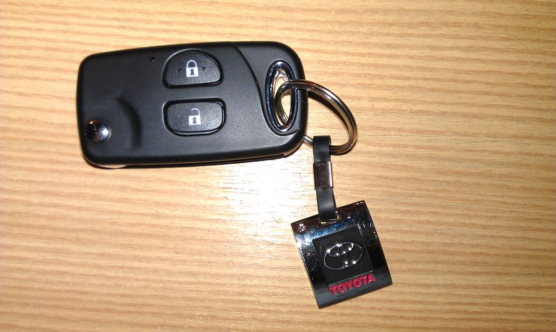

Anyway this is the key I bought but I also had to ask the seller if it would have been possible to replace the blade in the auction with a Valeo style blade I saw in another auction.
That was possible and so this is the result:

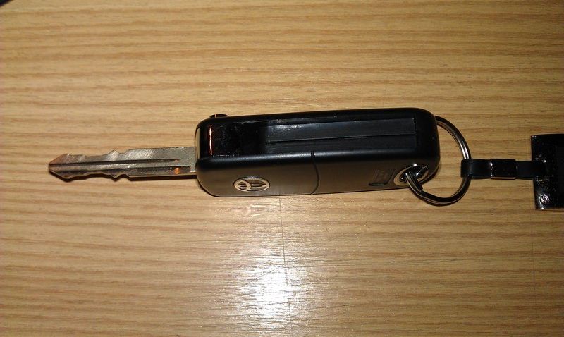

Today, finally I made my flip key... I never liked my valet key, so I decided to change it.
First time I bought a blank flip key from net, then I cut my key handle and I recovered the blade and the transponder . The flip key that I bought has a space inside for transponder, and the blade, with a little work I modified it to get in it's designed place of the flip key; and the result is this . When I have some spare time I have to make work the remote; is there a procedure where the central locking receptor is able to learn new remotes I'll describe it in another topic).
